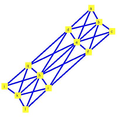

      <itunes:summary>&lt;p&gt;Go back to your question from one month ago, "&lt;a href="http://www.mapleprimes.com/questions/142492-How-Many-Routes-In-A-4x4-Square"&gt;how many routes in a 6x6 square?&lt;/a&gt;" Careully study the lengthy answers to that. I covered there many of the questions that are posed here, including&lt;/p&gt;
&lt;ol&gt;
&lt;li&gt;how to represent the vertices as pairs of integers&lt;/li&gt;
&lt;li&gt;how to label the vertices with convenient two-character letter-number combinations while maintaining the underlying integer-pair representation&lt;/li&gt;
&lt;li&gt;how to create the graph in &lt;strong&gt;GraphTheory&lt;/strong&gt; using the simple criterion that vertices &lt;em&gt;u&lt;/em&gt; and &lt;em&gt;v&lt;/em&gt; are adjacent iff &lt;strong&gt;LinearAlgebra:-Norm( &amp;lt; u - v &amp;gt; ) = 1&lt;/strong&gt;&lt;/li&gt;
&lt;li&gt;how to use &lt;strong&gt;GraphTheory:-Departures &lt;/strong&gt;to construct paths (words) in the graph&lt;/li&gt;
&lt;li&gt;how to plot the board and the paths (words).&lt;/li&gt;
&lt;/ol&gt;
&lt;p&gt;It would be much quicker to start with the above base, which is already coded in the post, than to work from the Mathematica. The project is already half done. It would be nice to know that my prior work on it was not for naught.&lt;/p&gt;

      <itunes:summary>&lt;p&gt;Okay, I'll relook at that.&amp;nbsp; In the meantime these are the letters that occur on each cube.&lt;/p&gt;
&lt;p&gt;Boggle letters per cube&lt;br&gt;&lt;br&gt;1&amp;nbsp; i,m,c,u,o,t&lt;br&gt;2&amp;nbsp; s,s,e,t,o,i&lt;br&gt;3&amp;nbsp; n,r,l,h,z,n&lt;br&gt;4&amp;nbsp; e,v,y,r,d,l&lt;br&gt;5&amp;nbsp; s,f,p,a,k,f&lt;br&gt;6&amp;nbsp; w,a,o,t,t,o&lt;br&gt;7&amp;nbsp; e,e,a,n,a,g&lt;br&gt;8&amp;nbsp; d,l,r,x,i,e&lt;br&gt;9&amp;nbsp; c,h,s,p,a,o&lt;br&gt;10&amp;nbsp; e,e,w,h,g,n&lt;br&gt;11&amp;nbsp; s,i,u,e,e,n&lt;br&gt;12&amp;nbsp; e,l,r,y,t,t&lt;br&gt;13&amp;nbsp; o,o,a,b,b,j&lt;br&gt;14&amp;nbsp; s,d,t,y,t,i&lt;br&gt;15&amp;nbsp; w,h,e,r,v,t&lt;br&gt;16&amp;nbsp; Qu,i,i,m,h,n&lt;/p&gt;
&lt;p&gt;As you can see, in the real game of boggle, certain words are impossible.&amp;nbsp; (I'm not sure if all games have the same letter dies - perhaps each boggle game is unique in that sense.)&amp;nbsp;&lt;/p&gt;
&lt;p&gt;** edit add** -&lt;/p&gt;
&lt;p&gt;Apparently there were two different letter distributions of Boggle. &amp;nbsp;&lt;br&gt;&lt;br&gt;New Version | Old Version&lt;br&gt;AAEEGN | AACIOT&lt;br&gt;ELRTTY | AHMORS&lt;br&gt;AOOTTW | EGKLUY&lt;br&gt;ABBJOO | ABILTY&lt;br&gt;EHRTVW | ACDEMP&lt;br&gt;CIMOTV | EGINTV&lt;br&gt;DISTTY | GILRUW&lt;br&gt;EIOSST | ELPSTU&lt;br&gt;DELRVY | DENOSW&lt;br&gt;ACHOPS | ACELRS&lt;br&gt;HIMNQU | ABJMOQ&lt;br&gt;EEINSU | EEFHIY&lt;br&gt;EEGHNW | EHINPS&lt;br&gt;AFFKPS | DKNOTU&lt;br&gt;HLNNRZ | ADENVZ&lt;br&gt;DEILRX | BIFORX&lt;/p&gt;</itunes:summary>
