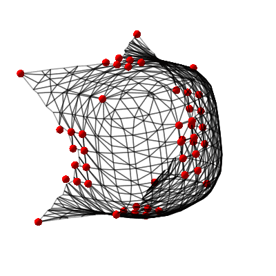

      <itunes:summary>&lt;p&gt;From the help page for implicitplot3d:&lt;/p&gt;
&lt;p&gt;"It uses an numerical algorithm based on triangulation into tetrahedrons combined with simple interpolation."&lt;/p&gt;
&lt;p&gt;I guess the plotting interface is doing the interpolation and the resulting points are not available. That may be the reason that isosurface structures are not handled by plottools:-getdata. &lt;/p&gt;</itunes:summary>

      <itunes:summary>&lt;p&gt;Try raising your cutoff value of 2.5e-2 to 0.3 or 0.4. Then you can really see the points from which it is interpolating the surface. You can see a collection of points on each side of the surface such that the surface lies neatly between them. It might also be instructive to vary the &lt;strong&gt;symbolsize&lt;/strong&gt; of your plotted points, with points closer to the surface plotted larger. This might give more of a clue as to how the algorithm works.&lt;/p&gt;</itunes:summary>
      <description>&lt;p&gt;Try raising your cutoff value of 2.5e-2 to 0.3 or 0.4. Then you can really see the points from which it is interpolating the surface. You can see a collection of points on each side of the surface such that the surface lies neatly between them. It might also be instructive to vary the &lt;strong&gt;symbolsize&lt;/strong&gt; of your plotted points, with points closer to the surface plotted larger. This might give more of a clue as to how the algorithm works.&lt;/p&gt;</description>
