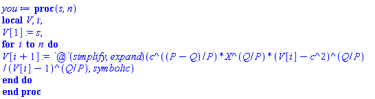

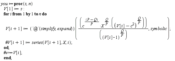

you := proc (s, n) V[1] := s; for i to n do V[i+1] := (`@`(simplify, expand))(c^((P-Q)/P)*X^(Q/P)*(-c^2+V[i])^(Q/P)/(V[i]-1)^(Q/P), symbolic) end do end proc
proc (s, n) local V, i; V[1] := s; for i to n do V[i+1] := (`@`(simplify, expand))(c^((P-Q)/P)*X^(Q/P)*(V[i]-c^2)^(Q/P)/(V[i]-1)^(Q/P), symbolic) end do end proc

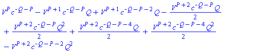

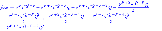

four := simplify(expand(V^P*three))
V^P*c^(-Q-P)-V^(P+1)*c^(-Q-P)*Q+V^(P+1)*c^(-Q-P-2)*Q-(1/2)*V^(P+2)*c^(-Q-P)*Q+(1/2)*V^(P+2)*c^(-Q-P)*Q^2+(1/2)*V^(P+2)*c^(-Q-P-4)*Q+(1/2)*V^(P+2)*c^(-Q-P-4)*Q^2-V^(P+2)*c^(-Q-P-2)*Q^2
