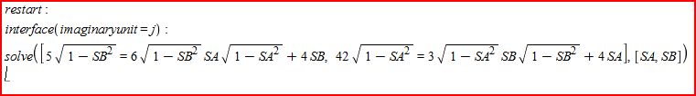

Question: Solve This Equation
February 14 2014 Ratch 211
Maple 16
Can anyone tell me how to solve the equation above using Maple.  I know that there is a solution around x=0.995, y=0.743, but I cannot induce Maple to find it.  Any help or suggestions would be appreciated.
