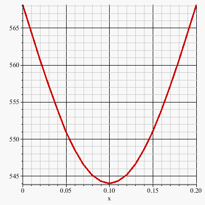

I need a temperature distribution inside a barrier during a heating process.
I will be appreciated for any help.
wz
How to animete BC using varying temperature in time?  How to obtain animated solution?
Diffusivity coefficent...
a := 0.1e-5:
Thickness of barrier...
L := .2:
Heating curve:
Time in heating curve (in hours form exmaple)...
Time := seq(i, i = 1 .. 10):
Varying temperature in time [K]....
Temp_in_Time := [433.15, 568.15, 703.15, 838.15, 973.15, 1108.15, 1243.15, 1378.15, 1513.15, 1616.15]:
Initial temperature [K]
Tot := 298:
PDE := diff(T(x, t), t) = a*(diff(T(x, t), x, x)):
BC1 := {T(0, t) = Temp_in_Time[2], T(L, t) = Temp_in_Time[2], T(x, 0) = Tot}:
sol := pdsolve(PDE, BC1, numeric, timestep = 50):
sol:-plot(t = 3*3600, thickness = 3, colour = red);
