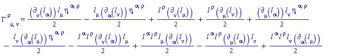

We first define the Christoffel symbol in terms of the metric,   `g__μ,ν`.
Christoffel[`~rho`, mu, nu] = convert(Christoffel[`~rho`, mu, nu], g_)
Physics:-Christoffel[`~rho`, mu, nu] = (1/2)*Physics:-g_[`~alpha`, `~rho`]*(Physics:-d_[nu](Physics:-g_[alpha, mu], [X])+Physics:-d_[mu](Physics:-g_[alpha, nu], [X])-Physics:-d_[alpha](Physics:-g_[mu, nu], [X]))
SubstituteTensor(g_[mu, nu] = eta[mu, nu]+Physics:-`*`(l[mu](X), l[nu](X)), Physics:-Christoffel[`~rho`, mu, nu] = (1/2)*Physics:-g_[`~alpha`, `~rho`]*(Physics:-d_[nu](Physics:-g_[alpha, mu], [X])+Physics:-d_[mu](Physics:-g_[alpha, nu], [X])-Physics:-d_[alpha](Physics:-g_[mu, nu], [X])), evaluateexpression)
Physics:-Christoffel[`~rho`, mu, nu] = (1/2)*(eta[`~alpha`, `~rho`]+l[`~alpha`](X)*l[`~rho`](X))*(Physics:-d_[nu](l[alpha](X), [X])*l[mu](X)+l[alpha](X)*Physics:-d_[nu](l[mu](X), [X])+Physics:-d_[mu](l[alpha](X), [X])*l[nu](X)+l[alpha](X)*Physics:-d_[mu](l[nu](X), [X])-Physics:-d_[alpha](l[mu](X), [X])*l[nu](X)-l[mu](X)*Physics:-d_[alpha](l[nu](X), [X]))
Simplify(SubstituteTensor(Physics:-`*`(l[`~alpha`](X), l[`~rho`](X)) = -Physics:-`*`(l[`~alpha`](X), l[`~rho`](X)), Physics:-Christoffel[`~rho`, mu, nu] = (1/2)*(eta[`~alpha`, `~rho`]+l[`~alpha`](X)*l[`~rho`](X))*(Physics:-d_[nu](l[alpha](X), [X])*l[mu](X)+l[alpha](X)*Physics:-d_[nu](l[mu](X), [X])+Physics:-d_[mu](l[alpha](X), [X])*l[nu](X)+l[alpha](X)*Physics:-d_[mu](l[nu](X), [X])-Physics:-d_[alpha](l[mu](X), [X])*l[nu](X)-l[mu](X)*Physics:-d_[alpha](l[nu](X), [X])), evaluateexpression))

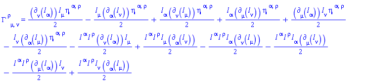

Physics:-Christoffel[`~rho`, mu, nu] = (1/2)*Physics:-d_[nu](l[alpha](X), [X])*l[mu](X)*eta[`~alpha`, `~rho`]-(1/2)*l[mu](X)*Physics:-d_[alpha](l[nu](X), [X])*eta[`~alpha`, `~rho`]+(1/2)*l[alpha](X)*Physics:-d_[nu](l[mu](X), [X])*eta[`~alpha`, `~rho`]+(1/2)*l[alpha](X)*Physics:-d_[mu](l[nu](X), [X])*eta[`~alpha`, `~rho`]+(1/2)*Physics:-d_[mu](l[alpha](X), [X])*l[nu](X)*eta[`~alpha`, `~rho`]-(1/2)*l[nu](X)*Physics:-d_[alpha](l[mu](X), [X])*eta[`~alpha`, `~rho`]-(1/2)*l[`~alpha`](X)*l[`~rho`](X)*Physics:-d_[nu](l[alpha](X), [X])*l[mu](X)+(1/2)*l[`~alpha`](X)*l[`~rho`](X)*l[mu](X)*Physics:-d_[alpha](l[nu](X), [X])-(1/2)*l[`~alpha`](X)*l[`~rho`](X)*l[alpha](X)*Physics:-d_[nu](l[mu](X), [X])-(1/2)*l[`~alpha`](X)*l[`~rho`](X)*l[alpha](X)*Physics:-d_[mu](l[nu](X), [X])-(1/2)*l[`~alpha`](X)*l[`~rho`](X)*Physics:-d_[mu](l[alpha](X), [X])*l[nu](X)+(1/2)*l[`~alpha`](X)*l[`~rho`](X)*l[nu](X)*Physics:-d_[alpha](l[mu](X), [X])
SubstituteTensor(Physics:-`*`(l[alpha](X), eta[`~alpha`, `~rho`]) = l[`~rho`](X), Physics:-Christoffel[`~rho`, mu, nu] = (1/2)*Physics:-d_[nu](l[alpha](X), [X])*l[mu](X)*eta[`~alpha`, `~rho`]-(1/2)*l[mu](X)*Physics:-d_[alpha](l[nu](X), [X])*eta[`~alpha`, `~rho`]+(1/2)*l[alpha](X)*Physics:-d_[nu](l[mu](X), [X])*eta[`~alpha`, `~rho`]+(1/2)*l[alpha](X)*Physics:-d_[mu](l[nu](X), [X])*eta[`~alpha`, `~rho`]+(1/2)*Physics:-d_[mu](l[alpha](X), [X])*l[nu](X)*eta[`~alpha`, `~rho`]-(1/2)*l[nu](X)*Physics:-d_[alpha](l[mu](X), [X])*eta[`~alpha`, `~rho`]-(1/2)*l[`~alpha`](X)*l[`~rho`](X)*Physics:-d_[nu](l[alpha](X), [X])*l[mu](X)+(1/2)*l[`~alpha`](X)*l[`~rho`](X)*l[mu](X)*Physics:-d_[alpha](l[nu](X), [X])-(1/2)*l[`~alpha`](X)*l[`~rho`](X)*l[alpha](X)*Physics:-d_[nu](l[mu](X), [X])-(1/2)*l[`~alpha`](X)*l[`~rho`](X)*l[alpha](X)*Physics:-d_[mu](l[nu](X), [X])-(1/2)*l[`~alpha`](X)*l[`~rho`](X)*Physics:-d_[mu](l[alpha](X), [X])*l[nu](X)+(1/2)*l[`~alpha`](X)*l[`~rho`](X)*l[nu](X)*Physics:-d_[alpha](l[mu](X), [X]))
Physics:-Christoffel[`~rho`, mu, nu] = (1/2)*Physics:-d_[nu](l[alpha](X), [X])*l[mu](X)*eta[`~alpha`, `~rho`]-(1/2)*l[mu](X)*Physics:-d_[alpha](l[nu](X), [X])*eta[`~alpha`, `~rho`]+(1/2)*l[`~rho`](X)*Physics:-d_[nu](l[mu](X), [X])+(1/2)*l[`~rho`](X)*Physics:-d_[mu](l[nu](X), [X])+(1/2)*Physics:-d_[mu](l[alpha](X), [X])*l[nu](X)*eta[`~alpha`, `~rho`]-(1/2)*l[nu](X)*Physics:-d_[alpha](l[mu](X), [X])*eta[`~alpha`, `~rho`]-(1/2)*l[`~alpha`](X)*l[`~rho`](X)*Physics:-d_[nu](l[alpha](X), [X])*l[mu](X)+(1/2)*l[`~alpha`](X)*l[`~rho`](X)*l[mu](X)*Physics:-d_[alpha](l[nu](X), [X])-(1/2)*l[`~alpha`](X)*l[`~rho`](X)*l[alpha](X)*Physics:-d_[nu](l[mu](X), [X])-(1/2)*l[`~alpha`](X)*l[`~rho`](X)*l[alpha](X)*Physics:-d_[mu](l[nu](X), [X])-(1/2)*l[`~alpha`](X)*l[`~rho`](X)*Physics:-d_[mu](l[alpha](X), [X])*l[nu](X)+(1/2)*l[`~alpha`](X)*l[`~rho`](X)*l[nu](X)*Physics:-d_[alpha](l[mu](X), [X])
SubstituteTensor(Physics:-`*`(l[`~alpha`](X), l[alpha](X)) = 0, Physics:-Christoffel[`~rho`, mu, nu] = (1/2)*Physics:-d_[nu](l[alpha](X), [X])*l[mu](X)*eta[`~alpha`, `~rho`]-(1/2)*l[mu](X)*Physics:-d_[alpha](l[nu](X), [X])*eta[`~alpha`, `~rho`]+(1/2)*l[`~rho`](X)*Physics:-d_[nu](l[mu](X), [X])+(1/2)*l[`~rho`](X)*Physics:-d_[mu](l[nu](X), [X])+(1/2)*Physics:-d_[mu](l[alpha](X), [X])*l[nu](X)*eta[`~alpha`, `~rho`]-(1/2)*l[nu](X)*Physics:-d_[alpha](l[mu](X), [X])*eta[`~alpha`, `~rho`]-(1/2)*l[`~alpha`](X)*l[`~rho`](X)*Physics:-d_[nu](l[alpha](X), [X])*l[mu](X)+(1/2)*l[`~alpha`](X)*l[`~rho`](X)*l[mu](X)*Physics:-d_[alpha](l[nu](X), [X])-(1/2)*l[`~alpha`](X)*l[`~rho`](X)*l[alpha](X)*Physics:-d_[nu](l[mu](X), [X])-(1/2)*l[`~alpha`](X)*l[`~rho`](X)*l[alpha](X)*Physics:-d_[mu](l[nu](X), [X])-(1/2)*l[`~alpha`](X)*l[`~rho`](X)*Physics:-d_[mu](l[alpha](X), [X])*l[nu](X)+(1/2)*l[`~alpha`](X)*l[`~rho`](X)*l[nu](X)*Physics:-d_[alpha](l[mu](X), [X]))
Physics:-Christoffel[`~rho`, mu, nu] = (1/2)*Physics:-d_[nu](l[alpha](X), [X])*l[mu](X)*eta[`~alpha`, `~rho`]-(1/2)*l[mu](X)*Physics:-d_[alpha](l[nu](X), [X])*eta[`~alpha`, `~rho`]+(1/2)*l[`~rho`](X)*Physics:-d_[nu](l[mu](X), [X])+(1/2)*l[`~rho`](X)*Physics:-d_[mu](l[nu](X), [X])+(1/2)*Physics:-d_[mu](l[alpha](X), [X])*l[nu](X)*eta[`~alpha`, `~rho`]-(1/2)*l[nu](X)*Physics:-d_[alpha](l[mu](X), [X])*eta[`~alpha`, `~rho`]-(1/2)*l[`~alpha`](X)*l[`~rho`](X)*Physics:-d_[nu](l[alpha](X), [X])*l[mu](X)+(1/2)*l[`~alpha`](X)*l[`~rho`](X)*l[mu](X)*Physics:-d_[alpha](l[nu](X), [X])-(1/2)*l[`~alpha`](X)*l[`~rho`](X)*Physics:-d_[mu](l[alpha](X), [X])*l[nu](X)+(1/2)*l[`~alpha`](X)*l[`~rho`](X)*l[nu](X)*Physics:-d_[alpha](l[mu](X), [X])

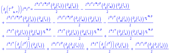

  Do the first term
expand(Physics:-`*`(Physics:-`*`(d_[rho](Physics:-Christoffel[`~rho`, mu, nu] = (1/2)*Physics:-d_[nu](l[alpha](X), [X])*l[mu](X)*eta[`~alpha`, `~rho`]-(1/2)*l[mu](X)*Physics:-d_[alpha](l[nu](X), [X])*eta[`~alpha`, `~rho`]+(1/2)*l[`~rho`](X)*Physics:-d_[nu](l[mu](X), [X])+(1/2)*l[`~rho`](X)*Physics:-d_[mu](l[nu](X), [X])+(1/2)*Physics:-d_[mu](l[alpha](X), [X])*l[nu](X)*eta[`~alpha`, `~rho`]-(1/2)*l[nu](X)*Physics:-d_[alpha](l[mu](X), [X])*eta[`~alpha`, `~rho`]-(1/2)*l[`~alpha`](X)*l[`~rho`](X)*Physics:-d_[nu](l[alpha](X), [X])*l[mu](X)+(1/2)*l[`~alpha`](X)*l[`~rho`](X)*l[mu](X)*Physics:-d_[alpha](l[nu](X), [X])-(1/2)*l[`~alpha`](X)*l[`~rho`](X)*Physics:-d_[mu](l[alpha](X), [X])*l[nu](X)+(1/2)*l[`~alpha`](X)*l[`~rho`](X)*l[nu](X)*Physics:-d_[alpha](l[mu](X), [X])), l[`~mu`](X)), l[`~nu`](X)))
Physics:-d_[rho](Physics:-Christoffel[`~rho`, mu, nu], [X])*l[`~mu`](X)*l[`~nu`](X) = (1/2)*l[`~mu`](X)*l[`~nu`](X)*Physics:-d_[rho](l[`~rho`](X), [X])*Physics:-d_[mu](l[nu](X), [X])+(1/2)*l[`~mu`](X)*l[`~nu`](X)*l[`~rho`](X)*Physics:-d_[rho](Physics:-d_[mu](l[nu](X), [X]), [X])+(1/2)*l[`~mu`](X)*l[`~nu`](X)*Physics:-d_[rho](l[`~rho`](X), [X])*Physics:-d_[nu](l[mu](X), [X])+(1/2)*l[`~mu`](X)*l[`~nu`](X)*l[`~rho`](X)*Physics:-d_[rho](Physics:-d_[nu](l[mu](X), [X]), [X])+(1/2)*l[`~mu`](X)*l[`~nu`](X)*Physics:-d_[rho](l[`~alpha`](X), [X])*l[`~rho`](X)*l[nu](X)*Physics:-d_[alpha](l[mu](X), [X])+(1/2)*l[`~mu`](X)*l[`~nu`](X)*l[`~alpha`](X)*Physics:-d_[rho](l[`~rho`](X), [X])*l[nu](X)*Physics:-d_[alpha](l[mu](X), [X])+(1/2)*l[`~mu`](X)*l[`~nu`](X)*l[`~alpha`](X)*l[`~rho`](X)*Physics:-d_[rho](l[nu](X), [X])*Physics:-d_[alpha](l[mu](X), [X])+(1/2)*l[`~mu`](X)*l[`~nu`](X)*l[`~alpha`](X)*l[`~rho`](X)*l[nu](X)*Physics:-d_[rho](Physics:-d_[alpha](l[mu](X), [X]), [X])-(1/2)*l[`~mu`](X)*l[`~nu`](X)*Physics:-d_[rho](l[`~alpha`](X), [X])*l[`~rho`](X)*Physics:-d_[mu](l[alpha](X), [X])*l[nu](X)-(1/2)*l[`~mu`](X)*l[`~nu`](X)*l[`~alpha`](X)*Physics:-d_[rho](l[`~rho`](X), [X])*Physics:-d_[mu](l[alpha](X), [X])*l[nu](X)-(1/2)*l[`~mu`](X)*l[`~nu`](X)*l[`~alpha`](X)*l[`~rho`](X)*Physics:-d_[rho](Physics:-d_[mu](l[alpha](X), [X]), [X])*l[nu](X)-(1/2)*l[`~mu`](X)*l[`~nu`](X)*l[`~alpha`](X)*l[`~rho`](X)*Physics:-d_[mu](l[alpha](X), [X])*Physics:-d_[rho](l[nu](X), [X])+(1/2)*l[`~mu`](X)*l[`~nu`](X)*Physics:-d_[rho](l[`~alpha`](X), [X])*l[`~rho`](X)*l[mu](X)*Physics:-d_[alpha](l[nu](X), [X])+(1/2)*l[`~mu`](X)*l[`~nu`](X)*l[`~alpha`](X)*Physics:-d_[rho](l[`~rho`](X), [X])*l[mu](X)*Physics:-d_[alpha](l[nu](X), [X])+(1/2)*l[`~mu`](X)*l[`~nu`](X)*l[`~alpha`](X)*l[`~rho`](X)*Physics:-d_[rho](l[mu](X), [X])*Physics:-d_[alpha](l[nu](X), [X])+(1/2)*l[`~mu`](X)*l[`~nu`](X)*l[`~alpha`](X)*l[`~rho`](X)*l[mu](X)*Physics:-d_[rho](Physics:-d_[alpha](l[nu](X), [X]), [X])-(1/2)*l[`~mu`](X)*l[`~nu`](X)*Physics:-d_[rho](l[`~alpha`](X), [X])*l[`~rho`](X)*Physics:-d_[nu](l[alpha](X), [X])*l[mu](X)-(1/2)*l[`~mu`](X)*l[`~nu`](X)*l[`~alpha`](X)*Physics:-d_[rho](l[`~rho`](X), [X])*Physics:-d_[nu](l[alpha](X), [X])*l[mu](X)-(1/2)*l[`~mu`](X)*l[`~nu`](X)*l[`~alpha`](X)*l[`~rho`](X)*Physics:-d_[rho](Physics:-d_[nu](l[alpha](X), [X]), [X])*l[mu](X)-(1/2)*l[`~mu`](X)*l[`~nu`](X)*l[`~alpha`](X)*l[`~rho`](X)*Physics:-d_[nu](l[alpha](X), [X])*Physics:-d_[rho](l[mu](X), [X])-(1/2)*l[`~mu`](X)*l[`~nu`](X)*Physics:-d_[rho](Physics:-d_[alpha](l[mu](X), [X]), [X])*l[nu](X)*eta[`~alpha`, `~rho`]-(1/2)*l[`~mu`](X)*l[`~nu`](X)*Physics:-d_[alpha](l[mu](X), [X])*Physics:-d_[rho](l[nu](X), [X])*eta[`~alpha`, `~rho`]+(1/2)*l[`~mu`](X)*l[`~nu`](X)*l[nu](X)*Physics:-d_[rho](Physics:-d_[mu](l[alpha](X), [X]), [X])*eta[`~alpha`, `~rho`]+(1/2)*l[`~mu`](X)*l[`~nu`](X)*Physics:-d_[rho](l[nu](X), [X])*Physics:-d_[mu](l[alpha](X), [X])*eta[`~alpha`, `~rho`]-(1/2)*l[`~mu`](X)*l[`~nu`](X)*Physics:-d_[rho](l[mu](X), [X])*Physics:-d_[alpha](l[nu](X), [X])*eta[`~alpha`, `~rho`]-(1/2)*l[`~mu`](X)*l[`~nu`](X)*l[mu](X)*Physics:-d_[rho](Physics:-d_[alpha](l[nu](X), [X]), [X])*eta[`~alpha`, `~rho`]+(1/2)*l[`~mu`](X)*l[`~nu`](X)*Physics:-d_[rho](l[mu](X), [X])*Physics:-d_[nu](l[alpha](X), [X])*eta[`~alpha`, `~rho`]+(1/2)*l[`~mu`](X)*l[`~nu`](X)*l[mu](X)*Physics:-d_[rho](Physics:-d_[nu](l[alpha](X), [X]), [X])*eta[`~alpha`, `~rho`]
SubstituteTensor(Physics:-`*`(l[`~nu`](X), l[nu](X)) = 0, Physics:-d_[rho](Physics:-Christoffel[`~rho`, mu, nu], [X])*l[`~mu`](X)*l[`~nu`](X) = (1/2)*l[`~mu`](X)*l[`~nu`](X)*Physics:-d_[rho](l[`~rho`](X), [X])*Physics:-d_[mu](l[nu](X), [X])+(1/2)*l[`~mu`](X)*l[`~nu`](X)*l[`~rho`](X)*Physics:-d_[rho](Physics:-d_[mu](l[nu](X), [X]), [X])+(1/2)*l[`~mu`](X)*l[`~nu`](X)*Physics:-d_[rho](l[`~rho`](X), [X])*Physics:-d_[nu](l[mu](X), [X])+(1/2)*l[`~mu`](X)*l[`~nu`](X)*l[`~rho`](X)*Physics:-d_[rho](Physics:-d_[nu](l[mu](X), [X]), [X])+(1/2)*l[`~mu`](X)*l[`~nu`](X)*Physics:-d_[rho](l[`~alpha`](X), [X])*l[`~rho`](X)*l[nu](X)*Physics:-d_[alpha](l[mu](X), [X])+(1/2)*l[`~mu`](X)*l[`~nu`](X)*l[`~alpha`](X)*Physics:-d_[rho](l[`~rho`](X), [X])*l[nu](X)*Physics:-d_[alpha](l[mu](X), [X])+(1/2)*l[`~mu`](X)*l[`~nu`](X)*l[`~alpha`](X)*l[`~rho`](X)*Physics:-d_[rho](l[nu](X), [X])*Physics:-d_[alpha](l[mu](X), [X])+(1/2)*l[`~mu`](X)*l[`~nu`](X)*l[`~alpha`](X)*l[`~rho`](X)*l[nu](X)*Physics:-d_[rho](Physics:-d_[alpha](l[mu](X), [X]), [X])-(1/2)*l[`~mu`](X)*l[`~nu`](X)*Physics:-d_[rho](l[`~alpha`](X), [X])*l[`~rho`](X)*Physics:-d_[mu](l[alpha](X), [X])*l[nu](X)-(1/2)*l[`~mu`](X)*l[`~nu`](X)*l[`~alpha`](X)*Physics:-d_[rho](l[`~rho`](X), [X])*Physics:-d_[mu](l[alpha](X), [X])*l[nu](X)-(1/2)*l[`~mu`](X)*l[`~nu`](X)*l[`~alpha`](X)*l[`~rho`](X)*Physics:-d_[rho](Physics:-d_[mu](l[alpha](X), [X]), [X])*l[nu](X)-(1/2)*l[`~mu`](X)*l[`~nu`](X)*l[`~alpha`](X)*l[`~rho`](X)*Physics:-d_[mu](l[alpha](X), [X])*Physics:-d_[rho](l[nu](X), [X])+(1/2)*l[`~mu`](X)*l[`~nu`](X)*Physics:-d_[rho](l[`~alpha`](X), [X])*l[`~rho`](X)*l[mu](X)*Physics:-d_[alpha](l[nu](X), [X])+(1/2)*l[`~mu`](X)*l[`~nu`](X)*l[`~alpha`](X)*Physics:-d_[rho](l[`~rho`](X), [X])*l[mu](X)*Physics:-d_[alpha](l[nu](X), [X])+(1/2)*l[`~mu`](X)*l[`~nu`](X)*l[`~alpha`](X)*l[`~rho`](X)*Physics:-d_[rho](l[mu](X), [X])*Physics:-d_[alpha](l[nu](X), [X])+(1/2)*l[`~mu`](X)*l[`~nu`](X)*l[`~alpha`](X)*l[`~rho`](X)*l[mu](X)*Physics:-d_[rho](Physics:-d_[alpha](l[nu](X), [X]), [X])-(1/2)*l[`~mu`](X)*l[`~nu`](X)*Physics:-d_[rho](l[`~alpha`](X), [X])*l[`~rho`](X)*Physics:-d_[nu](l[alpha](X), [X])*l[mu](X)-(1/2)*l[`~mu`](X)*l[`~nu`](X)*l[`~alpha`](X)*Physics:-d_[rho](l[`~rho`](X), [X])*Physics:-d_[nu](l[alpha](X), [X])*l[mu](X)-(1/2)*l[`~mu`](X)*l[`~nu`](X)*l[`~alpha`](X)*l[`~rho`](X)*Physics:-d_[rho](Physics:-d_[nu](l[alpha](X), [X]), [X])*l[mu](X)-(1/2)*l[`~mu`](X)*l[`~nu`](X)*l[`~alpha`](X)*l[`~rho`](X)*Physics:-d_[nu](l[alpha](X), [X])*Physics:-d_[rho](l[mu](X), [X])-(1/2)*l[`~mu`](X)*l[`~nu`](X)*Physics:-d_[rho](Physics:-d_[alpha](l[mu](X), [X]), [X])*l[nu](X)*eta[`~alpha`, `~rho`]-(1/2)*l[`~mu`](X)*l[`~nu`](X)*Physics:-d_[alpha](l[mu](X), [X])*Physics:-d_[rho](l[nu](X), [X])*eta[`~alpha`, `~rho`]+(1/2)*l[`~mu`](X)*l[`~nu`](X)*l[nu](X)*Physics:-d_[rho](Physics:-d_[mu](l[alpha](X), [X]), [X])*eta[`~alpha`, `~rho`]+(1/2)*l[`~mu`](X)*l[`~nu`](X)*Physics:-d_[rho](l[nu](X), [X])*Physics:-d_[mu](l[alpha](X), [X])*eta[`~alpha`, `~rho`]-(1/2)*l[`~mu`](X)*l[`~nu`](X)*Physics:-d_[rho](l[mu](X), [X])*Physics:-d_[alpha](l[nu](X), [X])*eta[`~alpha`, `~rho`]-(1/2)*l[`~mu`](X)*l[`~nu`](X)*l[mu](X)*Physics:-d_[rho](Physics:-d_[alpha](l[nu](X), [X]), [X])*eta[`~alpha`, `~rho`]+(1/2)*l[`~mu`](X)*l[`~nu`](X)*Physics:-d_[rho](l[mu](X), [X])*Physics:-d_[nu](l[alpha](X), [X])*eta[`~alpha`, `~rho`]+(1/2)*l[`~mu`](X)*l[`~nu`](X)*l[mu](X)*Physics:-d_[rho](Physics:-d_[nu](l[alpha](X), [X]), [X])*eta[`~alpha`, `~rho`])
Physics:-d_[rho](Physics:-Christoffel[`~rho`, mu, nu], [X])*l[`~mu`](X)*l[`~nu`](X) = (1/2)*l[`~mu`](X)*l[`~nu`](X)*l[`~alpha`](X)*l[`~rho`](X)*Physics:-d_[rho](l[nu](X), [X])*Physics:-d_[alpha](l[mu](X), [X])-(1/2)*l[`~mu`](X)*l[`~nu`](X)*l[`~alpha`](X)*l[`~rho`](X)*Physics:-d_[mu](l[alpha](X), [X])*Physics:-d_[rho](l[nu](X), [X])+(1/2)*l[`~mu`](X)*l[`~nu`](X)*l[`~alpha`](X)*l[`~rho`](X)*Physics:-d_[rho](l[mu](X), [X])*Physics:-d_[alpha](l[nu](X), [X])-(1/2)*l[`~mu`](X)*l[`~nu`](X)*l[`~alpha`](X)*l[`~rho`](X)*Physics:-d_[nu](l[alpha](X), [X])*Physics:-d_[rho](l[mu](X), [X])-(1/2)*l[`~mu`](X)*l[`~nu`](X)*Physics:-d_[alpha](l[mu](X), [X])*Physics:-d_[rho](l[nu](X), [X])*eta[`~alpha`, `~rho`]+(1/2)*l[`~mu`](X)*l[`~nu`](X)*Physics:-d_[rho](l[nu](X), [X])*Physics:-d_[mu](l[alpha](X), [X])*eta[`~alpha`, `~rho`]-(1/2)*l[`~mu`](X)*l[`~nu`](X)*Physics:-d_[rho](l[mu](X), [X])*Physics:-d_[alpha](l[nu](X), [X])*eta[`~alpha`, `~rho`]+(1/2)*l[`~mu`](X)*l[`~nu`](X)*Physics:-d_[rho](l[mu](X), [X])*Physics:-d_[nu](l[alpha](X), [X])*eta[`~alpha`, `~rho`]+(1/2)*l[`~mu`](X)*l[`~nu`](X)*Physics:-d_[rho](l[`~rho`](X), [X])*Physics:-d_[mu](l[nu](X), [X])+(1/2)*l[`~mu`](X)*l[`~nu`](X)*l[`~rho`](X)*Physics:-d_[rho](Physics:-d_[mu](l[nu](X), [X]), [X])+(1/2)*l[`~mu`](X)*l[`~nu`](X)*Physics:-d_[rho](l[`~rho`](X), [X])*Physics:-d_[nu](l[mu](X), [X])+(1/2)*l[`~mu`](X)*l[`~nu`](X)*l[`~rho`](X)*Physics:-d_[rho](Physics:-d_[nu](l[mu](X), [X]), [X])

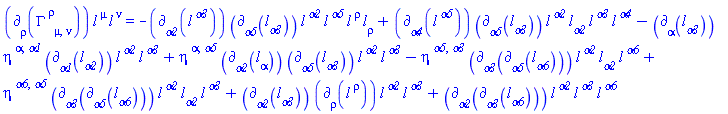

Do same thing with the first term but use the Simplify command
Simplify(Physics:-`*`(Physics:-`*`(d_[rho](Physics:-Christoffel[`~rho`, mu, nu] = (1/2)*Physics:-d_[nu](l[alpha](X), [X])*l[mu](X)*eta[`~alpha`, `~rho`]-(1/2)*l[mu](X)*Physics:-d_[alpha](l[nu](X), [X])*eta[`~alpha`, `~rho`]+(1/2)*l[`~rho`](X)*Physics:-d_[nu](l[mu](X), [X])+(1/2)*l[`~rho`](X)*Physics:-d_[mu](l[nu](X), [X])+(1/2)*Physics:-d_[mu](l[alpha](X), [X])*l[nu](X)*eta[`~alpha`, `~rho`]-(1/2)*l[nu](X)*Physics:-d_[alpha](l[mu](X), [X])*eta[`~alpha`, `~rho`]-(1/2)*l[`~alpha`](X)*l[`~rho`](X)*Physics:-d_[nu](l[alpha](X), [X])*l[mu](X)+(1/2)*l[`~alpha`](X)*l[`~rho`](X)*l[mu](X)*Physics:-d_[alpha](l[nu](X), [X])-(1/2)*l[`~alpha`](X)*l[`~rho`](X)*Physics:-d_[mu](l[alpha](X), [X])*l[nu](X)+(1/2)*l[`~alpha`](X)*l[`~rho`](X)*l[nu](X)*Physics:-d_[alpha](l[mu](X), [X])), l[`~mu`](X)), l[`~nu`](X)))
Physics:-d_[rho](Physics:-Christoffel[`~rho`, mu, nu], [X])*l[`~mu`](X)*l[`~nu`](X) = -Physics:-d_[alpha2](l[`~alpha3`](X), [X])*Physics:-d_[alpha5](l[alpha3](X), [X])*l[`~alpha2`](X)*l[`~alpha5`](X)*l[`~rho`](X)*l[rho](X)+Physics:-d_[alpha4](l[`~alpha5`](X), [X])*Physics:-d_[alpha5](l[alpha3](X), [X])*l[`~alpha2`](X)*l[alpha2](X)*l[`~alpha3`](X)*l[`~alpha4`](X)-Physics:-d_[alpha](l[alpha3](X), [X])*eta[`~alpha`, `~alpha1`]*Physics:-d_[alpha1](l[alpha2](X), [X])*l[`~alpha2`](X)*l[`~alpha3`](X)+eta[`~alpha`, `~alpha5`]*Physics:-d_[alpha2](l[alpha](X), [X])*Physics:-d_[alpha5](l[alpha3](X), [X])*l[`~alpha2`](X)*l[`~alpha3`](X)-eta[`~alpha5`, `~alpha3`]*Physics:-d_[alpha3](Physics:-d_[alpha5](l[alpha6](X), [X]), [X])*l[`~alpha2`](X)*l[alpha2](X)*l[`~alpha6`](X)+eta[`~alpha6`, `~alpha5`]*Physics:-d_[alpha3](Physics:-d_[alpha5](l[alpha6](X), [X]), [X])*l[`~alpha2`](X)*l[alpha2](X)*l[`~alpha3`](X)+Physics:-d_[alpha2](l[alpha3](X), [X])*Physics:-d_[rho](l[`~rho`](X), [X])*l[`~alpha2`](X)*l[`~alpha3`](X)+Physics:-d_[alpha2](Physics:-d_[alpha3](l[alpha6](X), [X]), [X])*l[`~alpha2`](X)*l[`~alpha3`](X)*l[`~alpha6`](X)
SubstituteTensor(Physics:-`*`(l[`~nu`](X), l[nu](X)) = 0, Physics:-d_[rho](Physics:-Christoffel[`~rho`, mu, nu], [X])*l[`~mu`](X)*l[`~nu`](X) = -Physics:-d_[alpha2](l[`~alpha3`](X), [X])*Physics:-d_[alpha5](l[alpha3](X), [X])*l[`~alpha2`](X)*l[`~alpha5`](X)*l[`~rho`](X)*l[rho](X)+Physics:-d_[alpha4](l[`~alpha5`](X), [X])*Physics:-d_[alpha5](l[alpha3](X), [X])*l[`~alpha2`](X)*l[alpha2](X)*l[`~alpha3`](X)*l[`~alpha4`](X)-Physics:-d_[alpha](l[alpha3](X), [X])*eta[`~alpha`, `~alpha1`]*Physics:-d_[alpha1](l[alpha2](X), [X])*l[`~alpha2`](X)*l[`~alpha3`](X)+eta[`~alpha`, `~alpha5`]*Physics:-d_[alpha2](l[alpha](X), [X])*Physics:-d_[alpha5](l[alpha3](X), [X])*l[`~alpha2`](X)*l[`~alpha3`](X)-eta[`~alpha5`, `~alpha3`]*Physics:-d_[alpha3](Physics:-d_[alpha5](l[alpha6](X), [X]), [X])*l[`~alpha2`](X)*l[alpha2](X)*l[`~alpha6`](X)+eta[`~alpha6`, `~alpha5`]*Physics:-d_[alpha3](Physics:-d_[alpha5](l[alpha6](X), [X]), [X])*l[`~alpha2`](X)*l[alpha2](X)*l[`~alpha3`](X)+Physics:-d_[alpha2](l[alpha3](X), [X])*Physics:-d_[rho](l[`~rho`](X), [X])*l[`~alpha2`](X)*l[`~alpha3`](X)+Physics:-d_[alpha2](Physics:-d_[alpha3](l[alpha6](X), [X]), [X])*l[`~alpha2`](X)*l[`~alpha3`](X)*l[`~alpha6`](X))
Physics:-d_[rho](Physics:-Christoffel[`~rho`, mu, nu], [X])*l[`~mu`](X)*l[`~nu`](X) = -Physics:-d_[alpha](l[alpha3](X), [X])*eta[`~alpha`, `~alpha1`]*Physics:-d_[alpha1](l[alpha2](X), [X])*l[`~alpha2`](X)*l[`~alpha3`](X)+eta[`~alpha`, `~alpha5`]*Physics:-d_[alpha2](l[alpha](X), [X])*Physics:-d_[alpha5](l[alpha3](X), [X])*l[`~alpha2`](X)*l[`~alpha3`](X)+Physics:-d_[alpha2](l[alpha3](X), [X])*Physics:-d_[rho](l[`~rho`](X), [X])*l[`~alpha2`](X)*l[`~alpha3`](X)+Physics:-d_[alpha2](Physics:-d_[alpha3](l[alpha6](X), [X]), [X])*l[`~alpha2`](X)*l[`~alpha3`](X)*l[`~alpha6`](X)
(16)
Simplify command does make the algebra easier, but the indices are not the same. Now, equation 16 should correspond to equation 14, but there is no combination of alphas that is consistent.  The variables alpha1 and alpha5 must be rho. One term is always wrong when I try to change the other indices.
alpha2 and alpha3 must be either mu or nu based on the first term.  But alpha6 should also be either mu or nu based on the last term, however that will make alpha2 and alpha3 either (nu and rho) or (mu and rho).  Neither combination makes all of the terms consistent with (14).  Very frustrating.
SubstituteTensorIndices({alpha1 = rho, alpha5 = rho}, Physics:-d_[rho](Physics:-Christoffel[`~rho`, mu, nu], [X])*l[`~mu`](X)*l[`~nu`](X) = -Physics:-d_[alpha](l[alpha3](X), [X])*eta[`~alpha`, `~alpha1`]*Physics:-d_[alpha1](l[alpha2](X), [X])*l[`~alpha2`](X)*l[`~alpha3`](X)+eta[`~alpha`, `~alpha5`]*Physics:-d_[alpha2](l[alpha](X), [X])*Physics:-d_[alpha5](l[alpha3](X), [X])*l[`~alpha2`](X)*l[`~alpha3`](X)+Physics:-d_[alpha2](l[alpha3](X), [X])*Physics:-d_[rho](l[`~rho`](X), [X])*l[`~alpha2`](X)*l[`~alpha3`](X)+Physics:-d_[alpha2](Physics:-d_[alpha3](l[alpha6](X), [X]), [X])*l[`~alpha2`](X)*l[`~alpha3`](X)*l[`~alpha6`](X))
Physics:-d_[rho](Physics:-Christoffel[`~rho`, mu, nu], [X])*l[`~mu`](X)*l[`~nu`](X) = -Physics:-d_[alpha](l[alpha3](X), [X])*eta[`~alpha`, `~rho`]*Physics:-d_[rho](l[alpha2](X), [X])*l[`~alpha2`](X)*l[`~alpha3`](X)+eta[`~alpha`, `~rho`]*Physics:-d_[alpha2](l[alpha](X), [X])*Physics:-d_[rho](l[alpha3](X), [X])*l[`~alpha2`](X)*l[`~alpha3`](X)+Physics:-d_[alpha2](l[alpha3](X), [X])*Physics:-d_[rho](l[`~rho`](X), [X])*l[`~alpha2`](X)*l[`~alpha3`](X)+Physics:-d_[alpha2](Physics:-d_[alpha3](l[alpha6](X), [X]), [X])*l[`~alpha2`](X)*l[`~alpha3`](X)*l[`~alpha6`](X)
