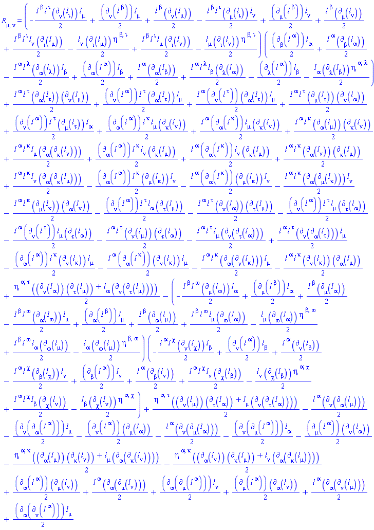

I am having trouble with the SubstitutionTensor command.  It kicks out an error message for operand with different free indices, but the operands seems to be fine.  I checked all of the terms and they all seem fine. Thank you for your help.

expand(Physics:-`*`(Physics:-`*`(Physics:-Ricci[mu, nu] = (1/2)*Physics:-d_[nu](l[`~alpha`](X), [X])*l[`~tau`](X)*Physics:-d_[alpha](l[tau](X), [X])*l[mu](X)+(1/2)*l[`~alpha`](X)*Physics:-d_[nu](l[`~tau`](X), [X])*Physics:-d_[alpha](l[tau](X), [X])*l[mu](X)+(1/2)*l[`~alpha`](X)*l[`~tau`](X)*Physics:-d_[mu](l[tau](X), [X])*Physics:-d_[nu](l[alpha](X), [X])+(1/2)*Physics:-d_[nu](l[`~alpha`](X), [X])*l[`~tau`](X)*Physics:-d_[mu](l[tau](X), [X])*l[alpha](X)+(1/2)*Physics:-d_[alpha](l[`~alpha`](X), [X])*l[`~kappa`](X)*l[mu](X)*Physics:-d_[kappa](l[nu](X), [X])+(1/2)*l[`~alpha`](X)*Physics:-d_[alpha](l[`~kappa`](X), [X])*l[mu](X)*Physics:-d_[kappa](l[nu](X), [X])+(1/2)*l[`~alpha`](X)*l[`~kappa`](X)*Physics:-d_[alpha](l[mu](X), [X])*Physics:-d_[kappa](l[nu](X), [X])+(1/2)*l[`~alpha`](X)*l[`~kappa`](X)*l[mu](X)*Physics:-d_[alpha](Physics:-d_[kappa](l[nu](X), [X]), [X])+(1/2)*Physics:-d_[alpha](l[`~alpha`](X), [X])*l[`~kappa`](X)*l[nu](X)*Physics:-d_[kappa](l[mu](X), [X])+(1/2)*l[`~alpha`](X)*Physics:-d_[alpha](l[`~kappa`](X), [X])*l[nu](X)*Physics:-d_[kappa](l[mu](X), [X])+(1/2)*l[`~alpha`](X)*l[`~kappa`](X)*Physics:-d_[alpha](l[nu](X), [X])*Physics:-d_[kappa](l[mu](X), [X])+(1/2)*l[`~alpha`](X)*l[`~kappa`](X)*l[nu](X)*Physics:-d_[alpha](Physics:-d_[kappa](l[mu](X), [X]), [X])-(1/2)*Physics:-d_[alpha](l[`~alpha`](X), [X])*l[`~kappa`](X)*Physics:-d_[mu](l[kappa](X), [X])*l[nu](X)-(1/2)*l[`~alpha`](X)*Physics:-d_[alpha](l[`~kappa`](X), [X])*Physics:-d_[mu](l[kappa](X), [X])*l[nu](X)-(1/2)*l[`~alpha`](X)*l[`~kappa`](X)*Physics:-d_[alpha](Physics:-d_[mu](l[kappa](X), [X]), [X])*l[nu](X)-(1/2)*l[`~alpha`](X)*l[`~kappa`](X)*Physics:-d_[mu](l[kappa](X), [X])*Physics:-d_[alpha](l[nu](X), [X])-(1/2)*l[`~alpha`](X)*l[`~kappa`](X)*Physics:-d_[nu](l[kappa](X), [X])*Physics:-d_[alpha](l[mu](X), [X])-(1/2)*Physics:-d_[alpha](l[`~alpha`](X), [X])*l[`~kappa`](X)*Physics:-d_[nu](l[kappa](X), [X])*l[mu](X)-(1/2)*l[`~alpha`](X)*Physics:-d_[alpha](l[`~kappa`](X), [X])*Physics:-d_[nu](l[kappa](X), [X])*l[mu](X)-(1/2)*l[`~alpha`](X)*l[`~kappa`](X)*Physics:-d_[alpha](Physics:-d_[nu](l[kappa](X), [X]), [X])*l[mu](X)-(1/2)*Physics:-d_[nu](l[`~alpha`](X), [X])*l[`~tau`](X)*l[alpha](X)*Physics:-d_[tau](l[mu](X), [X])-(1/2)*l[`~alpha`](X)*l[`~tau`](X)*Physics:-d_[nu](l[alpha](X), [X])*Physics:-d_[tau](l[mu](X), [X])-(1/2)*Physics:-d_[nu](l[`~alpha`](X), [X])*l[`~tau`](X)*l[mu](X)*Physics:-d_[tau](l[alpha](X), [X])-(1/2)*l[`~alpha`](X)*Physics:-d_[nu](l[`~tau`](X), [X])*l[mu](X)*Physics:-d_[tau](l[alpha](X), [X])-(1/2)*l[`~alpha`](X)*l[`~tau`](X)*Physics:-d_[nu](l[mu](X), [X])*Physics:-d_[tau](l[alpha](X), [X])-(1/2)*l[`~alpha`](X)*l[`~tau`](X)*l[mu](X)*Physics:-d_[nu](Physics:-d_[tau](l[alpha](X), [X]), [X])+(1/2)*l[`~alpha`](X)*l[`~tau`](X)*Physics:-d_[nu](Physics:-d_[alpha](l[tau](X), [X]), [X])*l[mu](X)+(1/2)*l[`~alpha`](X)*l[`~tau`](X)*Physics:-d_[alpha](l[tau](X), [X])*Physics:-d_[nu](l[mu](X), [X])+(-(1/2)*l[`~beta`](X)*l[`~iota`](X)*Physics:-d_[nu](l[iota](X), [X])*l[mu](X)+(1/2)*Physics:-d_[nu](l[`~beta`](X), [X])*l[mu](X)+(1/2)*l[`~beta`](X)*Physics:-d_[nu](l[mu](X), [X])-(1/2)*l[`~beta`](X)*l[`~iota`](X)*Physics:-d_[mu](l[iota](X), [X])*l[nu](X)+(1/2)*Physics:-d_[mu](l[`~beta`](X), [X])*l[nu](X)+(1/2)*l[`~beta`](X)*Physics:-d_[mu](l[nu](X), [X])+(1/2)*l[`~beta`](X)*l[`~iota`](X)*l[nu](X)*Physics:-d_[iota](l[mu](X), [X])-(1/2)*l[nu](X)*Physics:-d_[iota](l[mu](X), [X])*eta[`~beta`, `~iota`]+(1/2)*l[`~beta`](X)*l[`~iota`](X)*l[mu](X)*Physics:-d_[iota](l[nu](X), [X])-(1/2)*l[mu](X)*Physics:-d_[iota](l[nu](X), [X])*eta[`~beta`, `~iota`])*((1/2)*Physics:-d_[beta](l[`~alpha`](X), [X])*l[alpha](X)+(1/2)*l[`~alpha`](X)*Physics:-d_[beta](l[alpha](X), [X])-(1/2)*l[`~alpha`](X)*l[`~lambda`](X)*Physics:-d_[alpha](l[lambda](X), [X])*l[beta](X)+(1/2)*Physics:-d_[alpha](l[`~alpha`](X), [X])*l[beta](X)+(1/2)*l[`~alpha`](X)*Physics:-d_[alpha](l[beta](X), [X])+(1/2)*l[`~alpha`](X)*l[`~lambda`](X)*l[beta](X)*Physics:-d_[lambda](l[alpha](X), [X])-(1/2)*Physics:-d_[lambda](l[`~alpha`](X), [X])*l[beta](X)-(1/2)*l[alpha](X)*Physics:-d_[lambda](l[beta](X), [X])*eta[`~alpha`, `~lambda`])+(1/2)*eta[`~alpha`, `~tau`]*(Physics:-d_[nu](l[alpha](X), [X])*Physics:-d_[tau](l[mu](X), [X])+l[alpha](X)*Physics:-d_[nu](Physics:-d_[tau](l[mu](X), [X]), [X]))-(-(1/2)*l[`~beta`](X)*l[`~omega`](X)*Physics:-d_[mu](l[omega](X), [X])*l[alpha](X)+(1/2)*Physics:-d_[mu](l[`~beta`](X), [X])*l[alpha](X)+(1/2)*l[`~beta`](X)*Physics:-d_[mu](l[alpha](X), [X])-(1/2)*l[`~beta`](X)*l[`~omega`](X)*Physics:-d_[alpha](l[omega](X), [X])*l[mu](X)+(1/2)*Physics:-d_[alpha](l[`~beta`](X), [X])*l[mu](X)+(1/2)*l[`~beta`](X)*Physics:-d_[alpha](l[mu](X), [X])+(1/2)*l[`~beta`](X)*l[`~omega`](X)*l[mu](X)*Physics:-d_[omega](l[alpha](X), [X])-(1/2)*l[mu](X)*Physics:-d_[omega](l[alpha](X), [X])*eta[`~beta`, `~omega`]+(1/2)*l[`~beta`](X)*l[`~omega`](X)*l[alpha](X)*Physics:-d_[omega](l[mu](X), [X])-(1/2)*l[alpha](X)*Physics:-d_[omega](l[mu](X), [X])*eta[`~beta`, `~omega`])*(-(1/2)*l[`~alpha`](X)*l[`~chi`](X)*Physics:-d_[nu](l[chi](X), [X])*l[beta](X)+(1/2)*Physics:-d_[nu](l[`~alpha`](X), [X])*l[beta](X)+(1/2)*l[`~alpha`](X)*Physics:-d_[nu](l[beta](X), [X])-(1/2)*l[`~alpha`](X)*l[`~chi`](X)*Physics:-d_[beta](l[chi](X), [X])*l[nu](X)+(1/2)*Physics:-d_[beta](l[`~alpha`](X), [X])*l[nu](X)+(1/2)*l[`~alpha`](X)*Physics:-d_[beta](l[nu](X), [X])+(1/2)*l[`~alpha`](X)*l[`~chi`](X)*l[nu](X)*Physics:-d_[chi](l[beta](X), [X])-(1/2)*l[nu](X)*Physics:-d_[chi](l[beta](X), [X])*eta[`~alpha`, `~chi`]+(1/2)*l[`~alpha`](X)*l[`~chi`](X)*l[beta](X)*Physics:-d_[chi](l[nu](X), [X])-(1/2)*l[beta](X)*Physics:-d_[chi](l[nu](X), [X])*eta[`~alpha`, `~chi`])+(1/2)*eta[`~alpha`, `~tau`]*(Physics:-d_[nu](l[mu](X), [X])*Physics:-d_[tau](l[alpha](X), [X])+l[mu](X)*Physics:-d_[nu](Physics:-d_[tau](l[alpha](X), [X]), [X]))-(1/2)*l[`~alpha`](X)*Physics:-d_[nu](Physics:-d_[alpha](l[mu](X), [X]), [X])-(1/2)*Physics:-d_[nu](Physics:-d_[alpha](l[`~alpha`](X), [X]), [X])*l[mu](X)-(1/2)*Physics:-d_[nu](l[`~alpha`](X), [X])*Physics:-d_[mu](l[alpha](X), [X])-(1/2)*l[`~alpha`](X)*Physics:-d_[nu](Physics:-d_[mu](l[alpha](X), [X]), [X])-(1/2)*Physics:-d_[nu](Physics:-d_[mu](l[`~alpha`](X), [X]), [X])*l[alpha](X)-(1/2)*Physics:-d_[mu](l[`~alpha`](X), [X])*Physics:-d_[nu](l[alpha](X), [X])-(1/2)*eta[`~alpha`, `~kappa`]*(Physics:-d_[alpha](l[mu](X), [X])*Physics:-d_[kappa](l[nu](X), [X])+l[mu](X)*Physics:-d_[alpha](Physics:-d_[kappa](l[nu](X), [X]), [X]))-(1/2)*eta[`~alpha`, `~kappa`]*(Physics:-d_[alpha](l[nu](X), [X])*Physics:-d_[kappa](l[mu](X), [X])+l[nu](X)*Physics:-d_[alpha](Physics:-d_[kappa](l[mu](X), [X]), [X]))+(1/2)*Physics:-d_[alpha](l[`~alpha`](X), [X])*Physics:-d_[mu](l[nu](X), [X])+(1/2)*l[`~alpha`](X)*Physics:-d_[alpha](Physics:-d_[mu](l[nu](X), [X]), [X])+(1/2)*Physics:-d_[alpha](Physics:-d_[mu](l[`~alpha`](X), [X]), [X])*l[nu](X)+(1/2)*Physics:-d_[mu](l[`~alpha`](X), [X])*Physics:-d_[alpha](l[nu](X), [X])+(1/2)*l[`~alpha`](X)*Physics:-d_[alpha](Physics:-d_[nu](l[mu](X), [X]), [X])+(1/2)*Physics:-d_[alpha](Physics:-d_[nu](l[`~alpha`](X), [X]), [X])*l[mu](X), l[`~mu`](X)), l[`~nu`](X)))
Physics:-Ricci[mu, nu]*l[`~mu`](X)*l[`~nu`](X) = (1/2)*l[`~mu`](X)*l[`~nu`](X)*eta[`~alpha`, `~tau`]*Physics:-d_[nu](l[alpha](X), [X])*Physics:-d_[tau](l[mu](X), [X])+(1/2)*l[`~mu`](X)*l[`~nu`](X)*eta[`~alpha`, `~tau`]*l[alpha](X)*Physics:-d_[nu](Physics:-d_[tau](l[mu](X), [X]), [X])+(1/2)*l[`~mu`](X)*l[`~nu`](X)*eta[`~alpha`, `~tau`]*Physics:-d_[nu](l[mu](X), [X])*Physics:-d_[tau](l[alpha](X), [X])+(1/2)*l[`~mu`](X)*l[`~nu`](X)*eta[`~alpha`, `~tau`]*l[mu](X)*Physics:-d_[nu](Physics:-d_[tau](l[alpha](X), [X]), [X])-(1/2)*l[`~mu`](X)*l[`~nu`](X)*eta[`~alpha`, `~kappa`]*Physics:-d_[alpha](l[mu](X), [X])*Physics:-d_[kappa](l[nu](X), [X])-(1/2)*l[`~mu`](X)*l[`~nu`](X)*eta[`~alpha`, `~kappa`]*l[mu](X)*Physics:-d_[alpha](Physics:-d_[kappa](l[nu](X), [X]), [X])-(1/2)*l[`~mu`](X)*l[`~nu`](X)*eta[`~alpha`, `~kappa`]*Physics:-d_[alpha](l[nu](X), [X])*Physics:-d_[kappa](l[mu](X), [X])-(1/2)*l[`~mu`](X)*l[`~nu`](X)*eta[`~alpha`, `~kappa`]*l[nu](X)*Physics:-d_[alpha](Physics:-d_[kappa](l[mu](X), [X]), [X])-(1/2)*l[`~mu`](X)*l[`~nu`](X)*l[`~alpha`](X)*l[`~kappa`](X)*Physics:-d_[nu](l[kappa](X), [X])*Physics:-d_[alpha](l[mu](X), [X])-(1/2)*l[`~mu`](X)*l[`~nu`](X)*Physics:-d_[alpha](l[`~alpha`](X), [X])*l[`~kappa`](X)*Physics:-d_[nu](l[kappa](X), [X])*l[mu](X)-(1/2)*l[`~mu`](X)*l[`~nu`](X)*l[`~alpha`](X)*Physics:-d_[alpha](l[`~kappa`](X), [X])*Physics:-d_[nu](l[kappa](X), [X])*l[mu](X)-(1/2)*l[`~mu`](X)*l[`~nu`](X)*l[`~alpha`](X)*l[`~kappa`](X)*Physics:-d_[alpha](Physics:-d_[nu](l[kappa](X), [X]), [X])*l[mu](X)-(1/4)*l[`~mu`](X)*l[`~nu`](X)*l[`~beta`](X)*Physics:-d_[alpha](l[mu](X), [X])*Physics:-d_[beta](l[`~alpha`](X), [X])*l[nu](X)-(1/4)*l[`~mu`](X)*l[`~nu`](X)*l[`~beta`](X)*Physics:-d_[alpha](l[mu](X), [X])*l[`~alpha`](X)*Physics:-d_[beta](l[nu](X), [X])+(1/4)*l[`~mu`](X)*l[`~nu`](X)*Physics:-d_[nu](l[`~beta`](X), [X])*l[mu](X)*Physics:-d_[beta](l[`~alpha`](X), [X])*l[alpha](X)+(1/4)*l[`~mu`](X)*l[`~nu`](X)*Physics:-d_[nu](l[`~beta`](X), [X])*l[mu](X)*l[`~alpha`](X)*Physics:-d_[beta](l[alpha](X), [X])+(1/4)*l[`~mu`](X)*l[`~nu`](X)*Physics:-d_[nu](l[`~beta`](X), [X])*l[mu](X)*Physics:-d_[alpha](l[`~alpha`](X), [X])*l[beta](X)+(1/4)*l[`~mu`](X)*l[`~nu`](X)*Physics:-d_[nu](l[`~beta`](X), [X])*l[mu](X)*l[`~alpha`](X)*Physics:-d_[alpha](l[beta](X), [X])-(1/4)*l[`~mu`](X)*l[`~nu`](X)*Physics:-d_[nu](l[`~beta`](X), [X])*l[mu](X)*Physics:-d_[lambda](l[`~alpha`](X), [X])*l[beta](X)+(1/4)*l[`~mu`](X)*l[`~nu`](X)*l[`~beta`](X)*Physics:-d_[nu](l[mu](X), [X])*Physics:-d_[beta](l[`~alpha`](X), [X])*l[alpha](X)+(1/4)*l[`~mu`](X)*l[`~nu`](X)*l[`~beta`](X)*Physics:-d_[nu](l[mu](X), [X])*l[`~alpha`](X)*Physics:-d_[beta](l[alpha](X), [X])+(1/4)*l[`~mu`](X)*l[`~nu`](X)*l[`~beta`](X)*Physics:-d_[nu](l[mu](X), [X])*Physics:-d_[alpha](l[`~alpha`](X), [X])*l[beta](X)+(1/4)*l[`~mu`](X)*l[`~nu`](X)*l[`~beta`](X)*Physics:-d_[nu](l[mu](X), [X])*l[`~alpha`](X)*Physics:-d_[alpha](l[beta](X), [X])-(1/4)*l[`~mu`](X)*l[`~nu`](X)*l[`~beta`](X)*Physics:-d_[nu](l[mu](X), [X])*Physics:-d_[lambda](l[`~alpha`](X), [X])*l[beta](X)+(1/4)*l[`~mu`](X)*l[`~nu`](X)*Physics:-d_[mu](l[`~beta`](X), [X])*l[nu](X)*l[`~alpha`](X)*Physics:-d_[beta](l[alpha](X), [X])+(1/4)*l[`~mu`](X)*l[`~nu`](X)*Physics:-d_[mu](l[`~beta`](X), [X])*l[nu](X)*Physics:-d_[alpha](l[`~alpha`](X), [X])*l[beta](X)+(1/4)*l[`~mu`](X)*l[`~nu`](X)*Physics:-d_[mu](l[`~beta`](X), [X])*l[nu](X)*l[`~alpha`](X)*Physics:-d_[alpha](l[beta](X), [X])-(1/4)*l[`~mu`](X)*l[`~nu`](X)*Physics:-d_[mu](l[`~beta`](X), [X])*l[nu](X)*Physics:-d_[lambda](l[`~alpha`](X), [X])*l[beta](X)+(1/4)*l[`~mu`](X)*l[`~nu`](X)*l[`~beta`](X)*Physics:-d_[mu](l[nu](X), [X])*Physics:-d_[beta](l[`~alpha`](X), [X])*l[alpha](X)+(1/4)*l[`~mu`](X)*l[`~nu`](X)*l[`~beta`](X)*Physics:-d_[mu](l[nu](X), [X])*l[`~alpha`](X)*Physics:-d_[beta](l[alpha](X), [X])+(1/4)*l[`~mu`](X)*l[`~nu`](X)*l[`~beta`](X)*Physics:-d_[mu](l[nu](X), [X])*Physics:-d_[alpha](l[`~alpha`](X), [X])*l[beta](X)+(1/4)*l[`~mu`](X)*l[`~nu`](X)*l[`~beta`](X)*Physics:-d_[mu](l[nu](X), [X])*l[`~alpha`](X)*Physics:-d_[alpha](l[beta](X), [X])-(1/4)*l[`~mu`](X)*l[`~nu`](X)*l[`~beta`](X)*Physics:-d_[mu](l[nu](X), [X])*Physics:-d_[lambda](l[`~alpha`](X), [X])*l[beta](X)-(1/4)*l[`~mu`](X)*l[`~nu`](X)*Physics:-d_[mu](l[`~beta`](X), [X])*l[alpha](X)*Physics:-d_[nu](l[`~alpha`](X), [X])*l[beta](X)-(1/4)*l[`~mu`](X)*l[`~nu`](X)*Physics:-d_[mu](l[`~beta`](X), [X])*l[alpha](X)*l[`~alpha`](X)*Physics:-d_[nu](l[beta](X), [X])-(1/4)*l[`~mu`](X)*l[`~nu`](X)*Physics:-d_[mu](l[`~beta`](X), [X])*l[alpha](X)*l[`~alpha`](X)*Physics:-d_[beta](l[nu](X), [X])-(1/4)*l[`~mu`](X)*l[`~nu`](X)*l[`~beta`](X)*Physics:-d_[mu](l[alpha](X), [X])*Physics:-d_[nu](l[`~alpha`](X), [X])*l[beta](X)-(1/4)*l[`~mu`](X)*l[`~nu`](X)*l[`~beta`](X)*Physics:-d_[mu](l[alpha](X), [X])*l[`~alpha`](X)*Physics:-d_[nu](l[beta](X), [X])-(1/4)*l[`~mu`](X)*l[`~nu`](X)*l[`~beta`](X)*Physics:-d_[mu](l[alpha](X), [X])*Physics:-d_[beta](l[`~alpha`](X), [X])*l[nu](X)-(1/4)*l[`~mu`](X)*l[`~nu`](X)*l[`~beta`](X)*Physics:-d_[mu](l[alpha](X), [X])*l[`~alpha`](X)*Physics:-d_[beta](l[nu](X), [X])-(1/4)*l[`~mu`](X)*l[`~nu`](X)*Physics:-d_[alpha](l[`~beta`](X), [X])*l[mu](X)*Physics:-d_[nu](l[`~alpha`](X), [X])*l[beta](X)-(1/4)*l[`~mu`](X)*l[`~nu`](X)*Physics:-d_[alpha](l[`~beta`](X), [X])*l[mu](X)*l[`~alpha`](X)*Physics:-d_[nu](l[beta](X), [X])-(1/4)*l[`~mu`](X)*l[`~nu`](X)*Physics:-d_[alpha](l[`~beta`](X), [X])*l[mu](X)*Physics:-d_[beta](l[`~alpha`](X), [X])*l[nu](X)-(1/4)*l[`~mu`](X)*l[`~nu`](X)*Physics:-d_[alpha](l[`~beta`](X), [X])*l[mu](X)*l[`~alpha`](X)*Physics:-d_[beta](l[nu](X), [X])-(1/4)*l[`~mu`](X)*l[`~nu`](X)*l[`~beta`](X)*Physics:-d_[alpha](l[mu](X), [X])*Physics:-d_[nu](l[`~alpha`](X), [X])*l[beta](X)-(1/4)*l[`~mu`](X)*l[`~nu`](X)*l[`~beta`](X)*Physics:-d_[alpha](l[mu](X), [X])*l[`~alpha`](X)*Physics:-d_[nu](l[beta](X), [X])-(1/2)*l[`~mu`](X)*l[`~nu`](X)*Physics:-d_[nu](l[`~alpha`](X), [X])*l[`~tau`](X)*l[alpha](X)*Physics:-d_[tau](l[mu](X), [X])-(1/2)*l[`~mu`](X)*l[`~nu`](X)*l[`~alpha`](X)*l[`~tau`](X)*Physics:-d_[nu](l[alpha](X), [X])*Physics:-d_[tau](l[mu](X), [X])-(1/2)*l[`~mu`](X)*l[`~nu`](X)*Physics:-d_[nu](l[`~alpha`](X), [X])*l[`~tau`](X)*l[mu](X)*Physics:-d_[tau](l[alpha](X), [X])-(1/2)*l[`~mu`](X)*l[`~nu`](X)*l[`~alpha`](X)*Physics:-d_[nu](l[`~tau`](X), [X])*l[mu](X)*Physics:-d_[tau](l[alpha](X), [X])-(1/2)*l[`~mu`](X)*l[`~nu`](X)*l[`~alpha`](X)*l[`~tau`](X)*Physics:-d_[nu](l[mu](X), [X])*Physics:-d_[tau](l[alpha](X), [X])-(1/2)*l[`~mu`](X)*l[`~nu`](X)*l[`~alpha`](X)*l[`~tau`](X)*l[mu](X)*Physics:-d_[nu](Physics:-d_[tau](l[alpha](X), [X]), [X])+(1/2)*l[`~mu`](X)*l[`~nu`](X)*l[`~alpha`](X)*l[`~tau`](X)*Physics:-d_[nu](Physics:-d_[alpha](l[tau](X), [X]), [X])*l[mu](X)+(1/2)*l[`~mu`](X)*l[`~nu`](X)*l[`~alpha`](X)*l[`~tau`](X)*Physics:-d_[alpha](l[tau](X), [X])*Physics:-d_[nu](l[mu](X), [X])+(1/2)*l[`~mu`](X)*l[`~nu`](X)*Physics:-d_[nu](l[`~alpha`](X), [X])*l[`~tau`](X)*Physics:-d_[alpha](l[tau](X), [X])*l[mu](X)+(1/2)*l[`~mu`](X)*l[`~nu`](X)*l[`~alpha`](X)*Physics:-d_[nu](l[`~tau`](X), [X])*Physics:-d_[alpha](l[tau](X), [X])*l[mu](X)+(1/2)*l[`~mu`](X)*l[`~nu`](X)*l[`~alpha`](X)*l[`~tau`](X)*Physics:-d_[mu](l[tau](X), [X])*Physics:-d_[nu](l[alpha](X), [X])+(1/2)*l[`~mu`](X)*l[`~nu`](X)*Physics:-d_[nu](l[`~alpha`](X), [X])*l[`~tau`](X)*Physics:-d_[mu](l[tau](X), [X])*l[alpha](X)+(1/2)*l[`~mu`](X)*l[`~nu`](X)*Physics:-d_[alpha](l[`~alpha`](X), [X])*l[`~kappa`](X)*l[mu](X)*Physics:-d_[kappa](l[nu](X), [X])+(1/2)*l[`~mu`](X)*l[`~nu`](X)*l[`~alpha`](X)*Physics:-d_[alpha](l[`~kappa`](X), [X])*l[mu](X)*Physics:-d_[kappa](l[nu](X), [X])+(1/2)*l[`~mu`](X)*l[`~nu`](X)*l[`~alpha`](X)*l[`~kappa`](X)*Physics:-d_[alpha](l[mu](X), [X])*Physics:-d_[kappa](l[nu](X), [X])+(1/2)*l[`~mu`](X)*l[`~nu`](X)*l[`~alpha`](X)*l[`~kappa`](X)*l[mu](X)*Physics:-d_[alpha](Physics:-d_[kappa](l[nu](X), [X]), [X])+(1/2)*l[`~mu`](X)*l[`~nu`](X)*Physics:-d_[alpha](l[`~alpha`](X), [X])*l[`~kappa`](X)*l[nu](X)*Physics:-d_[kappa](l[mu](X), [X])+(1/2)*l[`~mu`](X)*l[`~nu`](X)*l[`~alpha`](X)*Physics:-d_[alpha](l[`~kappa`](X), [X])*l[nu](X)*Physics:-d_[kappa](l[mu](X), [X])+(1/2)*l[`~mu`](X)*l[`~nu`](X)*l[`~alpha`](X)*l[`~kappa`](X)*Physics:-d_[alpha](l[nu](X), [X])*Physics:-d_[kappa](l[mu](X), [X])+(1/2)*l[`~mu`](X)*l[`~nu`](X)*l[`~alpha`](X)*l[`~kappa`](X)*l[nu](X)*Physics:-d_[alpha](Physics:-d_[kappa](l[mu](X), [X]), [X])-(1/2)*l[`~mu`](X)*l[`~nu`](X)*Physics:-d_[alpha](l[`~alpha`](X), [X])*l[`~kappa`](X)*Physics:-d_[mu](l[kappa](X), [X])*l[nu](X)-(1/2)*l[`~mu`](X)*l[`~nu`](X)*l[`~alpha`](X)*Physics:-d_[alpha](l[`~kappa`](X), [X])*Physics:-d_[mu](l[kappa](X), [X])*l[nu](X)-(1/2)*l[`~mu`](X)*l[`~nu`](X)*l[`~alpha`](X)*l[`~kappa`](X)*Physics:-d_[alpha](Physics:-d_[mu](l[kappa](X), [X]), [X])*l[nu](X)-(1/2)*l[`~mu`](X)*l[`~nu`](X)*l[`~alpha`](X)*l[`~kappa`](X)*Physics:-d_[mu](l[kappa](X), [X])*Physics:-d_[alpha](l[nu](X), [X])+(1/4)*l[`~mu`](X)*l[`~nu`](X)*l[mu](X)*Physics:-d_[omega](l[alpha](X), [X])*eta[`~beta`, `~omega`]*l[`~alpha`](X)*l[`~chi`](X)*l[nu](X)*Physics:-d_[chi](l[beta](X), [X])+(1/4)*l[`~mu`](X)*l[`~nu`](X)*l[mu](X)*Physics:-d_[omega](l[alpha](X), [X])*eta[`~beta`, `~omega`]*l[`~alpha`](X)*l[`~chi`](X)*l[beta](X)*Physics:-d_[chi](l[nu](X), [X])+(1/4)*l[`~mu`](X)*l[`~nu`](X)*l[`~beta`](X)*l[`~omega`](X)*l[alpha](X)*Physics:-d_[omega](l[mu](X), [X])*l[nu](X)*Physics:-d_[chi](l[beta](X), [X])*eta[`~alpha`, `~chi`]+(1/4)*l[`~mu`](X)*l[`~nu`](X)*l[`~beta`](X)*l[`~omega`](X)*l[alpha](X)*Physics:-d_[omega](l[mu](X), [X])*l[beta](X)*Physics:-d_[chi](l[nu](X), [X])*eta[`~alpha`, `~chi`]-(1/4)*l[`~mu`](X)*l[`~nu`](X)*l[alpha](X)*Physics:-d_[omega](l[mu](X), [X])*eta[`~beta`, `~omega`]*l[`~alpha`](X)*l[`~chi`](X)*Physics:-d_[nu](l[chi](X), [X])*l[beta](X)-(1/4)*l[`~mu`](X)*l[`~nu`](X)*l[alpha](X)*Physics:-d_[omega](l[mu](X), [X])*eta[`~beta`, `~omega`]*l[`~alpha`](X)*l[`~chi`](X)*Physics:-d_[beta](l[chi](X), [X])*l[nu](X)+(1/4)*l[`~mu`](X)*l[`~nu`](X)*l[alpha](X)*Physics:-d_[omega](l[mu](X), [X])*eta[`~beta`, `~omega`]*l[`~alpha`](X)*l[`~chi`](X)*l[nu](X)*Physics:-d_[chi](l[beta](X), [X])+(1/4)*l[`~mu`](X)*l[`~nu`](X)*l[alpha](X)*Physics:-d_[omega](l[mu](X), [X])*eta[`~beta`, `~omega`]*l[`~alpha`](X)*l[`~chi`](X)*l[beta](X)*Physics:-d_[chi](l[nu](X), [X])+(1/4)*l[`~mu`](X)*l[`~nu`](X)*l[`~beta`](X)*l[`~iota`](X)*Physics:-d_[nu](l[iota](X), [X])*l[mu](X)*l[alpha](X)*Physics:-d_[lambda](l[beta](X), [X])*eta[`~alpha`, `~lambda`]+(1/4)*l[`~mu`](X)*l[`~nu`](X)*l[`~beta`](X)*l[`~iota`](X)*Physics:-d_[mu](l[iota](X), [X])*l[nu](X)*l[alpha](X)*Physics:-d_[lambda](l[beta](X), [X])*eta[`~alpha`, `~lambda`]-(1/4)*l[`~mu`](X)*l[`~nu`](X)*l[`~beta`](X)*l[`~iota`](X)*l[nu](X)*Physics:-d_[iota](l[mu](X), [X])*l[alpha](X)*Physics:-d_[lambda](l[beta](X), [X])*eta[`~alpha`, `~lambda`]+(1/4)*l[`~mu`](X)*l[`~nu`](X)*l[nu](X)*Physics:-d_[iota](l[mu](X), [X])*eta[`~beta`, `~iota`]*l[`~alpha`](X)*l[`~lambda`](X)*Physics:-d_[alpha](l[lambda](X), [X])*l[beta](X)-(1/4)*l[`~mu`](X)*l[`~nu`](X)*l[nu](X)*Physics:-d_[iota](l[mu](X), [X])*eta[`~beta`, `~iota`]*l[`~alpha`](X)*l[`~lambda`](X)*l[beta](X)*Physics:-d_[lambda](l[alpha](X), [X])-(1/4)*l[`~mu`](X)*l[`~nu`](X)*l[`~beta`](X)*l[`~iota`](X)*l[mu](X)*Physics:-d_[iota](l[nu](X), [X])*l[alpha](X)*Physics:-d_[lambda](l[beta](X), [X])*eta[`~alpha`, `~lambda`]+(1/4)*l[`~mu`](X)*l[`~nu`](X)*l[mu](X)*Physics:-d_[iota](l[nu](X), [X])*eta[`~beta`, `~iota`]*l[`~alpha`](X)*l[`~lambda`](X)*Physics:-d_[alpha](l[lambda](X), [X])*l[beta](X)-(1/4)*l[`~mu`](X)*l[`~nu`](X)*l[mu](X)*Physics:-d_[iota](l[nu](X), [X])*eta[`~beta`, `~iota`]*l[`~alpha`](X)*l[`~lambda`](X)*l[beta](X)*Physics:-d_[lambda](l[alpha](X), [X])-(1/4)*l[`~mu`](X)*l[`~nu`](X)*l[`~beta`](X)*l[`~omega`](X)*Physics:-d_[mu](l[omega](X), [X])*l[alpha](X)*l[nu](X)*Physics:-d_[chi](l[beta](X), [X])*eta[`~alpha`, `~chi`]-(1/4)*l[`~mu`](X)*l[`~nu`](X)*l[`~beta`](X)*l[`~omega`](X)*Physics:-d_[mu](l[omega](X), [X])*l[alpha](X)*l[beta](X)*Physics:-d_[chi](l[nu](X), [X])*eta[`~alpha`, `~chi`]-(1/4)*l[`~mu`](X)*l[`~nu`](X)*l[`~beta`](X)*l[`~omega`](X)*Physics:-d_[alpha](l[omega](X), [X])*l[mu](X)*l[nu](X)*Physics:-d_[chi](l[beta](X), [X])*eta[`~alpha`, `~chi`]-(1/4)*l[`~mu`](X)*l[`~nu`](X)*l[`~beta`](X)*l[`~omega`](X)*Physics:-d_[alpha](l[omega](X), [X])*l[mu](X)*l[beta](X)*Physics:-d_[chi](l[nu](X), [X])*eta[`~alpha`, `~chi`]+(1/4)*l[`~mu`](X)*l[`~nu`](X)*l[`~beta`](X)*l[`~omega`](X)*l[mu](X)*Physics:-d_[omega](l[alpha](X), [X])*l[nu](X)*Physics:-d_[chi](l[beta](X), [X])*eta[`~alpha`, `~chi`]+(1/4)*l[`~mu`](X)*l[`~nu`](X)*l[`~beta`](X)*l[`~omega`](X)*l[mu](X)*Physics:-d_[omega](l[alpha](X), [X])*l[beta](X)*Physics:-d_[chi](l[nu](X), [X])*eta[`~alpha`, `~chi`]-(1/4)*l[`~mu`](X)*l[`~nu`](X)*l[mu](X)*Physics:-d_[omega](l[alpha](X), [X])*eta[`~beta`, `~omega`]*l[`~alpha`](X)*l[`~chi`](X)*Physics:-d_[nu](l[chi](X), [X])*l[beta](X)-(1/4)*l[`~mu`](X)*l[`~nu`](X)*l[mu](X)*Physics:-d_[omega](l[alpha](X), [X])*eta[`~beta`, `~omega`]*l[`~alpha`](X)*l[`~chi`](X)*Physics:-d_[beta](l[chi](X), [X])*l[nu](X)+(1/4)*l[`~mu`](X)*l[`~nu`](X)*Physics:-d_[alpha](l[`~beta`](X), [X])*l[mu](X)*l[beta](X)*Physics:-d_[chi](l[nu](X), [X])*eta[`~alpha`, `~chi`]+(1/4)*l[`~mu`](X)*l[`~nu`](X)*l[`~beta`](X)*Physics:-d_[alpha](l[mu](X), [X])*l[nu](X)*Physics:-d_[chi](l[beta](X), [X])*eta[`~alpha`, `~chi`]+(1/4)*l[`~mu`](X)*l[`~nu`](X)*l[`~beta`](X)*Physics:-d_[alpha](l[mu](X), [X])*l[beta](X)*Physics:-d_[chi](l[nu](X), [X])*eta[`~alpha`, `~chi`]+(1/4)*l[`~mu`](X)*l[`~nu`](X)*l[mu](X)*Physics:-d_[omega](l[alpha](X), [X])*eta[`~beta`, `~omega`]*Physics:-d_[nu](l[`~alpha`](X), [X])*l[beta](X)+(1/4)*l[`~mu`](X)*l[`~nu`](X)*l[mu](X)*Physics:-d_[omega](l[alpha](X), [X])*eta[`~beta`, `~omega`]*l[`~alpha`](X)*Physics:-d_[nu](l[beta](X), [X])+(1/4)*l[`~mu`](X)*l[`~nu`](X)*l[mu](X)*Physics:-d_[omega](l[alpha](X), [X])*eta[`~beta`, `~omega`]*Physics:-d_[beta](l[`~alpha`](X), [X])*l[nu](X)+(1/4)*l[`~mu`](X)*l[`~nu`](X)*l[mu](X)*Physics:-d_[omega](l[alpha](X), [X])*eta[`~beta`, `~omega`]*l[`~alpha`](X)*Physics:-d_[beta](l[nu](X), [X])+(1/4)*l[`~mu`](X)*l[`~nu`](X)*l[alpha](X)*Physics:-d_[omega](l[mu](X), [X])*eta[`~beta`, `~omega`]*Physics:-d_[nu](l[`~alpha`](X), [X])*l[beta](X)+(1/4)*l[`~mu`](X)*l[`~nu`](X)*l[alpha](X)*Physics:-d_[omega](l[mu](X), [X])*eta[`~beta`, `~omega`]*l[`~alpha`](X)*Physics:-d_[nu](l[beta](X), [X])+(1/4)*l[`~mu`](X)*l[`~nu`](X)*l[alpha](X)*Physics:-d_[omega](l[mu](X), [X])*eta[`~beta`, `~omega`]*Physics:-d_[beta](l[`~alpha`](X), [X])*l[nu](X)+(1/4)*l[`~mu`](X)*l[`~nu`](X)*l[alpha](X)*Physics:-d_[omega](l[mu](X), [X])*eta[`~beta`, `~omega`]*l[`~alpha`](X)*Physics:-d_[beta](l[nu](X), [X])-(1/4)*l[`~mu`](X)*l[`~nu`](X)*Physics:-d_[nu](l[`~beta`](X), [X])*l[mu](X)*l[alpha](X)*Physics:-d_[lambda](l[beta](X), [X])*eta[`~alpha`, `~lambda`]-(1/4)*l[`~mu`](X)*l[`~nu`](X)*l[`~beta`](X)*Physics:-d_[nu](l[mu](X), [X])*l[alpha](X)*Physics:-d_[lambda](l[beta](X), [X])*eta[`~alpha`, `~lambda`]-(1/4)*l[`~mu`](X)*l[`~nu`](X)*Physics:-d_[mu](l[`~beta`](X), [X])*l[nu](X)*l[alpha](X)*Physics:-d_[lambda](l[beta](X), [X])*eta[`~alpha`, `~lambda`]-(1/4)*l[`~mu`](X)*l[`~nu`](X)*l[`~beta`](X)*Physics:-d_[mu](l[nu](X), [X])*l[alpha](X)*Physics:-d_[lambda](l[beta](X), [X])*eta[`~alpha`, `~lambda`]-(1/4)*l[`~mu`](X)*l[`~nu`](X)*l[nu](X)*Physics:-d_[iota](l[mu](X), [X])*eta[`~beta`, `~iota`]*Physics:-d_[beta](l[`~alpha`](X), [X])*l[alpha](X)-(1/4)*l[`~mu`](X)*l[`~nu`](X)*l[nu](X)*Physics:-d_[iota](l[mu](X), [X])*eta[`~beta`, `~iota`]*l[`~alpha`](X)*Physics:-d_[beta](l[alpha](X), [X])-(1/2)*l[`~mu`](X)*l[`~nu`](X)*l[`~alpha`](X)*Physics:-d_[nu](Physics:-d_[alpha](l[mu](X), [X]), [X])-(1/2)*l[`~mu`](X)*l[`~nu`](X)*Physics:-d_[nu](Physics:-d_[alpha](l[`~alpha`](X), [X]), [X])*l[mu](X)-(1/2)*l[`~mu`](X)*l[`~nu`](X)*Physics:-d_[nu](l[`~alpha`](X), [X])*Physics:-d_[mu](l[alpha](X), [X])-(1/2)*l[`~mu`](X)*l[`~nu`](X)*l[`~alpha`](X)*Physics:-d_[nu](Physics:-d_[mu](l[alpha](X), [X]), [X])-(1/2)*l[`~mu`](X)*l[`~nu`](X)*Physics:-d_[nu](Physics:-d_[mu](l[`~alpha`](X), [X]), [X])*l[alpha](X)-(1/2)*l[`~mu`](X)*l[`~nu`](X)*Physics:-d_[mu](l[`~alpha`](X), [X])*Physics:-d_[nu](l[alpha](X), [X])+(1/2)*l[`~mu`](X)*l[`~nu`](X)*Physics:-d_[alpha](l[`~alpha`](X), [X])*Physics:-d_[mu](l[nu](X), [X])+(1/2)*l[`~mu`](X)*l[`~nu`](X)*l[`~alpha`](X)*Physics:-d_[alpha](Physics:-d_[mu](l[nu](X), [X]), [X])+(1/2)*l[`~mu`](X)*l[`~nu`](X)*Physics:-d_[alpha](Physics:-d_[mu](l[`~alpha`](X), [X]), [X])*l[nu](X)+(1/2)*l[`~mu`](X)*l[`~nu`](X)*Physics:-d_[mu](l[`~alpha`](X), [X])*Physics:-d_[alpha](l[nu](X), [X])+(1/2)*l[`~mu`](X)*l[`~nu`](X)*l[`~alpha`](X)*Physics:-d_[alpha](Physics:-d_[nu](l[mu](X), [X]), [X])+(1/2)*l[`~mu`](X)*l[`~nu`](X)*Physics:-d_[alpha](Physics:-d_[nu](l[`~alpha`](X), [X]), [X])*l[mu](X)-(1/4)*l[`~mu`](X)*l[`~nu`](X)*Physics:-d_[alpha](l[`~beta`](X), [X])*l[mu](X)*l[`~alpha`](X)*l[`~chi`](X)*l[nu](X)*Physics:-d_[chi](l[beta](X), [X])-(1/4)*l[`~mu`](X)*l[`~nu`](X)*Physics:-d_[alpha](l[`~beta`](X), [X])*l[mu](X)*l[`~alpha`](X)*l[`~chi`](X)*l[beta](X)*Physics:-d_[chi](l[nu](X), [X])+(1/4)*l[`~mu`](X)*l[`~nu`](X)*l[`~beta`](X)*Physics:-d_[alpha](l[mu](X), [X])*l[`~alpha`](X)*l[`~chi`](X)*Physics:-d_[nu](l[chi](X), [X])*l[beta](X)+(1/4)*l[`~mu`](X)*l[`~nu`](X)*l[`~beta`](X)*Physics:-d_[alpha](l[mu](X), [X])*l[`~alpha`](X)*l[`~chi`](X)*Physics:-d_[beta](l[chi](X), [X])*l[nu](X)-(1/4)*l[`~mu`](X)*l[`~nu`](X)*l[`~beta`](X)*Physics:-d_[alpha](l[mu](X), [X])*l[`~alpha`](X)*l[`~chi`](X)*l[nu](X)*Physics:-d_[chi](l[beta](X), [X])-(1/4)*l[`~mu`](X)*l[`~nu`](X)*l[`~beta`](X)*Physics:-d_[alpha](l[mu](X), [X])*l[`~alpha`](X)*l[`~chi`](X)*l[beta](X)*Physics:-d_[chi](l[nu](X), [X])-(1/4)*l[`~mu`](X)*l[`~nu`](X)*l[`~beta`](X)*l[`~omega`](X)*l[mu](X)*Physics:-d_[omega](l[alpha](X), [X])*Physics:-d_[nu](l[`~alpha`](X), [X])*l[beta](X)-(1/4)*l[`~mu`](X)*l[`~nu`](X)*l[`~beta`](X)*l[`~omega`](X)*l[mu](X)*Physics:-d_[omega](l[alpha](X), [X])*l[`~alpha`](X)*Physics:-d_[nu](l[beta](X), [X])-(1/4)*l[`~mu`](X)*l[`~nu`](X)*l[`~beta`](X)*l[`~omega`](X)*l[mu](X)*Physics:-d_[omega](l[alpha](X), [X])*Physics:-d_[beta](l[`~alpha`](X), [X])*l[nu](X)-(1/4)*l[`~mu`](X)*l[`~nu`](X)*l[`~beta`](X)*l[`~omega`](X)*l[mu](X)*Physics:-d_[omega](l[alpha](X), [X])*l[`~alpha`](X)*Physics:-d_[beta](l[nu](X), [X])+(1/4)*l[`~mu`](X)*l[`~nu`](X)*l[`~beta`](X)*l[`~omega`](X)*Physics:-d_[mu](l[omega](X), [X])*l[alpha](X)*Physics:-d_[nu](l[`~alpha`](X), [X])*l[beta](X)+(1/4)*l[`~mu`](X)*l[`~nu`](X)*l[`~beta`](X)*l[`~omega`](X)*Physics:-d_[mu](l[omega](X), [X])*l[alpha](X)*l[`~alpha`](X)*Physics:-d_[nu](l[beta](X), [X])+(1/4)*l[`~mu`](X)*l[`~nu`](X)*l[`~beta`](X)*l[`~omega`](X)*Physics:-d_[mu](l[omega](X), [X])*l[alpha](X)*Physics:-d_[beta](l[`~alpha`](X), [X])*l[nu](X)+(1/4)*l[`~mu`](X)*l[`~nu`](X)*l[`~beta`](X)*l[`~omega`](X)*Physics:-d_[mu](l[omega](X), [X])*l[alpha](X)*l[`~alpha`](X)*Physics:-d_[beta](l[nu](X), [X])+(1/4)*l[`~mu`](X)*l[`~nu`](X)*Physics:-d_[mu](l[`~beta`](X), [X])*l[alpha](X)*l[`~alpha`](X)*l[`~chi`](X)*Physics:-d_[nu](l[chi](X), [X])*l[beta](X)+(1/4)*l[`~mu`](X)*l[`~nu`](X)*Physics:-d_[mu](l[`~beta`](X), [X])*l[alpha](X)*l[`~alpha`](X)*l[`~chi`](X)*Physics:-d_[beta](l[chi](X), [X])*l[nu](X)-(1/4)*l[`~mu`](X)*l[`~nu`](X)*Physics:-d_[mu](l[`~beta`](X), [X])*l[alpha](X)*l[`~alpha`](X)*l[`~chi`](X)*l[nu](X)*Physics:-d_[chi](l[beta](X), [X])-(1/4)*l[`~mu`](X)*l[`~nu`](X)*Physics:-d_[mu](l[`~beta`](X), [X])*l[alpha](X)*l[`~alpha`](X)*l[`~chi`](X)*l[beta](X)*Physics:-d_[chi](l[nu](X), [X])+(1/4)*l[`~mu`](X)*l[`~nu`](X)*l[`~beta`](X)*Physics:-d_[mu](l[alpha](X), [X])*l[`~alpha`](X)*l[`~chi`](X)*Physics:-d_[nu](l[chi](X), [X])*l[beta](X)+(1/4)*l[`~mu`](X)*l[`~nu`](X)*l[`~beta`](X)*Physics:-d_[mu](l[alpha](X), [X])*l[`~alpha`](X)*l[`~chi`](X)*Physics:-d_[beta](l[chi](X), [X])*l[nu](X)-(1/4)*l[`~mu`](X)*l[`~nu`](X)*l[`~beta`](X)*Physics:-d_[mu](l[alpha](X), [X])*l[`~alpha`](X)*l[`~chi`](X)*l[nu](X)*Physics:-d_[chi](l[beta](X), [X])-(1/4)*l[`~mu`](X)*l[`~nu`](X)*l[`~beta`](X)*Physics:-d_[mu](l[alpha](X), [X])*l[`~alpha`](X)*l[`~chi`](X)*l[beta](X)*Physics:-d_[chi](l[nu](X), [X])+(1/4)*l[`~mu`](X)*l[`~nu`](X)*l[`~beta`](X)*l[`~omega`](X)*Physics:-d_[alpha](l[omega](X), [X])*l[mu](X)*Physics:-d_[nu](l[`~alpha`](X), [X])*l[beta](X)+(1/4)*l[`~mu`](X)*l[`~nu`](X)*l[`~beta`](X)*l[`~omega`](X)*Physics:-d_[alpha](l[omega](X), [X])*l[mu](X)*l[`~alpha`](X)*Physics:-d_[nu](l[beta](X), [X])+(1/4)*l[`~mu`](X)*l[`~nu`](X)*l[`~beta`](X)*l[`~omega`](X)*Physics:-d_[alpha](l[omega](X), [X])*l[mu](X)*Physics:-d_[beta](l[`~alpha`](X), [X])*l[nu](X)+(1/4)*l[`~mu`](X)*l[`~nu`](X)*l[`~beta`](X)*l[`~omega`](X)*Physics:-d_[alpha](l[omega](X), [X])*l[mu](X)*l[`~alpha`](X)*Physics:-d_[beta](l[nu](X), [X])+(1/4)*l[`~mu`](X)*l[`~nu`](X)*Physics:-d_[alpha](l[`~beta`](X), [X])*l[mu](X)*l[`~alpha`](X)*l[`~chi`](X)*Physics:-d_[nu](l[chi](X), [X])*l[beta](X)+(1/4)*l[`~mu`](X)*l[`~nu`](X)*Physics:-d_[alpha](l[`~beta`](X), [X])*l[mu](X)*l[`~alpha`](X)*l[`~chi`](X)*Physics:-d_[beta](l[chi](X), [X])*l[nu](X)-(1/4)*l[`~mu`](X)*l[`~nu`](X)*l[`~beta`](X)*l[`~iota`](X)*l[nu](X)*Physics:-d_[iota](l[mu](X), [X])*Physics:-d_[lambda](l[`~alpha`](X), [X])*l[beta](X)+(1/4)*l[`~mu`](X)*l[`~nu`](X)*l[nu](X)*Physics:-d_[iota](l[mu](X), [X])*eta[`~beta`, `~iota`]*l[alpha](X)*Physics:-d_[lambda](l[beta](X), [X])*eta[`~alpha`, `~lambda`]+(1/4)*l[`~mu`](X)*l[`~nu`](X)*l[`~beta`](X)*l[`~iota`](X)*l[mu](X)*Physics:-d_[iota](l[nu](X), [X])*Physics:-d_[beta](l[`~alpha`](X), [X])*l[alpha](X)+(1/4)*l[`~mu`](X)*l[`~nu`](X)*l[`~beta`](X)*l[`~iota`](X)*l[mu](X)*Physics:-d_[iota](l[nu](X), [X])*l[`~alpha`](X)*Physics:-d_[beta](l[alpha](X), [X])+(1/4)*l[`~mu`](X)*l[`~nu`](X)*l[`~beta`](X)*l[`~iota`](X)*l[mu](X)*Physics:-d_[iota](l[nu](X), [X])*Physics:-d_[alpha](l[`~alpha`](X), [X])*l[beta](X)+(1/4)*l[`~mu`](X)*l[`~nu`](X)*l[`~beta`](X)*l[`~iota`](X)*l[mu](X)*Physics:-d_[iota](l[nu](X), [X])*l[`~alpha`](X)*Physics:-d_[alpha](l[beta](X), [X])-(1/4)*l[`~mu`](X)*l[`~nu`](X)*l[`~beta`](X)*l[`~iota`](X)*l[mu](X)*Physics:-d_[iota](l[nu](X), [X])*Physics:-d_[lambda](l[`~alpha`](X), [X])*l[beta](X)+(1/4)*l[`~mu`](X)*l[`~nu`](X)*l[mu](X)*Physics:-d_[iota](l[nu](X), [X])*eta[`~beta`, `~iota`]*l[alpha](X)*Physics:-d_[lambda](l[beta](X), [X])*eta[`~alpha`, `~lambda`]+(1/4)*l[`~mu`](X)*l[`~nu`](X)*Physics:-d_[nu](l[`~beta`](X), [X])*l[mu](X)*l[`~alpha`](X)*l[`~lambda`](X)*l[beta](X)*Physics:-d_[lambda](l[alpha](X), [X])-(1/4)*l[`~mu`](X)*l[`~nu`](X)*l[`~beta`](X)*Physics:-d_[nu](l[mu](X), [X])*l[`~alpha`](X)*l[`~lambda`](X)*Physics:-d_[alpha](l[lambda](X), [X])*l[beta](X)+(1/4)*l[`~mu`](X)*l[`~nu`](X)*l[`~beta`](X)*Physics:-d_[nu](l[mu](X), [X])*l[`~alpha`](X)*l[`~lambda`](X)*l[beta](X)*Physics:-d_[lambda](l[alpha](X), [X])-(1/4)*l[`~mu`](X)*l[`~nu`](X)*l[`~beta`](X)*l[`~iota`](X)*Physics:-d_[mu](l[iota](X), [X])*l[nu](X)*Physics:-d_[beta](l[`~alpha`](X), [X])*l[alpha](X)-(1/4)*l[`~mu`](X)*l[`~nu`](X)*l[`~beta`](X)*l[`~iota`](X)*Physics:-d_[mu](l[iota](X), [X])*l[nu](X)*l[`~alpha`](X)*Physics:-d_[beta](l[alpha](X), [X])-(1/4)*l[`~mu`](X)*l[`~nu`](X)*l[`~beta`](X)*l[`~iota`](X)*Physics:-d_[mu](l[iota](X), [X])*l[nu](X)*Physics:-d_[alpha](l[`~alpha`](X), [X])*l[beta](X)-(1/4)*l[`~mu`](X)*l[`~nu`](X)*l[`~beta`](X)*l[`~iota`](X)*Physics:-d_[mu](l[iota](X), [X])*l[nu](X)*l[`~alpha`](X)*Physics:-d_[alpha](l[beta](X), [X])+(1/4)*l[`~mu`](X)*l[`~nu`](X)*l[`~beta`](X)*l[`~iota`](X)*Physics:-d_[mu](l[iota](X), [X])*l[nu](X)*Physics:-d_[lambda](l[`~alpha`](X), [X])*l[beta](X)-(1/4)*l[`~mu`](X)*l[`~nu`](X)*Physics:-d_[mu](l[`~beta`](X), [X])*l[nu](X)*l[`~alpha`](X)*l[`~lambda`](X)*Physics:-d_[alpha](l[lambda](X), [X])*l[beta](X)+(1/4)*l[`~mu`](X)*l[`~nu`](X)*Physics:-d_[mu](l[`~beta`](X), [X])*l[nu](X)*l[`~alpha`](X)*l[`~lambda`](X)*l[beta](X)*Physics:-d_[lambda](l[alpha](X), [X])-(1/4)*l[`~mu`](X)*l[`~nu`](X)*l[`~beta`](X)*Physics:-d_[mu](l[nu](X), [X])*l[`~alpha`](X)*l[`~lambda`](X)*Physics:-d_[alpha](l[lambda](X), [X])*l[beta](X)+(1/4)*l[`~mu`](X)*l[`~nu`](X)*l[`~beta`](X)*Physics:-d_[mu](l[nu](X), [X])*l[`~alpha`](X)*l[`~lambda`](X)*l[beta](X)*Physics:-d_[lambda](l[alpha](X), [X])+(1/4)*l[`~mu`](X)*l[`~nu`](X)*l[`~beta`](X)*l[`~iota`](X)*l[nu](X)*Physics:-d_[iota](l[mu](X), [X])*Physics:-d_[beta](l[`~alpha`](X), [X])*l[alpha](X)+(1/4)*l[`~mu`](X)*l[`~nu`](X)*l[`~beta`](X)*l[`~iota`](X)*l[nu](X)*Physics:-d_[iota](l[mu](X), [X])*l[`~alpha`](X)*Physics:-d_[beta](l[alpha](X), [X])+(1/4)*l[`~mu`](X)*l[`~nu`](X)*l[`~beta`](X)*l[`~iota`](X)*l[nu](X)*Physics:-d_[iota](l[mu](X), [X])*Physics:-d_[alpha](l[`~alpha`](X), [X])*l[beta](X)+(1/4)*l[`~mu`](X)*l[`~nu`](X)*l[`~beta`](X)*l[`~iota`](X)*l[nu](X)*Physics:-d_[iota](l[mu](X), [X])*l[`~alpha`](X)*Physics:-d_[alpha](l[beta](X), [X])-(1/4)*l[`~mu`](X)*l[`~nu`](X)*Physics:-d_[nu](l[`~beta`](X), [X])*l[mu](X)*l[`~alpha`](X)*l[`~lambda`](X)*Physics:-d_[alpha](l[lambda](X), [X])*l[beta](X)-(1/4)*l[`~mu`](X)*l[`~nu`](X)*l[`~beta`](X)*l[`~iota`](X)*Physics:-d_[nu](l[iota](X), [X])*l[mu](X)*l[`~alpha`](X)*Physics:-d_[alpha](l[beta](X), [X])+(1/4)*l[`~mu`](X)*l[`~nu`](X)*l[`~beta`](X)*l[`~iota`](X)*Physics:-d_[nu](l[iota](X), [X])*l[mu](X)*Physics:-d_[lambda](l[`~alpha`](X), [X])*l[beta](X)-(1/4)*l[`~mu`](X)*l[`~nu`](X)*l[`~beta`](X)*l[`~iota`](X)*Physics:-d_[nu](l[iota](X), [X])*l[mu](X)*Physics:-d_[beta](l[`~alpha`](X), [X])*l[alpha](X)-(1/4)*l[`~mu`](X)*l[`~nu`](X)*l[`~beta`](X)*l[`~iota`](X)*Physics:-d_[nu](l[iota](X), [X])*l[mu](X)*l[`~alpha`](X)*Physics:-d_[beta](l[alpha](X), [X])-(1/4)*l[`~mu`](X)*l[`~nu`](X)*l[`~beta`](X)*l[`~iota`](X)*Physics:-d_[nu](l[iota](X), [X])*l[mu](X)*Physics:-d_[alpha](l[`~alpha`](X), [X])*l[beta](X)-(1/4)*l[`~mu`](X)*l[`~nu`](X)*l[mu](X)*Physics:-d_[omega](l[alpha](X), [X])*eta[`~beta`, `~omega`]*l[nu](X)*Physics:-d_[chi](l[beta](X), [X])*eta[`~alpha`, `~chi`]-(1/4)*l[`~mu`](X)*l[`~nu`](X)*l[mu](X)*Physics:-d_[omega](l[alpha](X), [X])*eta[`~beta`, `~omega`]*l[beta](X)*Physics:-d_[chi](l[nu](X), [X])*eta[`~alpha`, `~chi`]-(1/4)*l[`~mu`](X)*l[`~nu`](X)*l[`~beta`](X)*l[`~omega`](X)*l[alpha](X)*Physics:-d_[omega](l[mu](X), [X])*Physics:-d_[nu](l[`~alpha`](X), [X])*l[beta](X)-(1/4)*l[`~mu`](X)*l[`~nu`](X)*l[`~beta`](X)*l[`~omega`](X)*l[alpha](X)*Physics:-d_[omega](l[mu](X), [X])*l[`~alpha`](X)*Physics:-d_[nu](l[beta](X), [X])-(1/4)*l[`~mu`](X)*l[`~nu`](X)*l[`~beta`](X)*l[`~omega`](X)*l[alpha](X)*Physics:-d_[omega](l[mu](X), [X])*Physics:-d_[beta](l[`~alpha`](X), [X])*l[nu](X)-(1/4)*l[`~mu`](X)*l[`~nu`](X)*l[`~beta`](X)*l[`~omega`](X)*l[alpha](X)*Physics:-d_[omega](l[mu](X), [X])*l[`~alpha`](X)*Physics:-d_[beta](l[nu](X), [X])-(1/4)*l[`~mu`](X)*l[`~nu`](X)*l[alpha](X)*Physics:-d_[omega](l[mu](X), [X])*eta[`~beta`, `~omega`]*l[nu](X)*Physics:-d_[chi](l[beta](X), [X])*eta[`~alpha`, `~chi`]-(1/4)*l[`~mu`](X)*l[`~nu`](X)*l[alpha](X)*Physics:-d_[omega](l[mu](X), [X])*eta[`~beta`, `~omega`]*l[beta](X)*Physics:-d_[chi](l[nu](X), [X])*eta[`~alpha`, `~chi`]+(1/4)*l[`~mu`](X)*l[`~nu`](X)*l[`~beta`](X)*l[`~omega`](X)*l[mu](X)*Physics:-d_[omega](l[alpha](X), [X])*l[`~alpha`](X)*l[`~chi`](X)*Physics:-d_[beta](l[chi](X), [X])*l[nu](X)-(1/4)*l[`~mu`](X)*l[`~nu`](X)*l[`~beta`](X)*l[`~omega`](X)*l[mu](X)*Physics:-d_[omega](l[alpha](X), [X])*l[`~alpha`](X)*l[`~chi`](X)*l[nu](X)*Physics:-d_[chi](l[beta](X), [X])-(1/4)*l[`~mu`](X)*l[`~nu`](X)*l[`~beta`](X)*l[`~omega`](X)*l[mu](X)*Physics:-d_[omega](l[alpha](X), [X])*l[`~alpha`](X)*l[`~chi`](X)*l[beta](X)*Physics:-d_[chi](l[nu](X), [X])+(1/4)*l[`~mu`](X)*l[`~nu`](X)*l[`~beta`](X)*l[`~omega`](X)*l[alpha](X)*Physics:-d_[omega](l[mu](X), [X])*l[`~alpha`](X)*l[`~chi`](X)*Physics:-d_[nu](l[chi](X), [X])*l[beta](X)+(1/4)*l[`~mu`](X)*l[`~nu`](X)*l[`~beta`](X)*l[`~omega`](X)*l[alpha](X)*Physics:-d_[omega](l[mu](X), [X])*l[`~alpha`](X)*l[`~chi`](X)*Physics:-d_[beta](l[chi](X), [X])*l[nu](X)-(1/4)*l[`~mu`](X)*l[`~nu`](X)*l[`~beta`](X)*l[`~iota`](X)*Physics:-d_[mu](l[iota](X), [X])*l[nu](X)*l[`~alpha`](X)*l[`~lambda`](X)*l[beta](X)*Physics:-d_[lambda](l[alpha](X), [X])-(1/4)*l[`~mu`](X)*l[`~nu`](X)*l[`~beta`](X)*l[`~iota`](X)*l[nu](X)*Physics:-d_[iota](l[mu](X), [X])*l[`~alpha`](X)*l[`~lambda`](X)*Physics:-d_[alpha](l[lambda](X), [X])*l[beta](X)+(1/4)*l[`~mu`](X)*l[`~nu`](X)*l[`~beta`](X)*l[`~iota`](X)*l[nu](X)*Physics:-d_[iota](l[mu](X), [X])*l[`~alpha`](X)*l[`~lambda`](X)*l[beta](X)*Physics:-d_[lambda](l[alpha](X), [X])-(1/4)*l[`~mu`](X)*l[`~nu`](X)*l[`~beta`](X)*l[`~iota`](X)*l[mu](X)*Physics:-d_[iota](l[nu](X), [X])*l[`~alpha`](X)*l[`~lambda`](X)*Physics:-d_[alpha](l[lambda](X), [X])*l[beta](X)+(1/4)*l[`~mu`](X)*l[`~nu`](X)*l[`~beta`](X)*l[`~iota`](X)*l[mu](X)*Physics:-d_[iota](l[nu](X), [X])*l[`~alpha`](X)*l[`~lambda`](X)*l[beta](X)*Physics:-d_[lambda](l[alpha](X), [X])-(1/4)*l[`~mu`](X)*l[`~nu`](X)*l[`~beta`](X)*l[`~omega`](X)*Physics:-d_[mu](l[omega](X), [X])*l[alpha](X)*l[`~alpha`](X)*l[`~chi`](X)*Physics:-d_[nu](l[chi](X), [X])*l[beta](X)-(1/4)*l[`~mu`](X)*l[`~nu`](X)*l[`~beta`](X)*l[`~omega`](X)*Physics:-d_[mu](l[omega](X), [X])*l[alpha](X)*l[`~alpha`](X)*l[`~chi`](X)*Physics:-d_[beta](l[chi](X), [X])*l[nu](X)+(1/4)*l[`~mu`](X)*l[`~nu`](X)*l[`~beta`](X)*l[`~omega`](X)*Physics:-d_[mu](l[omega](X), [X])*l[alpha](X)*l[`~alpha`](X)*l[`~chi`](X)*l[nu](X)*Physics:-d_[chi](l[beta](X), [X])+(1/4)*l[`~mu`](X)*l[`~nu`](X)*l[`~beta`](X)*l[`~omega`](X)*Physics:-d_[mu](l[omega](X), [X])*l[alpha](X)*l[`~alpha`](X)*l[`~chi`](X)*l[beta](X)*Physics:-d_[chi](l[nu](X), [X])-(1/4)*l[`~mu`](X)*l[`~nu`](X)*l[`~beta`](X)*l[`~omega`](X)*Physics:-d_[alpha](l[omega](X), [X])*l[mu](X)*l[`~alpha`](X)*l[`~chi`](X)*Physics:-d_[nu](l[chi](X), [X])*l[beta](X)-(1/4)*l[`~mu`](X)*l[`~nu`](X)*l[`~beta`](X)*l[`~omega`](X)*Physics:-d_[alpha](l[omega](X), [X])*l[mu](X)*l[`~alpha`](X)*l[`~chi`](X)*Physics:-d_[beta](l[chi](X), [X])*l[nu](X)+(1/4)*l[`~mu`](X)*l[`~nu`](X)*l[`~beta`](X)*l[`~omega`](X)*Physics:-d_[alpha](l[omega](X), [X])*l[mu](X)*l[`~alpha`](X)*l[`~chi`](X)*l[nu](X)*Physics:-d_[chi](l[beta](X), [X])+(1/4)*l[`~mu`](X)*l[`~nu`](X)*l[`~beta`](X)*l[`~omega`](X)*Physics:-d_[alpha](l[omega](X), [X])*l[mu](X)*l[`~alpha`](X)*l[`~chi`](X)*l[beta](X)*Physics:-d_[chi](l[nu](X), [X])+(1/4)*l[`~mu`](X)*l[`~nu`](X)*l[`~beta`](X)*l[`~omega`](X)*l[mu](X)*Physics:-d_[omega](l[alpha](X), [X])*l[`~alpha`](X)*l[`~chi`](X)*Physics:-d_[nu](l[chi](X), [X])*l[beta](X)-(1/4)*l[`~mu`](X)*l[`~nu`](X)*l[`~beta`](X)*l[`~omega`](X)*l[alpha](X)*Physics:-d_[omega](l[mu](X), [X])*l[`~alpha`](X)*l[`~chi`](X)*l[nu](X)*Physics:-d_[chi](l[beta](X), [X])-(1/4)*l[`~mu`](X)*l[`~nu`](X)*l[`~beta`](X)*l[`~omega`](X)*l[alpha](X)*Physics:-d_[omega](l[mu](X), [X])*l[`~alpha`](X)*l[`~chi`](X)*l[beta](X)*Physics:-d_[chi](l[nu](X), [X])+(1/4)*l[`~mu`](X)*l[`~nu`](X)*l[`~beta`](X)*l[`~iota`](X)*Physics:-d_[nu](l[iota](X), [X])*l[mu](X)*l[`~alpha`](X)*l[`~lambda`](X)*Physics:-d_[alpha](l[lambda](X), [X])*l[beta](X)-(1/4)*l[`~mu`](X)*l[`~nu`](X)*l[`~beta`](X)*l[`~iota`](X)*Physics:-d_[nu](l[iota](X), [X])*l[mu](X)*l[`~alpha`](X)*l[`~lambda`](X)*l[beta](X)*Physics:-d_[lambda](l[alpha](X), [X])+(1/4)*l[`~mu`](X)*l[`~nu`](X)*l[`~beta`](X)*l[`~iota`](X)*Physics:-d_[mu](l[iota](X), [X])*l[nu](X)*l[`~alpha`](X)*l[`~lambda`](X)*Physics:-d_[alpha](l[lambda](X), [X])*l[beta](X)-(1/4)*l[`~mu`](X)*l[`~nu`](X)*l[nu](X)*Physics:-d_[iota](l[mu](X), [X])*eta[`~beta`, `~iota`]*Physics:-d_[alpha](l[`~alpha`](X), [X])*l[beta](X)-(1/4)*l[`~mu`](X)*l[`~nu`](X)*l[nu](X)*Physics:-d_[iota](l[mu](X), [X])*eta[`~beta`, `~iota`]*l[`~alpha`](X)*Physics:-d_[alpha](l[beta](X), [X])+(1/4)*l[`~mu`](X)*l[`~nu`](X)*l[nu](X)*Physics:-d_[iota](l[mu](X), [X])*eta[`~beta`, `~iota`]*Physics:-d_[lambda](l[`~alpha`](X), [X])*l[beta](X)-(1/4)*l[`~mu`](X)*l[`~nu`](X)*l[mu](X)*Physics:-d_[iota](l[nu](X), [X])*eta[`~beta`, `~iota`]*Physics:-d_[beta](l[`~alpha`](X), [X])*l[alpha](X)-(1/4)*l[`~mu`](X)*l[`~nu`](X)*l[mu](X)*Physics:-d_[iota](l[nu](X), [X])*eta[`~beta`, `~iota`]*l[`~alpha`](X)*Physics:-d_[beta](l[alpha](X), [X])-(1/4)*l[`~mu`](X)*l[`~nu`](X)*l[mu](X)*Physics:-d_[iota](l[nu](X), [X])*eta[`~beta`, `~iota`]*Physics:-d_[alpha](l[`~alpha`](X), [X])*l[beta](X)-(1/4)*l[`~mu`](X)*l[`~nu`](X)*l[mu](X)*Physics:-d_[iota](l[nu](X), [X])*eta[`~beta`, `~iota`]*l[`~alpha`](X)*Physics:-d_[alpha](l[beta](X), [X])+(1/4)*l[`~mu`](X)*l[`~nu`](X)*l[mu](X)*Physics:-d_[iota](l[nu](X), [X])*eta[`~beta`, `~iota`]*Physics:-d_[lambda](l[`~alpha`](X), [X])*l[beta](X)+(1/4)*l[`~mu`](X)*l[`~nu`](X)*Physics:-d_[mu](l[`~beta`](X), [X])*l[alpha](X)*l[nu](X)*Physics:-d_[chi](l[beta](X), [X])*eta[`~alpha`, `~chi`]+(1/4)*l[`~mu`](X)*l[`~nu`](X)*Physics:-d_[mu](l[`~beta`](X), [X])*l[alpha](X)*l[beta](X)*Physics:-d_[chi](l[nu](X), [X])*eta[`~alpha`, `~chi`]+(1/4)*l[`~mu`](X)*l[`~nu`](X)*l[`~beta`](X)*Physics:-d_[mu](l[alpha](X), [X])*l[nu](X)*Physics:-d_[chi](l[beta](X), [X])*eta[`~alpha`, `~chi`]+(1/4)*l[`~mu`](X)*l[`~nu`](X)*l[`~beta`](X)*Physics:-d_[mu](l[alpha](X), [X])*l[beta](X)*Physics:-d_[chi](l[nu](X), [X])*eta[`~alpha`, `~chi`]+(1/4)*l[`~mu`](X)*l[`~nu`](X)*Physics:-d_[alpha](l[`~beta`](X), [X])*l[mu](X)*l[nu](X)*Physics:-d_[chi](l[beta](X), [X])*eta[`~alpha`, `~chi`]
"SubstituteTensor({l[~mu](X)*l[mu](X)=0,l[nu](X)*eta[~mu,~nu]=l[~mu](X),eta[~mu,~nu]*d_[gamma](l[nu](X))=d_[gamma](l[~mu](X))},rhs(Physics:-Ricci[mu,nu]*l[~mu](X)*l[~nu](X) = -1/2*l[~mu](X)*l[~nu](X)*l[~alpha](X)*Physics:-d_[nu](Physics:-d_[alpha](l[mu](X),[X]),[X])-1/2*l[~mu](X)*l[~nu](X)*Physics:-d_[nu](Physics:-d_[alpha](l[~alpha](X),[X]),[X])*l[mu](X)-1/2*l[~mu](X)*l[~nu](X)*Physics:-d_[nu](l[~alpha](X),[X])*Physics:-d_[mu](l[alpha](X),[X])-1/2*l[~mu](X)*l[~nu](X)*l[~alpha](X)*Physics:-d_[nu](Physics:-d_[mu](l[alpha](X),[X]),[X])-1/2*l[~mu](X)*l[~nu](X)*Physics:-d_[nu](Physics:-d_[mu](l[~alpha](X),[X]),[X])*l[alpha](X)-1/2*l[~mu](X)*l[~nu](X)*Physics:-d_[mu](l[~alpha](X),[X])*Physics:-d_[nu](l[alpha](X),[X])+1/2*l[~mu](X)*l[~nu](X)*Physics:-d_[alpha](l[~alpha](X),[X])*Physics:-d_[mu](l[nu](X),[X])+1/2*l[~mu](X)*l[~nu](X)*l[~alpha](X)*Physics:-d_[alpha](Physics:-d_[mu](l[nu](X),[X]),[X])+1/2*l[~mu](X)*l[~nu](X)*Physics:-d_[alpha](Physics:-d_[mu](l[~alpha](X),[X]),[X])*l[nu](X)+1/2*l[~mu](X)*l[~nu](X)*Physics:-d_[mu](l[~alpha](X),[X])*Physics:-d_[alpha](l[nu](X),[X])+1/2*l[~mu](X)*l[~nu](X)*l[~alpha](X)*Physics:-d_[alpha](Physics:-d_[nu](l[mu](X),[X]),[X])+1/2*l[~mu](X)*l[~nu](X)*Physics:-d_[alpha](Physics:-d_[nu](l[~alpha](X),[X]),[X])*l[mu](X)+1/4*l[~mu](X)*l[~nu](X)*l[~beta](X)*l[~omega](X)*l[mu](X)*Physics:-d_[omega](l[alpha](X),[X])*l[~alpha](X)*l[~chi](X)*Physics:-d_[nu](l[chi](X),[X])*l[beta](X)-1/4*l[~mu](X)*l[~nu](X)*l[~beta](X)*l[~omega](X)*l[alpha](X)*Physics:-d_[omega](l[mu](X),[X])*l[~alpha](X)*l[~chi](X)*l[nu](X)*Physics:-d_[chi](l[beta](X),[X])-1/4*l[~mu](X)*l[~nu](X)*l[~beta](X)*l[~omega](X)*l[alpha](X)*Physics:-d_[omega](l[mu](X),[X])*l[~alpha](X)*l[~chi](X)*l[beta](X)*Physics:-d_[chi](l[nu](X),[X])+1/4*l[~mu](X)*l[~nu](X)*l[~beta](X)*l[~iota](X)*Physics:-d_[nu](l[iota](X),[X])*l[mu](X)*l[~alpha](X)*l[~lambda](X)*Physics:-d_[alpha](l[lambda](X),[X])*l[beta](X)-1/4*l[~mu](X)*l[~nu](X)*l[~beta](X)*l[~iota](X)*Physics:-d_[nu](l[iota](X),[X])*l[mu](X)*l[~alpha](X)*l[~lambda](X)*l[beta](X)*Physics:-d_[lambda](l[alpha](X),[X])+1/4*l[~mu](X)*l[~nu](X)*l[~beta](X)*l[~iota](X)*Physics:-d_[mu](l[iota](X),[X])*l[nu](X)*l[~alpha](X)*l[~lambda](X)*Physics:-d_[alpha](l[lambda](X),[X])*l[beta](X)+1/4*l[~mu](X)*l[~nu](X)*l[~beta](X)*l[~omega](X)*l[mu](X)*Physics:-d_[omega](l[alpha](X),[X])*l[~alpha](X)*l[~chi](X)*Physics:-d_[beta](l[chi](X),[X])*l[nu](X)-1/4*l[~mu](X)*l[~nu](X)*l[~beta](X)*l[~omega](X)*l[mu](X)*Physics:-d_[omega](l[alpha](X),[X])*l[~alpha](X)*l[~chi](X)*l[nu](X)*Physics:-d_[chi](l[beta](X),[X])-1/4*l[~mu](X)*l[~nu](X)*l[~beta](X)*l[~omega](X)*l[mu](X)*Physics:-d_[omega](l[alpha](X),[X])*l[~alpha](X)*l[~chi](X)*l[beta](X)*Physics:-d_[chi](l[nu](X),[X])+1/4*l[~mu](X)*l[~nu](X)*l[~beta](X)*l[~omega](X)*l[alpha](X)*Physics:-d_[omega](l[mu](X),[X])*l[~alpha](X)*l[~chi](X)*Physics:-d_[nu](l[chi](X),[X])*l[beta](X)+1/4*l[~mu](X)*l[~nu](X)*l[~beta](X)*l[~omega](X)*l[alpha](X)*Physics:-d_[omega](l[mu](X),[X])*l[~alpha](X)*l[~chi](X)*Physics:-d_[beta](l[chi](X),[X])*l[nu](X)-1/4*l[~mu](X)*l[~nu](X)*l[~beta](X)*l[~iota](X)*Physics:-d_[mu](l[iota](X),[X])*l[nu](X)*l[~alpha](X)*l[~lambda](X)*l[beta](X)*Physics:-d_[lambda](l[alpha](X),[X])-1/4*l[~mu](X)*l[~nu](X)*l[~beta](X)*l[~iota](X)*l[nu](X)*Physics:-d_[iota](l[mu](X),[X])*l[~alpha](X)*l[~lambda](X)*Physics:-d_[alpha](l[lambda](X),[X])*l[beta](X)+1/4*l[~mu](X)*l[~nu](X)*l[~beta](X)*l[~iota](X)*l[nu](X)*Physics:-d_[iota](l[mu](X),[X])*l[~alpha](X)*l[~lambda](X)*l[beta](X)*Physics:-d_[lambda](l[alpha](X),[X])-1/4*l[~mu](X)*l[~nu](X)*l[~beta](X)*l[~iota](X)*l[mu](X)*Physics:-d_[iota](l[nu](X),[X])*l[~alpha](X)*l[~lambda](X)*Physics:-d_[alpha](l[lambda](X),[X])*l[beta](X)+1/4*l[~mu](X)*l[~nu](X)*l[~beta](X)*l[~iota](X)*l[mu](X)*Physics:-d_[iota](l[nu](X),[X])*l[~alpha](X)*l[~lambda](X)*l[beta](X)*Physics:-d_[lambda](l[alpha](X),[X])-1/4*l[~mu](X)*l[~nu](X)*l[~beta](X)*l[~omega](X)*Physics:-d_[mu](l[omega](X),[X])*l[alpha](X)*l[~alpha](X)*l[~chi](X)*Physics:-d_[nu](l[chi](X),[X])*l[beta](X)-1/4*l[~mu](X)*l[~nu](X)*l[~beta](X)*l[~omega](X)*Physics:-d_[mu](l[omega](X),[X])*l[alpha](X)*l[~alpha](X)*l[~chi](X)*Physics:-d_[beta](l[chi](X),[X])*l[nu](X)+1/4*l[~mu](X)*l[~nu](X)*l[~beta](X)*l[~omega](X)*Physics:-d_[mu](l[omega](X),[X])*l[alpha](X)*l[~alpha](X)*l[~chi](X)*l[nu](X)*Physics:-d_[chi](l[beta](X),[X])+1/4*l[~mu](X)*l[~nu](X)*l[~beta](X)*l[~omega](X)*Physics:-d_[mu](l[omega](X),[X])*l[alpha](X)*l[~alpha](X)*l[~chi](X)*l[beta](X)*Physics:-d_[chi](l[nu](X),[X])-1/4*l[~mu](X)*l[~nu](X)*l[~beta](X)*l[~omega](X)*Physics:-d_[alpha](l[omega](X),[X])*l[mu](X)*l[~alpha](X)*l[~chi](X)*Physics:-d_[nu](l[chi](X),[X])*l[beta](X)-1/4*l[~mu](X)*l[~nu](X)*l[~beta](X)*l[~omega](X)*Physics:-d_[alpha](l[omega](X),[X])*l[mu](X)*l[~alpha](X)*l[~chi](X)*Physics:-d_[beta](l[chi](X),[X])*l[nu](X)+1/4*l[~mu](X)*l[~nu](X)*l[~beta](X)*l[~omega](X)*Physics:-d_[alpha](l[omega](X),[X])*l[mu](X)*l[~alpha](X)*l[~chi](X)*l[nu](X)*Physics:-d_[chi](l[beta](X),[X])+1/4*l[~mu](X)*l[~nu](X)*l[~beta](X)*l[~omega](X)*Physics:-d_[alpha](l[omega](X),[X])*l[mu](X)*l[~alpha](X)*l[~chi](X)*l[beta](X)*Physics:-d_[chi](l[nu](X),[X])+1/2*l[~mu](X)*l[~nu](X)*eta[~alpha,~tau]*Physics:-d_[nu](l[alpha](X),[X])*Physics:-d_[tau](l[mu](X),[X])+1/2*l[~mu](X)*l[~nu](X)*eta[~alpha,~tau]*l[alpha](X)*Physics:-d_[nu](Physics:-d_[tau](l[mu](X),[X]),[X])+1/2*l[~mu](X)*l[~nu](X)*eta[~alpha,~tau]*Physics:-d_[nu](l[mu](X),[X])*Physics:-d_[tau](l[alpha](X),[X])+1/2*l[~mu](X)*l[~nu](X)*eta[~alpha,~tau]*l[mu](X)*Physics:-d_[nu](Physics:-d_[tau](l[alpha](X),[X]),[X])-1/2*l[~mu](X)*l[~nu](X)*eta[~alpha,~kappa]*Physics:-d_[alpha](l[mu](X),[X])*Physics:-d_[kappa](l[nu](X),[X])-1/2*l[~mu](X)*l[~nu](X)*eta[~alpha,~kappa]*l[mu](X)*Physics:-d_[alpha](Physics:-d_[kappa](l[nu](X),[X]),[X])-1/2*l[~mu](X)*l[~nu](X)*eta[~alpha,~kappa]*Physics:-d_[alpha](l[nu](X),[X])*Physics:-d_[kappa](l[mu](X),[X])-1/2*l[~mu](X)*l[~nu](X)*eta[~alpha,~kappa]*l[nu](X)*Physics:-d_[alpha](Physics:-d_[kappa](l[mu](X),[X]),[X])+1/4*l[~mu](X)*l[~nu](X)*l[mu](X)*Physics:-d_[iota](l[nu](X),[X])*eta[~beta,~iota]*Physics:-d_[lambda](l[~alpha](X),[X])*l[beta](X)+1/4*l[~mu](X)*l[~nu](X)*Physics:-d_[mu](l[~beta](X),[X])*l[alpha](X)*l[nu](X)*Physics:-d_[chi](l[beta](X),[X])*eta[~alpha,~chi]+1/4*l[~mu](X)*l[~nu](X)*Physics:-d_[mu](l[~beta](X),[X])*l[alpha](X)*l[beta](X)*Physics:-d_[chi](l[nu](X),[X])*eta[~alpha,~chi]+1/4*l[~mu](X)*l[~nu](X)*l[~beta](X)*Physics:-d_[mu](l[alpha](X),[X])*l[nu](X)*Physics:-d_[chi](l[beta](X),[X])*eta[~alpha,~chi]+1/4*l[~mu](X)*l[~nu](X)*l[~beta](X)*Physics:-d_[mu](l[alpha](X),[X])*l[beta](X)*Physics:-d_[chi](l[nu](X),[X])*eta[~alpha,~chi]+1/4*l[~mu](X)*l[~nu](X)*Physics:-d_[alpha](l[~beta](X),[X])*l[mu](X)*l[nu](X)*Physics:-d_[chi](l[beta](X),[X])*eta[~alpha,~chi]+1/4*l[~mu](X)*l[~nu](X)*Physics:-d_[alpha](l[~beta](X),[X])*l[mu](X)*l[beta](X)*Physics:-d_[chi](l[nu](X),[X])*eta[~alpha,~chi]+1/4*l[~mu](X)*l[~nu](X)*l[~beta](X)*Physics:-d_[alpha](l[mu](X),[X])*l[nu](X)*Physics:-d_[chi](l[beta](X),[X])*eta[~alpha,~chi]+1/4*l[~mu](X)*l[~nu](X)*l[~beta](X)*Physics:-d_[alpha](l[mu](X),[X])*l[beta](X)*Physics:-d_[chi](l[nu](X),[X])*eta[~alpha,~chi]+1/4*l[~mu](X)*l[~nu](X)*l[mu](X)*Physics:-d_[omega](l[alpha](X),[X])*eta[~beta,~omega]*Physics:-d_[nu](l[~alpha](X),[X])*l[beta](X)+1/4*l[~mu](X)*l[~nu](X)*l[mu](X)*Physics:-d_[omega](l[alpha](X),[X])*eta[~beta,~omega]*l[~alpha](X)*Physics:-d_[nu](l[beta](X),[X])+1/4*l[~mu](X)*l[~nu](X)*l[mu](X)*Physics:-d_[omega](l[alpha](X),[X])*eta[~beta,~omega]*Physics:-d_[beta](l[~alpha](X),[X])*l[nu](X)+1/4*l[~mu](X)*l[~nu](X)*l[mu](X)*Physics:-d_[omega](l[alpha](X),[X])*eta[~beta,~omega]*l[~alpha](X)*Physics:-d_[beta](l[nu](X),[X])+1/4*l[~mu](X)*l[~nu](X)*l[alpha](X)*Physics:-d_[omega](l[mu](X),[X])*eta[~beta,~omega]*Physics:-d_[nu](l[~alpha](X),[X])*l[beta](X)+1/4*l[~mu](X)*l[~nu](X)*l[alpha](X)*Physics:-d_[omega](l[mu](X),[X])*eta[~beta,~omega]*l[~alpha](X)*Physics:-d_[nu](l[beta](X),[X])+1/4*l[~mu](X)*l[~nu](X)*l[alpha](X)*Physics:-d_[omega](l[mu](X),[X])*eta[~beta,~omega]*Physics:-d_[beta](l[~alpha](X),[X])*l[nu](X)+1/4*l[~mu](X)*l[~nu](X)*l[alpha](X)*Physics:-d_[omega](l[mu](X),[X])*eta[~beta,~omega]*l[~alpha](X)*Physics:-d_[beta](l[nu](X),[X])-1/4*l[~mu](X)*l[~nu](X)*Physics:-d_[nu](l[~beta](X),[X])*l[mu](X)*l[alpha](X)*Physics:-d_[lambda](l[beta](X),[X])*eta[~alpha,~lambda]-1/4*l[~mu](X)*l[~nu](X)*l[~beta](X)*Physics:-d_[nu](l[mu](X),[X])*l[alpha](X)*Physics:-d_[lambda](l[beta](X),[X])*eta[~alpha,~lambda]-1/4*l[~mu](X)*l[~nu](X)*Physics:-d_[mu](l[~beta](X),[X])*l[nu](X)*l[alpha](X)*Physics:-d_[lambda](l[beta](X),[X])*eta[~alpha,~lambda]-1/4*l[~mu](X)*l[~nu](X)*l[~beta](X)*Physics:-d_[mu](l[nu](X),[X])*l[alpha](X)*Physics:-d_[lambda](l[beta](X),[X])*eta[~alpha,~lambda]-1/4*l[~mu](X)*l[~nu](X)*l[nu](X)*Physics:-d_[iota](l[mu](X),[X])*eta[~beta,~iota]*Physics:-d_[beta](l[~alpha](X),[X])*l[alpha](X)-1/4*l[~mu](X)*l[~nu](X)*l[nu](X)*Physics:-d_[iota](l[mu](X),[X])*eta[~beta,~iota]*l[~alpha](X)*Physics:-d_[beta](l[alpha](X),[X])-1/4*l[~mu](X)*l[~nu](X)*l[nu](X)*Physics:-d_[iota](l[mu](X),[X])*eta[~beta,~iota]*Physics:-d_[alpha](l[~alpha](X),[X])*l[beta](X)-1/4*l[~mu](X)*l[~nu](X)*l[nu](X)*Physics:-d_[iota](l[mu](X),[X])*eta[~beta,~iota]*l[~alpha](X)*Physics:-d_[alpha](l[beta](X),[X])+1/4*l[~mu](X)*l[~nu](X)*l[nu](X)*Physics:-d_[iota](l[mu](X),[X])*eta[~beta,~iota]*Physics:-d_[lambda](l[~alpha](X),[X])*l[beta](X)-1/4*l[~mu](X)*l[~nu](X)*l[mu](X)*Physics:-d_[iota](l[nu](X),[X])*eta[~beta,~iota]*Physics:-d_[beta](l[~alpha](X),[X])*l[alpha](X)-1/4*l[~mu](X)*l[~nu](X)*l[mu](X)*Physics:-d_[iota](l[nu](X),[X])*eta[~beta,~iota]*l[~alpha](X)*Physics:-d_[beta](l[alpha](X),[X])-1/4*l[~mu](X)*l[~nu](X)*l[mu](X)*Physics:-d_[iota](l[nu](X),[X])*eta[~beta,~iota]*Physics:-d_[alpha](l[~alpha](X),[X])*l[beta](X)-1/4*l[~mu](X)*l[~nu](X)*l[mu](X)*Physics:-d_[iota](l[nu](X),[X])*eta[~beta,~iota]*l[~alpha](X)*Physics:-d_[alpha](l[beta](X),[X])-1/4*l[~mu](X)*l[~nu](X)*l[~beta](X)*l[~iota](X)*l[nu](X)*Physics:-d_[iota](l[mu](X),[X])*l[alpha](X)*Physics:-d_[lambda](l[beta](X),[X])*eta[~alpha,~lambda]+1/4*l[~mu](X)*l[~nu](X)*l[nu](X)*Physics:-d_[iota](l[mu](X),[X])*eta[~beta,~iota]*l[~alpha](X)*l[~lambda](X)*Physics:-d_[alpha](l[lambda](X),[X])*l[beta](X)-1/4*l[~mu](X)*l[~nu](X)*l[nu](X)*Physics:-d_[iota](l[mu](X),[X])*eta[~beta,~iota]*l[~alpha](X)*l[~lambda](X)*l[beta](X)*Physics:-d_[lambda](l[alpha](X),[X])-1/4*l[~mu](X)*l[~nu](X)*l[~beta](X)*l[~iota](X)*l[mu](X)*Physics:-d_[iota](l[nu](X),[X])*l[alpha](X)*Physics:-d_[lambda](l[beta](X),[X])*eta[~alpha,~lambda]+1/4*l[~mu](X)*l[~nu](X)*l[mu](X)*Physics:-d_[iota](l[nu](X),[X])*eta[~beta,~iota]*l[~alpha](X)*l[~lambda](X)*Physics:-d_[alpha](l[lambda](X),[X])*l[beta](X)-1/4*l[~mu](X)*l[~nu](X)*l[mu](X)*Physics:-d_[iota](l[nu](X),[X])*eta[~beta,~iota]*l[~alpha](X)*l[~lambda](X)*l[beta](X)*Physics:-d_[lambda](l[alpha](X),[X])-1/4*l[~mu](X)*l[~nu](X)*l[~beta](X)*l[~omega](X)*Physics:-d_[mu](l[omega](X),[X])*l[alpha](X)*l[nu](X)*Physics:-d_[chi](l[beta](X),[X])*eta[~alpha,~chi]-1/4*l[~mu](X)*l[~nu](X)*l[~beta](X)*l[~omega](X)*Physics:-d_[mu](l[omega](X),[X])*l[alpha](X)*l[beta](X)*Physics:-d_[chi](l[nu](X),[X])*eta[~alpha,~chi]-1/4*l[~mu](X)*l[~nu](X)*l[~beta](X)*l[~omega](X)*Physics:-d_[alpha](l[omega](X),[X])*l[mu](X)*l[nu](X)*Physics:-d_[chi](l[beta](X),[X])*eta[~alpha,~chi]-1/4*l[~mu](X)*l[~nu](X)*l[~beta](X)*l[~omega](X)*Physics:-d_[alpha](l[omega](X),[X])*l[mu](X)*l[beta](X)*Physics:-d_[chi](l[nu](X),[X])*eta[~alpha,~chi]+1/4*l[~mu](X)*l[~nu](X)*l[~beta](X)*l[~omega](X)*l[mu](X)*Physics:-d_[omega](l[alpha](X),[X])*l[nu](X)*Physics:-d_[chi](l[beta](X),[X])*eta[~alpha,~chi]+1/4*l[~mu](X)*l[~nu](X)*l[~beta](X)*l[~omega](X)*l[mu](X)*Physics:-d_[omega](l[alpha](X),[X])*l[beta](X)*Physics:-d_[chi](l[nu](X),[X])*eta[~alpha,~chi]-1/4*l[~mu](X)*l[~nu](X)*l[mu](X)*Physics:-d_[omega](l[alpha](X),[X])*eta[~beta,~omega]*l[~alpha](X)*l[~chi](X)*Physics:-d_[nu](l[chi](X),[X])*l[beta](X)-1/4*l[~mu](X)*l[~nu](X)*l[mu](X)*Physics:-d_[omega](l[alpha](X),[X])*eta[~beta,~omega]*l[~alpha](X)*l[~chi](X)*Physics:-d_[beta](l[chi](X),[X])*l[nu](X)+1/4*l[~mu](X)*l[~nu](X)*l[mu](X)*Physics:-d_[omega](l[alpha](X),[X])*eta[~beta,~omega]*l[~alpha](X)*l[~chi](X)*l[nu](X)*Physics:-d_[chi](l[beta](X),[X])+1/4*l[~mu](X)*l[~nu](X)*l[mu](X)*Physics:-d_[omega](l[alpha](X),[X])*eta[~beta,~omega]*l[~alpha](X)*l[~chi](X)*l[beta](X)*Physics:-d_[chi](l[nu](X),[X])+1/4*l[~mu](X)*l[~nu](X)*l[~beta](X)*l[~omega](X)*l[alpha](X)*Physics:-d_[omega](l[mu](X),[X])*l[nu](X)*Physics:-d_[chi](l[beta](X),[X])*eta[~alpha,~chi]+1/4*l[~mu](X)*l[~nu](X)*l[~beta](X)*l[~omega](X)*l[alpha](X)*Physics:-d_[omega](l[mu](X),[X])*l[beta](X)*Physics:-d_[chi](l[nu](X),[X])*eta[~alpha,~chi]-1/4*l[~mu](X)*l[~nu](X)*l[alpha](X)*Physics:-d_[omega](l[mu](X),[X])*eta[~beta,~omega]*l[~alpha](X)*l[~chi](X)*Physics:-d_[nu](l[chi](X),[X])*l[beta](X)-1/4*l[~mu](X)*l[~nu](X)*l[alpha](X)*Physics:-d_[omega](l[mu](X),[X])*eta[~beta,~omega]*l[~alpha](X)*l[~chi](X)*Physics:-d_[beta](l[chi](X),[X])*l[nu](X)+1/4*l[~mu](X)*l[~nu](X)*l[alpha](X)*Physics:-d_[omega](l[mu](X),[X])*eta[~beta,~omega]*l[~alpha](X)*l[~chi](X)*l[nu](X)*Physics:-d_[chi](l[beta](X),[X])+1/4*l[~mu](X)*l[~nu](X)*l[alpha](X)*Physics:-d_[omega](l[mu](X),[X])*eta[~beta,~omega]*l[~alpha](X)*l[~chi](X)*l[beta](X)*Physics:-d_[chi](l[nu](X),[X])+1/4*l[~mu](X)*l[~nu](X)*l[~beta](X)*l[~iota](X)*Physics:-d_[nu](l[iota](X),[X])*l[mu](X)*l[alpha](X)*Physics:-d_[lambda](l[beta](X),[X])*eta[~alpha,~lambda]+1/4*l[~mu](X)*l[~nu](X)*l[~beta](X)*l[~iota](X)*Physics:-d_[mu](l[iota](X),[X])*l[nu](X)*l[alpha](X)*Physics:-d_[lambda](l[beta](X),[X])*eta[~alpha,~lambda]-1/4*l[~mu](X)*l[~nu](X)*Physics:-d_[mu](l[~beta](X),[X])*l[nu](X)*l[~alpha](X)*l[~lambda](X)*Physics:-d_[alpha](l[lambda](X),[X])*l[beta](X)+1/4*l[~mu](X)*l[~nu](X)*Physics:-d_[mu](l[~beta](X),[X])*l[nu](X)*l[~alpha](X)*l[~lambda](X)*l[beta](X)*Physics:-d_[lambda](l[alpha](X),[X])-1/4*l[~mu](X)*l[~nu](X)*l[~beta](X)*Physics:-d_[mu](l[nu](X),[X])*l[~alpha](X)*l[~lambda](X)*Physics:-d_[alpha](l[lambda](X),[X])*l[beta](X)+1/4*l[~mu](X)*l[~nu](X)*l[~beta](X)*Physics:-d_[mu](l[nu](X),[X])*l[~alpha](X)*l[~lambda](X)*l[beta](X)*Physics:-d_[lambda](l[alpha](X),[X])+1/4*l[~mu](X)*l[~nu](X)*l[~beta](X)*l[~iota](X)*l[nu](X)*Physics:-d_[iota](l[mu](X),[X])*Physics:-d_[beta](l[~alpha](X),[X])*l[alpha](X)+1/4*l[~mu](X)*l[~nu](X)*l[~beta](X)*l[~iota](X)*l[nu](X)*Physics:-d_[iota](l[mu](X),[X])*l[~alpha](X)*Physics:-d_[beta](l[alpha](X),[X])+1/4*l[~mu](X)*l[~nu](X)*l[~beta](X)*l[~iota](X)*l[nu](X)*Physics:-d_[iota](l[mu](X),[X])*Physics:-d_[alpha](l[~alpha](X),[X])*l[beta](X)+1/4*l[~mu](X)*l[~nu](X)*l[~beta](X)*l[~iota](X)*l[nu](X)*Physics:-d_[iota](l[mu](X),[X])*l[~alpha](X)*Physics:-d_[alpha](l[beta](X),[X])-1/4*l[~mu](X)*l[~nu](X)*Physics:-d_[nu](l[~beta](X),[X])*l[mu](X)*l[~alpha](X)*l[~lambda](X)*Physics:-d_[alpha](l[lambda](X),[X])*l[beta](X)-1/4*l[~mu](X)*l[~nu](X)*l[~beta](X)*l[~iota](X)*Physics:-d_[nu](l[iota](X),[X])*l[mu](X)*l[~alpha](X)*Physics:-d_[alpha](l[beta](X),[X])+1/4*l[~mu](X)*l[~nu](X)*l[~beta](X)*l[~iota](X)*Physics:-d_[nu](l[iota](X),[X])*l[mu](X)*Physics:-d_[lambda](l[~alpha](X),[X])*l[beta](X)-1/4*l[~mu](X)*l[~nu](X)*l[~beta](X)*l[~iota](X)*Physics:-d_[nu](l[iota](X),[X])*l[mu](X)*Physics:-d_[beta](l[~alpha](X),[X])*l[alpha](X)-1/4*l[~mu](X)*l[~nu](X)*l[~beta](X)*l[~iota](X)*Physics:-d_[nu](l[iota](X),[X])*l[mu](X)*l[~alpha](X)*Physics:-d_[beta](l[alpha](X),[X])-1/4*l[~mu](X)*l[~nu](X)*l[~beta](X)*l[~iota](X)*Physics:-d_[nu](l[iota](X),[X])*l[mu](X)*Physics:-d_[alpha](l[~alpha](X),[X])*l[beta](X)-1/4*l[~mu](X)*l[~nu](X)*l[mu](X)*Physics:-d_[omega](l[alpha](X),[X])*eta[~beta,~omega]*l[nu](X)*Physics:-d_[chi](l[beta](X),[X])*eta[~alpha,~chi]-1/4*l[~mu](X)*l[~nu](X)*l[mu](X)*Physics:-d_[omega](l[alpha](X),[X])*eta[~beta,~omega]*l[beta](X)*Physics:-d_[chi](l[nu](X),[X])*eta[~alpha,~chi]-1/4*l[~mu](X)*l[~nu](X)*l[~beta](X)*l[~omega](X)*l[alpha](X)*Physics:-d_[omega](l[mu](X),[X])*Physics:-d_[nu](l[~alpha](X),[X])*l[beta](X)-1/4*l[~mu](X)*l[~nu](X)*l[~beta](X)*l[~omega](X)*l[alpha](X)*Physics:-d_[omega](l[mu](X),[X])*l[~alpha](X)*Physics:-d_[nu](l[beta](X),[X])-1/4*l[~mu](X)*l[~nu](X)*l[~beta](X)*l[~omega](X)*l[alpha](X)*Physics:-d_[omega](l[mu](X),[X])*Physics:-d_[beta](l[~alpha](X),[X])*l[nu](X)-1/4*l[~mu](X)*l[~nu](X)*l[~beta](X)*l[~omega](X)*l[alpha](X)*Physics:-d_[omega](l[mu](X),[X])*l[~alpha](X)*Physics:-d_[beta](l[nu](X),[X])-1/4*l[~mu](X)*l[~nu](X)*l[alpha](X)*Physics:-d_[omega](l[mu](X),[X])*eta[~beta,~omega]*l[nu](X)*Physics:-d_[chi](l[beta](X),[X])*eta[~alpha,~chi]-1/4*l[~mu](X)*l[~nu](X)*l[alpha](X)*Physics:-d_[omega](l[mu](X),[X])*eta[~beta,~omega]*l[beta](X)*Physics:-d_[chi](l[nu](X),[X])*eta[~alpha,~chi]+1/4*l[~mu](X)*l[~nu](X)*Physics:-d_[mu](l[~beta](X),[X])*l[alpha](X)*l[~alpha](X)*l[~chi](X)*Physics:-d_[nu](l[chi](X),[X])*l[beta](X)+1/4*l[~mu](X)*l[~nu](X)*Physics:-d_[mu](l[~beta](X),[X])*l[alpha](X)*l[~alpha](X)*l[~chi](X)*Physics:-d_[beta](l[chi](X),[X])*l[nu](X)-1/4*l[~mu](X)*l[~nu](X)*Physics:-d_[mu](l[~beta](X),[X])*l[alpha](X)*l[~alpha](X)*l[~chi](X)*l[nu](X)*Physics:-d_[chi](l[beta](X),[X])-1/4*l[~mu](X)*l[~nu](X)*Physics:-d_[mu](l[~beta](X),[X])*l[alpha](X)*l[~alpha](X)*l[~chi](X)*l[beta](X)*Physics:-d_[chi](l[nu](X),[X])+1/4*l[~mu](X)*l[~nu](X)*l[~beta](X)*Physics:-d_[mu](l[alpha](X),[X])*l[~alpha](X)*l[~chi](X)*Physics:-d_[nu](l[chi](X),[X])*l[beta](X)+1/4*l[~mu](X)*l[~nu](X)*l[~beta](X)*Physics:-d_[mu](l[alpha](X),[X])*l[~alpha](X)*l[~chi](X)*Physics:-d_[beta](l[chi](X),[X])*l[nu](X)-1/4*l[~mu](X)*l[~nu](X)*l[~beta](X)*Physics:-d_[mu](l[alpha](X),[X])*l[~alpha](X)*l[~chi](X)*l[nu](X)*Physics:-d_[chi](l[beta](X),[X])-1/4*l[~mu](X)*l[~nu](X)*l[~beta](X)*Physics:-d_[mu](l[alpha](X),[X])*l[~alpha](X)*l[~chi](X)*l[beta](X)*Physics:-d_[chi](l[nu](X),[X])+1/4*l[~mu](X)*l[~nu](X)*l[~beta](X)*l[~omega](X)*Physics:-d_[alpha](l[omega](X),[X])*l[mu](X)*Physics:-d_[nu](l[~alpha](X),[X])*l[beta](X)+1/4*l[~mu](X)*l[~nu](X)*l[~beta](X)*l[~omega](X)*Physics:-d_[alpha](l[omega](X),[X])*l[mu](X)*l[~alpha](X)*Physics:-d_[nu](l[beta](X),[X])+1/4*l[~mu](X)*l[~nu](X)*l[~beta](X)*l[~omega](X)*Physics:-d_[alpha](l[omega](X),[X])*l[mu](X)*Physics:-d_[beta](l[~alpha](X),[X])*l[nu](X)+1/4*l[~mu](X)*l[~nu](X)*l[~beta](X)*l[~omega](X)*Physics:-d_[alpha](l[omega](X),[X])*l[mu](X)*l[~alpha](X)*Physics:-d_[beta](l[nu](X),[X])+1/4*l[~mu](X)*l[~nu](X)*Physics:-d_[alpha](l[~beta](X),[X])*l[mu](X)*l[~alpha](X)*l[~chi](X)*Physics:-d_[nu](l[chi](X),[X])*l[beta](X)+1/4*l[~mu](X)*l[~nu](X)*Physics:-d_[alpha](l[~beta](X),[X])*l[mu](X)*l[~alpha](X)*l[~chi](X)*Physics:-d_[beta](l[chi](X),[X])*l[nu](X)-1/4*l[~mu](X)*l[~nu](X)*l[~beta](X)*l[~iota](X)*l[nu](X)*Physics:-d_[iota](l[mu](X),[X])*Physics:-d_[lambda](l[~alpha](X),[X])*l[beta](X)+1/4*l[~mu](X)*l[~nu](X)*l[nu](X)*Physics:-d_[iota](l[mu](X),[X])*eta[~beta,~iota]*l[alpha](X)*Physics:-d_[lambda](l[beta](X),[X])*eta[~alpha,~lambda]+1/4*l[~mu](X)*l[~nu](X)*l[~beta](X)*l[~iota](X)*l[mu](X)*Physics:-d_[iota](l[nu](X),[X])*Physics:-d_[beta](l[~alpha](X),[X])*l[alpha](X)+1/4*l[~mu](X)*l[~nu](X)*l[~beta](X)*l[~iota](X)*l[mu](X)*Physics:-d_[iota](l[nu](X),[X])*l[~alpha](X)*Physics:-d_[beta](l[alpha](X),[X])+1/4*l[~mu](X)*l[~nu](X)*l[~beta](X)*l[~iota](X)*l[mu](X)*Physics:-d_[iota](l[nu](X),[X])*Physics:-d_[alpha](l[~alpha](X),[X])*l[beta](X)+1/4*l[~mu](X)*l[~nu](X)*l[~beta](X)*l[~iota](X)*l[mu](X)*Physics:-d_[iota](l[nu](X),[X])*l[~alpha](X)*Physics:-d_[alpha](l[beta](X),[X])-1/4*l[~mu](X)*l[~nu](X)*l[~beta](X)*l[~iota](X)*l[mu](X)*Physics:-d_[iota](l[nu](X),[X])*Physics:-d_[lambda](l[~alpha](X),[X])*l[beta](X)+1/4*l[~mu](X)*l[~nu](X)*l[mu](X)*Physics:-d_[iota](l[nu](X),[X])*eta[~beta,~iota]*l[alpha](X)*Physics:-d_[lambda](l[beta](X),[X])*eta[~alpha,~lambda]+1/4*l[~mu](X)*l[~nu](X)*Physics:-d_[nu](l[~beta](X),[X])*l[mu](X)*l[~alpha](X)*l[~lambda](X)*l[beta](X)*Physics:-d_[lambda](l[alpha](X),[X])-1/4*l[~mu](X)*l[~nu](X)*l[~beta](X)*Physics:-d_[nu](l[mu](X),[X])*l[~alpha](X)*l[~lambda](X)*Physics:-d_[alpha](l[lambda](X),[X])*l[beta](X)+1/4*l[~mu](X)*l[~nu](X)*l[~beta](X)*Physics:-d_[nu](l[mu](X),[X])*l[~alpha](X)*l[~lambda](X)*l[beta](X)*Physics:-d_[lambda](l[alpha](X),[X])-1/4*l[~mu](X)*l[~nu](X)*l[~beta](X)*l[~iota](X)*Physics:-d_[mu](l[iota](X),[X])*l[nu](X)*Physics:-d_[beta](l[~alpha](X),[X])*l[alpha](X)-1/4*l[~mu](X)*l[~nu](X)*l[~beta](X)*l[~iota](X)*Physics:-d_[mu](l[iota](X),[X])*l[nu](X)*l[~alpha](X)*Physics:-d_[beta](l[alpha](X),[X])-1/4*l[~mu](X)*l[~nu](X)*l[~beta](X)*l[~iota](X)*Physics:-d_[mu](l[iota](X),[X])*l[nu](X)*Physics:-d_[alpha](l[~alpha](X),[X])*l[beta](X)-1/4*l[~mu](X)*l[~nu](X)*l[~beta](X)*l[~iota](X)*Physics:-d_[mu](l[iota](X),[X])*l[nu](X)*l[~alpha](X)*Physics:-d_[alpha](l[beta](X),[X])+1/4*l[~mu](X)*l[~nu](X)*l[~beta](X)*l[~iota](X)*Physics:-d_[mu](l[iota](X),[X])*l[nu](X)*Physics:-d_[lambda](l[~alpha](X),[X])*l[beta](X)-1/4*l[~mu](X)*l[~nu](X)*Physics:-d_[alpha](l[~beta](X),[X])*l[mu](X)*l[~alpha](X)*l[~chi](X)*l[nu](X)*Physics:-d_[chi](l[beta](X),[X])-1/4*l[~mu](X)*l[~nu](X)*Physics:-d_[alpha](l[~beta](X),[X])*l[mu](X)*l[~alpha](X)*l[~chi](X)*l[beta](X)*Physics:-d_[chi](l[nu](X),[X])+1/4*l[~mu](X)*l[~nu](X)*l[~beta](X)*Physics:-d_[alpha](l[mu](X),[X])*l[~alpha](X)*l[~chi](X)*Physics:-d_[nu](l[chi](X),[X])*l[beta](X)+1/4*l[~mu](X)*l[~nu](X)*l[~beta](X)*Physics:-d_[alpha](l[mu](X),[X])*l[~alpha](X)*l[~chi](X)*Physics:-d_[beta](l[chi](X),[X])*l[nu](X)-1/4*l[~mu](X)*l[~nu](X)*l[~beta](X)*Physics:-d_[alpha](l[mu](X),[X])*l[~alpha](X)*l[~chi](X)*l[nu](X)*Physics:-d_[chi](l[beta](X),[X])-1/4*l[~mu](X)*l[~nu](X)*l[~beta](X)*Physics:-d_[alpha](l[mu](X),[X])*l[~alpha](X)*l[~chi](X)*l[beta](X)*Physics:-d_[chi](l[nu](X),[X])-1/4*l[~mu](X)*l[~nu](X)*l[~beta](X)*l[~omega](X)*l[mu](X)*Physics:-d_[omega](l[alpha](X),[X])*Physics:-d_[nu](l[~alpha](X),[X])*l[beta](X)-1/4*l[~mu](X)*l[~nu](X)*l[~beta](X)*l[~omega](X)*l[mu](X)*Physics:-d_[omega](l[alpha](X),[X])*l[~alpha](X)*Physics:-d_[nu](l[beta](X),[X])-1/4*l[~mu](X)*l[~nu](X)*l[~beta](X)*l[~omega](X)*l[mu](X)*Physics:-d_[omega](l[alpha](X),[X])*Physics:-d_[beta](l[~alpha](X),[X])*l[nu](X)-1/4*l[~mu](X)*l[~nu](X)*l[~beta](X)*l[~omega](X)*l[mu](X)*Physics:-d_[omega](l[alpha](X),[X])*l[~alpha](X)*Physics:-d_[beta](l[nu](X),[X])+1/4*l[~mu](X)*l[~nu](X)*l[~beta](X)*l[~omega](X)*Physics:-d_[mu](l[omega](X),[X])*l[alpha](X)*Physics:-d_[nu](l[~alpha](X),[X])*l[beta](X)+1/4*l[~mu](X)*l[~nu](X)*l[~beta](X)*l[~omega](X)*Physics:-d_[mu](l[omega](X),[X])*l[alpha](X)*l[~alpha](X)*Physics:-d_[nu](l[beta](X),[X])+1/4*l[~mu](X)*l[~nu](X)*l[~beta](X)*l[~omega](X)*Physics:-d_[mu](l[omega](X),[X])*l[alpha](X)*Physics:-d_[beta](l[~alpha](X),[X])*l[nu](X)+1/4*l[~mu](X)*l[~nu](X)*l[~beta](X)*l[~omega](X)*Physics:-d_[mu](l[omega](X),[X])*l[alpha](X)*l[~alpha](X)*Physics:-d_[beta](l[nu](X),[X])+1/2*l[~mu](X)*l[~nu](X)*l[~alpha](X)*l[~tau](X)*Physics:-d_[alpha](l[tau](X),[X])*Physics:-d_[nu](l[mu](X),[X])+1/2*l[~mu](X)*l[~nu](X)*Physics:-d_[nu](l[~alpha](X),[X])*l[~tau](X)*Physics:-d_[alpha](l[tau](X),[X])*l[mu](X)+1/2*l[~mu](X)*l[~nu](X)*l[~alpha](X)*Physics:-d_[nu](l[~tau](X),[X])*Physics:-d_[alpha](l[tau](X),[X])*l[mu](X)+1/2*l[~mu](X)*l[~nu](X)*l[~alpha](X)*l[~tau](X)*Physics:-d_[mu](l[tau](X),[X])*Physics:-d_[nu](l[alpha](X),[X])+1/2*l[~mu](X)*l[~nu](X)*Physics:-d_[nu](l[~alpha](X),[X])*l[~tau](X)*Physics:-d_[mu](l[tau](X),[X])*l[alpha](X)+1/2*l[~mu](X)*l[~nu](X)*Physics:-d_[alpha](l[~alpha](X),[X])*l[~kappa](X)*l[mu](X)*Physics:-d_[kappa](l[nu](X),[X])+1/2*l[~mu](X)*l[~nu](X)*l[~alpha](X)*Physics:-d_[alpha](l[~kappa](X),[X])*l[mu](X)*Physics:-d_[kappa](l[nu](X),[X])+1/2*l[~mu](X)*l[~nu](X)*l[~alpha](X)*l[~kappa](X)*Physics:-d_[alpha](l[mu](X),[X])*Physics:-d_[kappa](l[nu](X),[X])+1/2*l[~mu](X)*l[~nu](X)*l[~alpha](X)*l[~kappa](X)*l[mu](X)*Physics:-d_[alpha](Physics:-d_[kappa](l[nu](X),[X]),[X])+1/2*l[~mu](X)*l[~nu](X)*Physics:-d_[alpha](l[~alpha](X),[X])*l[~kappa](X)*l[nu](X)*Physics:-d_[kappa](l[mu](X),[X])+1/2*l[~mu](X)*l[~nu](X)*l[~alpha](X)*Physics:-d_[alpha](l[~kappa](X),[X])*l[nu](X)*Physics:-d_[kappa](l[mu](X),[X])+1/2*l[~mu](X)*l[~nu](X)*l[~alpha](X)*l[~kappa](X)*Physics:-d_[alpha](l[nu](X),[X])*Physics:-d_[kappa](l[mu](X),[X])+1/2*l[~mu](X)*l[~nu](X)*l[~alpha](X)*l[~kappa](X)*l[nu](X)*Physics:-d_[alpha](Physics:-d_[kappa](l[mu](X),[X]),[X])-1/2*l[~mu](X)*l[~nu](X)*Physics:-d_[alpha](l[~alpha](X),[X])*l[~kappa](X)*Physics:-d_[mu](l[kappa](X),[X])*l[nu](X)-1/2*l[~mu](X)*l[~nu](X)*l[~alpha](X)*Physics:-d_[alpha](l[~kappa](X),[X])*Physics:-d_[mu](l[kappa](X),[X])*l[nu](X)-1/2*l[~mu](X)*l[~nu](X)*l[~alpha](X)*l[~kappa](X)*Physics:-d_[alpha](Physics:-d_[mu](l[kappa](X),[X]),[X])*l[nu](X)-1/2*l[~mu](X)*l[~nu](X)*l[~alpha](X)*l[~kappa](X)*Physics:-d_[mu](l[kappa](X),[X])*Physics:-d_[alpha](l[nu](X),[X])+1/4*l[~mu](X)*l[~nu](X)*Physics:-d_[nu](l[~beta](X),[X])*l[mu](X)*Physics:-d_[beta](l[~alpha](X),[X])*l[alpha](X)+1/4*l[~mu](X)*l[~nu](X)*Physics:-d_[nu](l[~beta](X),[X])*l[mu](X)*l[~alpha](X)*Physics:-d_[beta](l[alpha](X),[X])+1/4*l[~mu](X)*l[~nu](X)*Physics:-d_[nu](l[~beta](X),[X])*l[mu](X)*Physics:-d_[alpha](l[~alpha](X),[X])*l[beta](X)+1/4*l[~mu](X)*l[~nu](X)*Physics:-d_[nu](l[~beta](X),[X])*l[mu](X)*l[~alpha](X)*Physics:-d_[alpha](l[beta](X),[X])-1/4*l[~mu](X)*l[~nu](X)*Physics:-d_[nu](l[~beta](X),[X])*l[mu](X)*Physics:-d_[lambda](l[~alpha](X),[X])*l[beta](X)+1/4*l[~mu](X)*l[~nu](X)*l[~beta](X)*Physics:-d_[nu](l[mu](X),[X])*Physics:-d_[beta](l[~alpha](X),[X])*l[alpha](X)+1/4*l[~mu](X)*l[~nu](X)*l[~beta](X)*Physics:-d_[nu](l[mu](X),[X])*l[~alpha](X)*Physics:-d_[beta](l[alpha](X),[X])+1/4*l[~mu](X)*l[~nu](X)*l[~beta](X)*Physics:-d_[nu](l[mu](X),[X])*Physics:-d_[alpha](l[~alpha](X),[X])*l[beta](X)+1/4*l[~mu](X)*l[~nu](X)*l[~beta](X)*Physics:-d_[nu](l[mu](X),[X])*l[~alpha](X)*Physics:-d_[alpha](l[beta](X),[X])-1/4*l[~mu](X)*l[~nu](X)*l[~beta](X)*Physics:-d_[nu](l[mu](X),[X])*Physics:-d_[lambda](l[~alpha](X),[X])*l[beta](X)+1/4*l[~mu](X)*l[~nu](X)*Physics:-d_[mu](l[~beta](X),[X])*l[nu](X)*l[~alpha](X)*Physics:-d_[beta](l[alpha](X),[X])+1/4*l[~mu](X)*l[~nu](X)*Physics:-d_[mu](l[~beta](X),[X])*l[nu](X)*Physics:-d_[alpha](l[~alpha](X),[X])*l[beta](X)+1/4*l[~mu](X)*l[~nu](X)*Physics:-d_[mu](l[~beta](X),[X])*l[nu](X)*l[~alpha](X)*Physics:-d_[alpha](l[beta](X),[X])-1/4*l[~mu](X)*l[~nu](X)*Physics:-d_[mu](l[~beta](X),[X])*l[nu](X)*Physics:-d_[lambda](l[~alpha](X),[X])*l[beta](X)+1/4*l[~mu](X)*l[~nu](X)*l[~beta](X)*Physics:-d_[mu](l[nu](X),[X])*Physics:-d_[beta](l[~alpha](X),[X])*l[alpha](X)+1/4*l[~mu](X)*l[~nu](X)*l[~beta](X)*Physics:-d_[mu](l[nu](X),[X])*l[~alpha](X)*Physics:-d_[beta](l[alpha](X),[X])+1/4*l[~mu](X)*l[~nu](X)*l[~beta](X)*Physics:-d_[mu](l[nu](X),[X])*Physics:-d_[alpha](l[~alpha](X),[X])*l[beta](X)+1/4*l[~mu](X)*l[~nu](X)*l[~beta](X)*Physics:-d_[mu](l[nu](X),[X])*l[~alpha](X)*Physics:-d_[alpha](l[beta](X),[X])-1/4*l[~mu](X)*l[~nu](X)*l[~beta](X)*Physics:-d_[mu](l[nu](X),[X])*Physics:-d_[lambda](l[~alpha](X),[X])*l[beta](X)-1/4*l[~mu](X)*l[~nu](X)*Physics:-d_[mu](l[~beta](X),[X])*l[alpha](X)*Physics:-d_[nu](l[~alpha](X),[X])*l[beta](X)-1/4*l[~mu](X)*l[~nu](X)*Physics:-d_[mu](l[~beta](X),[X])*l[alpha](X)*l[~alpha](X)*Physics:-d_[nu](l[beta](X),[X])-1/4*l[~mu](X)*l[~nu](X)*Physics:-d_[mu](l[~beta](X),[X])*l[alpha](X)*l[~alpha](X)*Physics:-d_[beta](l[nu](X),[X])-1/4*l[~mu](X)*l[~nu](X)*l[~beta](X)*Physics:-d_[mu](l[alpha](X),[X])*Physics:-d_[nu](l[~alpha](X),[X])*l[beta](X)-1/4*l[~mu](X)*l[~nu](X)*l[~beta](X)*Physics:-d_[mu](l[alpha](X),[X])*l[~alpha](X)*Physics:-d_[nu](l[beta](X),[X])-1/4*l[~mu](X)*l[~nu](X)*l[~beta](X)*Physics:-d_[mu](l[alpha](X),[X])*Physics:-d_[beta](l[~alpha](X),[X])*l[nu](X)-1/4*l[~mu](X)*l[~nu](X)*l[~beta](X)*Physics:-d_[mu](l[alpha](X),[X])*l[~alpha](X)*Physics:-d_[beta](l[nu](X),[X])-1/4*l[~mu](X)*l[~nu](X)*Physics:-d_[alpha](l[~beta](X),[X])*l[mu](X)*Physics:-d_[nu](l[~alpha](X),[X])*l[beta](X)-1/4*l[~mu](X)*l[~nu](X)*Physics:-d_[alpha](l[~beta](X),[X])*l[mu](X)*l[~alpha](X)*Physics:-d_[nu](l[beta](X),[X])-1/4*l[~mu](X)*l[~nu](X)*Physics:-d_[alpha](l[~beta](X),[X])*l[mu](X)*Physics:-d_[beta](l[~alpha](X),[X])*l[nu](X)-1/4*l[~mu](X)*l[~nu](X)*Physics:-d_[alpha](l[~beta](X),[X])*l[mu](X)*l[~alpha](X)*Physics:-d_[beta](l[nu](X),[X])-1/4*l[~mu](X)*l[~nu](X)*l[~beta](X)*Physics:-d_[alpha](l[mu](X),[X])*Physics:-d_[nu](l[~alpha](X),[X])*l[beta](X)-1/4*l[~mu](X)*l[~nu](X)*l[~beta](X)*Physics:-d_[alpha](l[mu](X),[X])*l[~alpha](X)*Physics:-d_[nu](l[beta](X),[X])-1/2*l[~mu](X)*l[~nu](X)*Physics:-d_[nu](l[~alpha](X),[X])*l[~tau](X)*l[alpha](X)*Physics:-d_[tau](l[mu](X),[X])-1/2*l[~mu](X)*l[~nu](X)*l[~alpha](X)*l[~tau](X)*Physics:-d_[nu](l[alpha](X),[X])*Physics:-d_[tau](l[mu](X),[X])-1/2*l[~mu](X)*l[~nu](X)*Physics:-d_[nu](l[~alpha](X),[X])*l[~tau](X)*l[mu](X)*Physics:-d_[tau](l[alpha](X),[X])-1/2*l[~mu](X)*l[~nu](X)*l[~alpha](X)*Physics:-d_[nu](l[~tau](X),[X])*l[mu](X)*Physics:-d_[tau](l[alpha](X),[X])-1/2*l[~mu](X)*l[~nu](X)*l[~alpha](X)*l[~tau](X)*Physics:-d_[nu](l[mu](X),[X])*Physics:-d_[tau](l[alpha](X),[X])-1/2*l[~mu](X)*l[~nu](X)*l[~alpha](X)*l[~tau](X)*l[mu](X)*Physics:-d_[nu](Physics:-d_[tau](l[alpha](X),[X]),[X])+1/2*l[~mu](X)*l[~nu](X)*l[~alpha](X)*l[~tau](X)*Physics:-d_[nu](Physics:-d_[alpha](l[tau](X),[X]),[X])*l[mu](X)-1/2*l[~mu](X)*l[~nu](X)*l[~alpha](X)*l[~kappa](X)*Physics:-d_[nu](l[kappa](X),[X])*Physics:-d_[alpha](l[mu](X),[X])-1/2*l[~mu](X)*l[~nu](X)*Physics:-d_[alpha](l[~alpha](X),[X])*l[~kappa](X)*Physics:-d_[nu](l[kappa](X),[X])*l[mu](X)-1/2*l[~mu](X)*l[~nu](X)*l[~alpha](X)*Physics:-d_[alpha](l[~kappa](X),[X])*Physics:-d_[nu](l[kappa](X),[X])*l[mu](X)-1/2*l[~mu](X)*l[~nu](X)*l[~alpha](X)*l[~kappa](X)*Physics:-d_[alpha](Physics:-d_[nu](l[kappa](X),[X]),[X])*l[mu](X)-1/4*l[~mu](X)*l[~nu](X)*l[~beta](X)*Physics:-d_[alpha](l[mu](X),[X])*Physics:-d_[beta](l[~alpha](X),[X])*l[nu](X)-1/4*l[~mu](X)*l[~nu](X)*l[~beta](X)*Physics:-d_[alpha](l[mu](X),[X])*l[~alpha](X)*Physics:-d_[beta](l[nu](X),[X])))"
op(32, rhs(Physics:-Ricci[mu, nu]*l[`~mu`](X)*l[`~nu`](X) = -(1/4)*l[`~mu`](X)*l[`~nu`](X)*Physics:-d_[mu](l[`~beta`](X), [X])*l[nu](X)*l[`~alpha`](X)*l[`~lambda`](X)*Physics:-d_[alpha](l[lambda](X), [X])*l[beta](X)+(1/4)*l[`~mu`](X)*l[`~nu`](X)*Physics:-d_[mu](l[`~beta`](X), [X])*l[nu](X)*l[`~alpha`](X)*l[`~lambda`](X)*l[beta](X)*Physics:-d_[lambda](l[alpha](X), [X])-(1/4)*l[`~mu`](X)*l[`~nu`](X)*l[`~beta`](X)*Physics:-d_[mu](l[nu](X), [X])*l[`~alpha`](X)*l[`~lambda`](X)*Physics:-d_[alpha](l[lambda](X), [X])*l[beta](X)+(1/4)*l[`~mu`](X)*l[`~nu`](X)*l[`~beta`](X)*Physics:-d_[mu](l[nu](X), [X])*l[`~alpha`](X)*l[`~lambda`](X)*l[beta](X)*Physics:-d_[lambda](l[alpha](X), [X])+(1/4)*l[`~mu`](X)*l[`~nu`](X)*l[`~beta`](X)*l[`~iota`](X)*l[nu](X)*Physics:-d_[iota](l[mu](X), [X])*Physics:-d_[beta](l[`~alpha`](X), [X])*l[alpha](X)+(1/4)*l[`~mu`](X)*l[`~nu`](X)*l[`~beta`](X)*l[`~iota`](X)*l[nu](X)*Physics:-d_[iota](l[mu](X), [X])*l[`~alpha`](X)*Physics:-d_[beta](l[alpha](X), [X])+(1/4)*l[`~mu`](X)*l[`~nu`](X)*l[`~beta`](X)*l[`~iota`](X)*l[nu](X)*Physics:-d_[iota](l[mu](X), [X])*Physics:-d_[alpha](l[`~alpha`](X), [X])*l[beta](X)+(1/4)*l[`~mu`](X)*l[`~nu`](X)*l[`~beta`](X)*l[`~iota`](X)*l[nu](X)*Physics:-d_[iota](l[mu](X), [X])*l[`~alpha`](X)*Physics:-d_[alpha](l[beta](X), [X])-(1/4)*l[`~mu`](X)*l[`~nu`](X)*Physics:-d_[nu](l[`~beta`](X), [X])*l[mu](X)*l[`~alpha`](X)*l[`~lambda`](X)*Physics:-d_[alpha](l[lambda](X), [X])*l[beta](X)-(1/4)*l[`~mu`](X)*l[`~nu`](X)*l[`~beta`](X)*l[`~iota`](X)*Physics:-d_[nu](l[iota](X), [X])*l[mu](X)*l[`~alpha`](X)*Physics:-d_[alpha](l[beta](X), [X])+(1/4)*l[`~mu`](X)*l[`~nu`](X)*l[`~beta`](X)*l[`~iota`](X)*Physics:-d_[nu](l[iota](X), [X])*l[mu](X)*Physics:-d_[lambda](l[`~alpha`](X), [X])*l[beta](X)-(1/4)*l[`~mu`](X)*l[`~nu`](X)*l[`~beta`](X)*l[`~iota`](X)*Physics:-d_[nu](l[iota](X), [X])*l[mu](X)*Physics:-d_[beta](l[`~alpha`](X), [X])*l[alpha](X)-(1/4)*l[`~mu`](X)*l[`~nu`](X)*l[`~beta`](X)*l[`~iota`](X)*Physics:-d_[nu](l[iota](X), [X])*l[mu](X)*l[`~alpha`](X)*Physics:-d_[beta](l[alpha](X), [X])-(1/4)*l[`~mu`](X)*l[`~nu`](X)*l[`~beta`](X)*l[`~iota`](X)*Physics:-d_[nu](l[iota](X), [X])*l[mu](X)*Physics:-d_[alpha](l[`~alpha`](X), [X])*l[beta](X)-(1/4)*l[`~mu`](X)*l[`~nu`](X)*l[mu](X)*Physics:-d_[omega](l[alpha](X), [X])*eta[`~beta`, `~omega`]*l[nu](X)*Physics:-d_[chi](l[beta](X), [X])*eta[`~alpha`, `~chi`]-(1/4)*l[`~mu`](X)*l[`~nu`](X)*l[mu](X)*Physics:-d_[omega](l[alpha](X), [X])*eta[`~beta`, `~omega`]*l[beta](X)*Physics:-d_[chi](l[nu](X), [X])*eta[`~alpha`, `~chi`]-(1/4)*l[`~mu`](X)*l[`~nu`](X)*l[`~beta`](X)*l[`~omega`](X)*l[alpha](X)*Physics:-d_[omega](l[mu](X), [X])*Physics:-d_[nu](l[`~alpha`](X), [X])*l[beta](X)-(1/4)*l[`~mu`](X)*l[`~nu`](X)*l[`~beta`](X)*l[`~omega`](X)*l[alpha](X)*Physics:-d_[omega](l[mu](X), [X])*l[`~alpha`](X)*Physics:-d_[nu](l[beta](X), [X])-(1/4)*l[`~mu`](X)*l[`~nu`](X)*l[`~beta`](X)*l[`~omega`](X)*l[alpha](X)*Physics:-d_[omega](l[mu](X), [X])*Physics:-d_[beta](l[`~alpha`](X), [X])*l[nu](X)-(1/4)*l[`~mu`](X)*l[`~nu`](X)*l[`~beta`](X)*l[`~omega`](X)*l[alpha](X)*Physics:-d_[omega](l[mu](X), [X])*l[`~alpha`](X)*Physics:-d_[beta](l[nu](X), [X])-(1/4)*l[`~mu`](X)*l[`~nu`](X)*l[alpha](X)*Physics:-d_[omega](l[mu](X), [X])*eta[`~beta`, `~omega`]*l[nu](X)*Physics:-d_[chi](l[beta](X), [X])*eta[`~alpha`, `~chi`]-(1/4)*l[`~mu`](X)*l[`~nu`](X)*l[alpha](X)*Physics:-d_[omega](l[mu](X), [X])*eta[`~beta`, `~omega`]*l[beta](X)*Physics:-d_[chi](l[nu](X), [X])*eta[`~alpha`, `~chi`]+(1/2)*l[`~mu`](X)*l[`~nu`](X)*eta[`~alpha`, `~tau`]*Physics:-d_[nu](l[alpha](X), [X])*Physics:-d_[tau](l[mu](X), [X])+(1/2)*l[`~mu`](X)*l[`~nu`](X)*eta[`~alpha`, `~tau`]*l[alpha](X)*Physics:-d_[nu](Physics:-d_[tau](l[mu](X), [X]), [X])+(1/2)*l[`~mu`](X)*l[`~nu`](X)*eta[`~alpha`, `~tau`]*Physics:-d_[nu](l[mu](X), [X])*Physics:-d_[tau](l[alpha](X), [X])+(1/2)*l[`~mu`](X)*l[`~nu`](X)*eta[`~alpha`, `~tau`]*l[mu](X)*Physics:-d_[nu](Physics:-d_[tau](l[alpha](X), [X]), [X])-(1/2)*l[`~mu`](X)*l[`~nu`](X)*eta[`~alpha`, `~kappa`]*Physics:-d_[alpha](l[mu](X), [X])*Physics:-d_[kappa](l[nu](X), [X])-(1/2)*l[`~mu`](X)*l[`~nu`](X)*eta[`~alpha`, `~kappa`]*l[mu](X)*Physics:-d_[alpha](Physics:-d_[kappa](l[nu](X), [X]), [X])-(1/2)*l[`~mu`](X)*l[`~nu`](X)*eta[`~alpha`, `~kappa`]*Physics:-d_[alpha](l[nu](X), [X])*Physics:-d_[kappa](l[mu](X), [X])-(1/2)*l[`~mu`](X)*l[`~nu`](X)*eta[`~alpha`, `~kappa`]*l[nu](X)*Physics:-d_[alpha](Physics:-d_[kappa](l[mu](X), [X]), [X])-(1/2)*l[`~mu`](X)*l[`~nu`](X)*Physics:-d_[nu](Physics:-d_[alpha](l[`~alpha`](X), [X]), [X])*l[mu](X)-(1/2)*l[`~mu`](X)*l[`~nu`](X)*Physics:-d_[nu](l[`~alpha`](X), [X])*Physics:-d_[mu](l[alpha](X), [X])-(1/2)*l[`~mu`](X)*l[`~nu`](X)*l[`~alpha`](X)*Physics:-d_[nu](Physics:-d_[mu](l[alpha](X), [X]), [X])-(1/2)*l[`~mu`](X)*l[`~nu`](X)*Physics:-d_[nu](Physics:-d_[mu](l[`~alpha`](X), [X]), [X])*l[alpha](X)-(1/2)*l[`~mu`](X)*l[`~nu`](X)*Physics:-d_[mu](l[`~alpha`](X), [X])*Physics:-d_[nu](l[alpha](X), [X])+(1/2)*l[`~mu`](X)*l[`~nu`](X)*Physics:-d_[alpha](l[`~alpha`](X), [X])*Physics:-d_[mu](l[nu](X), [X])+(1/2)*l[`~mu`](X)*l[`~nu`](X)*l[`~alpha`](X)*Physics:-d_[alpha](Physics:-d_[mu](l[nu](X), [X]), [X])+(1/2)*l[`~mu`](X)*l[`~nu`](X)*Physics:-d_[alpha](Physics:-d_[mu](l[`~alpha`](X), [X]), [X])*l[nu](X)+(1/2)*l[`~mu`](X)*l[`~nu`](X)*Physics:-d_[mu](l[`~alpha`](X), [X])*Physics:-d_[alpha](l[nu](X), [X])+(1/2)*l[`~mu`](X)*l[`~nu`](X)*l[`~alpha`](X)*Physics:-d_[alpha](Physics:-d_[nu](l[mu](X), [X]), [X])+(1/2)*l[`~mu`](X)*l[`~nu`](X)*Physics:-d_[alpha](Physics:-d_[nu](l[`~alpha`](X), [X]), [X])*l[mu](X)-(1/2)*l[`~mu`](X)*l[`~nu`](X)*l[`~alpha`](X)*Physics:-d_[nu](Physics:-d_[alpha](l[mu](X), [X]), [X])-(1/4)*l[`~mu`](X)*l[`~nu`](X)*Physics:-d_[alpha](l[`~beta`](X), [X])*l[mu](X)*l[`~alpha`](X)*l[`~chi`](X)*l[nu](X)*Physics:-d_[chi](l[beta](X), [X])-(1/4)*l[`~mu`](X)*l[`~nu`](X)*Physics:-d_[alpha](l[`~beta`](X), [X])*l[mu](X)*l[`~alpha`](X)*l[`~chi`](X)*l[beta](X)*Physics:-d_[chi](l[nu](X), [X])+(1/4)*l[`~mu`](X)*l[`~nu`](X)*l[`~beta`](X)*Physics:-d_[alpha](l[mu](X), [X])*l[`~alpha`](X)*l[`~chi`](X)*Physics:-d_[nu](l[chi](X), [X])*l[beta](X)+(1/4)*l[`~mu`](X)*l[`~nu`](X)*l[`~beta`](X)*Physics:-d_[alpha](l[mu](X), [X])*l[`~alpha`](X)*l[`~chi`](X)*Physics:-d_[beta](l[chi](X), [X])*l[nu](X)-(1/4)*l[`~mu`](X)*l[`~nu`](X)*l[`~beta`](X)*Physics:-d_[alpha](l[mu](X), [X])*l[`~alpha`](X)*l[`~chi`](X)*l[nu](X)*Physics:-d_[chi](l[beta](X), [X])-(1/4)*l[`~mu`](X)*l[`~nu`](X)*l[`~beta`](X)*Physics:-d_[alpha](l[mu](X), [X])*l[`~alpha`](X)*l[`~chi`](X)*l[beta](X)*Physics:-d_[chi](l[nu](X), [X])-(1/4)*l[`~mu`](X)*l[`~nu`](X)*l[`~beta`](X)*l[`~omega`](X)*l[mu](X)*Physics:-d_[omega](l[alpha](X), [X])*Physics:-d_[nu](l[`~alpha`](X), [X])*l[beta](X)-(1/4)*l[`~mu`](X)*l[`~nu`](X)*l[`~beta`](X)*l[`~omega`](X)*l[mu](X)*Physics:-d_[omega](l[alpha](X), [X])*l[`~alpha`](X)*Physics:-d_[nu](l[beta](X), [X])-(1/4)*l[`~mu`](X)*l[`~nu`](X)*l[`~beta`](X)*l[`~omega`](X)*l[mu](X)*Physics:-d_[omega](l[alpha](X), [X])*Physics:-d_[beta](l[`~alpha`](X), [X])*l[nu](X)-(1/4)*l[`~mu`](X)*l[`~nu`](X)*l[`~beta`](X)*l[`~omega`](X)*l[mu](X)*Physics:-d_[omega](l[alpha](X), [X])*l[`~alpha`](X)*Physics:-d_[beta](l[nu](X), [X])+(1/4)*l[`~mu`](X)*l[`~nu`](X)*l[`~beta`](X)*l[`~omega`](X)*Physics:-d_[mu](l[omega](X), [X])*l[alpha](X)*Physics:-d_[nu](l[`~alpha`](X), [X])*l[beta](X)+(1/4)*l[`~mu`](X)*l[`~nu`](X)*l[`~beta`](X)*l[`~omega`](X)*Physics:-d_[mu](l[omega](X), [X])*l[alpha](X)*l[`~alpha`](X)*Physics:-d_[nu](l[beta](X), [X])+(1/4)*l[`~mu`](X)*l[`~nu`](X)*l[`~beta`](X)*l[`~omega`](X)*Physics:-d_[mu](l[omega](X), [X])*l[alpha](X)*Physics:-d_[beta](l[`~alpha`](X), [X])*l[nu](X)+(1/4)*l[`~mu`](X)*l[`~nu`](X)*l[`~beta`](X)*l[`~omega`](X)*Physics:-d_[mu](l[omega](X), [X])*l[alpha](X)*l[`~alpha`](X)*Physics:-d_[beta](l[nu](X), [X])+(1/4)*l[`~mu`](X)*l[`~nu`](X)*Physics:-d_[mu](l[`~beta`](X), [X])*l[alpha](X)*l[`~alpha`](X)*l[`~chi`](X)*Physics:-d_[nu](l[chi](X), [X])*l[beta](X)+(1/4)*l[`~mu`](X)*l[`~nu`](X)*Physics:-d_[mu](l[`~beta`](X), [X])*l[alpha](X)*l[`~alpha`](X)*l[`~chi`](X)*Physics:-d_[beta](l[chi](X), [X])*l[nu](X)-(1/4)*l[`~mu`](X)*l[`~nu`](X)*Physics:-d_[mu](l[`~beta`](X), [X])*l[alpha](X)*l[`~alpha`](X)*l[`~chi`](X)*l[nu](X)*Physics:-d_[chi](l[beta](X), [X])-(1/4)*l[`~mu`](X)*l[`~nu`](X)*Physics:-d_[mu](l[`~beta`](X), [X])*l[alpha](X)*l[`~alpha`](X)*l[`~chi`](X)*l[beta](X)*Physics:-d_[chi](l[nu](X), [X])+(1/4)*l[`~mu`](X)*l[`~nu`](X)*l[`~beta`](X)*Physics:-d_[mu](l[alpha](X), [X])*l[`~alpha`](X)*l[`~chi`](X)*Physics:-d_[nu](l[chi](X), [X])*l[beta](X)+(1/4)*l[`~mu`](X)*l[`~nu`](X)*l[`~beta`](X)*Physics:-d_[mu](l[alpha](X), [X])*l[`~alpha`](X)*l[`~chi`](X)*Physics:-d_[beta](l[chi](X), [X])*l[nu](X)-(1/4)*l[`~mu`](X)*l[`~nu`](X)*l[`~beta`](X)*Physics:-d_[mu](l[alpha](X), [X])*l[`~alpha`](X)*l[`~chi`](X)*l[nu](X)*Physics:-d_[chi](l[beta](X), [X])-(1/4)*l[`~mu`](X)*l[`~nu`](X)*l[`~beta`](X)*Physics:-d_[mu](l[alpha](X), [X])*l[`~alpha`](X)*l[`~chi`](X)*l[beta](X)*Physics:-d_[chi](l[nu](X), [X])+(1/4)*l[`~mu`](X)*l[`~nu`](X)*l[`~beta`](X)*l[`~omega`](X)*Physics:-d_[alpha](l[omega](X), [X])*l[mu](X)*Physics:-d_[nu](l[`~alpha`](X), [X])*l[beta](X)+(1/4)*l[`~mu`](X)*l[`~nu`](X)*l[`~beta`](X)*l[`~omega`](X)*Physics:-d_[alpha](l[omega](X), [X])*l[mu](X)*l[`~alpha`](X)*Physics:-d_[nu](l[beta](X), [X])+(1/4)*l[`~mu`](X)*l[`~nu`](X)*l[`~beta`](X)*l[`~omega`](X)*Physics:-d_[alpha](l[omega](X), [X])*l[mu](X)*Physics:-d_[beta](l[`~alpha`](X), [X])*l[nu](X)+(1/4)*l[`~mu`](X)*l[`~nu`](X)*l[`~beta`](X)*l[`~omega`](X)*Physics:-d_[alpha](l[omega](X), [X])*l[mu](X)*l[`~alpha`](X)*Physics:-d_[beta](l[nu](X), [X])+(1/4)*l[`~mu`](X)*l[`~nu`](X)*Physics:-d_[alpha](l[`~beta`](X), [X])*l[mu](X)*l[`~alpha`](X)*l[`~chi`](X)*Physics:-d_[nu](l[chi](X), [X])*l[beta](X)+(1/4)*l[`~mu`](X)*l[`~nu`](X)*Physics:-d_[alpha](l[`~beta`](X), [X])*l[mu](X)*l[`~alpha`](X)*l[`~chi`](X)*Physics:-d_[beta](l[chi](X), [X])*l[nu](X)-(1/4)*l[`~mu`](X)*l[`~nu`](X)*l[`~beta`](X)*l[`~iota`](X)*l[nu](X)*Physics:-d_[iota](l[mu](X), [X])*Physics:-d_[lambda](l[`~alpha`](X), [X])*l[beta](X)+(1/4)*l[`~mu`](X)*l[`~nu`](X)*l[nu](X)*Physics:-d_[iota](l[mu](X), [X])*eta[`~beta`, `~iota`]*l[alpha](X)*Physics:-d_[lambda](l[beta](X), [X])*eta[`~alpha`, `~lambda`]+(1/4)*l[`~mu`](X)*l[`~nu`](X)*l[`~beta`](X)*l[`~iota`](X)*l[mu](X)*Physics:-d_[iota](l[nu](X), [X])*Physics:-d_[beta](l[`~alpha`](X), [X])*l[alpha](X)+(1/4)*l[`~mu`](X)*l[`~nu`](X)*l[`~beta`](X)*l[`~iota`](X)*l[mu](X)*Physics:-d_[iota](l[nu](X), [X])*l[`~alpha`](X)*Physics:-d_[beta](l[alpha](X), [X])+(1/4)*l[`~mu`](X)*l[`~nu`](X)*l[`~beta`](X)*l[`~iota`](X)*l[mu](X)*Physics:-d_[iota](l[nu](X), [X])*Physics:-d_[alpha](l[`~alpha`](X), [X])*l[beta](X)+(1/4)*l[`~mu`](X)*l[`~nu`](X)*l[`~beta`](X)*l[`~iota`](X)*l[mu](X)*Physics:-d_[iota](l[nu](X), [X])*l[`~alpha`](X)*Physics:-d_[alpha](l[beta](X), [X])-(1/4)*l[`~mu`](X)*l[`~nu`](X)*l[`~beta`](X)*l[`~iota`](X)*l[mu](X)*Physics:-d_[iota](l[nu](X), [X])*Physics:-d_[lambda](l[`~alpha`](X), [X])*l[beta](X)+(1/4)*l[`~mu`](X)*l[`~nu`](X)*l[mu](X)*Physics:-d_[iota](l[nu](X), [X])*eta[`~beta`, `~iota`]*l[alpha](X)*Physics:-d_[lambda](l[beta](X), [X])*eta[`~alpha`, `~lambda`]+(1/4)*l[`~mu`](X)*l[`~nu`](X)*Physics:-d_[nu](l[`~beta`](X), [X])*l[mu](X)*l[`~alpha`](X)*l[`~lambda`](X)*l[beta](X)*Physics:-d_[lambda](l[alpha](X), [X])-(1/4)*l[`~mu`](X)*l[`~nu`](X)*l[`~beta`](X)*Physics:-d_[nu](l[mu](X), [X])*l[`~alpha`](X)*l[`~lambda`](X)*Physics:-d_[alpha](l[lambda](X), [X])*l[beta](X)+(1/4)*l[`~mu`](X)*l[`~nu`](X)*l[`~beta`](X)*Physics:-d_[nu](l[mu](X), [X])*l[`~alpha`](X)*l[`~lambda`](X)*l[beta](X)*Physics:-d_[lambda](l[alpha](X), [X])-(1/4)*l[`~mu`](X)*l[`~nu`](X)*l[`~beta`](X)*l[`~iota`](X)*Physics:-d_[mu](l[iota](X), [X])*l[nu](X)*Physics:-d_[beta](l[`~alpha`](X), [X])*l[alpha](X)-(1/4)*l[`~mu`](X)*l[`~nu`](X)*l[`~beta`](X)*l[`~iota`](X)*Physics:-d_[mu](l[iota](X), [X])*l[nu](X)*l[`~alpha`](X)*Physics:-d_[beta](l[alpha](X), [X])-(1/4)*l[`~mu`](X)*l[`~nu`](X)*l[`~beta`](X)*l[`~iota`](X)*Physics:-d_[mu](l[iota](X), [X])*l[nu](X)*Physics:-d_[alpha](l[`~alpha`](X), [X])*l[beta](X)-(1/4)*l[`~mu`](X)*l[`~nu`](X)*l[`~beta`](X)*l[`~iota`](X)*Physics:-d_[mu](l[iota](X), [X])*l[nu](X)*l[`~alpha`](X)*Physics:-d_[alpha](l[beta](X), [X])+(1/4)*l[`~mu`](X)*l[`~nu`](X)*l[`~beta`](X)*l[`~iota`](X)*Physics:-d_[mu](l[iota](X), [X])*l[nu](X)*Physics:-d_[lambda](l[`~alpha`](X), [X])*l[beta](X)+(1/4)*l[`~mu`](X)*l[`~nu`](X)*Physics:-d_[alpha](l[`~beta`](X), [X])*l[mu](X)*l[beta](X)*Physics:-d_[chi](l[nu](X), [X])*eta[`~alpha`, `~chi`]+(1/4)*l[`~mu`](X)*l[`~nu`](X)*l[`~beta`](X)*Physics:-d_[alpha](l[mu](X), [X])*l[nu](X)*Physics:-d_[chi](l[beta](X), [X])*eta[`~alpha`, `~chi`]+(1/4)*l[`~mu`](X)*l[`~nu`](X)*l[`~beta`](X)*Physics:-d_[alpha](l[mu](X), [X])*l[beta](X)*Physics:-d_[chi](l[nu](X), [X])*eta[`~alpha`, `~chi`]+(1/4)*l[`~mu`](X)*l[`~nu`](X)*l[mu](X)*Physics:-d_[omega](l[alpha](X), [X])*eta[`~beta`, `~omega`]*Physics:-d_[nu](l[`~alpha`](X), [X])*l[beta](X)+(1/4)*l[`~mu`](X)*l[`~nu`](X)*l[mu](X)*Physics:-d_[omega](l[alpha](X), [X])*eta[`~beta`, `~omega`]*l[`~alpha`](X)*Physics:-d_[nu](l[beta](X), [X])+(1/4)*l[`~mu`](X)*l[`~nu`](X)*l[mu](X)*Physics:-d_[omega](l[alpha](X), [X])*eta[`~beta`, `~omega`]*Physics:-d_[beta](l[`~alpha`](X), [X])*l[nu](X)+(1/4)*l[`~mu`](X)*l[`~nu`](X)*l[mu](X)*Physics:-d_[omega](l[alpha](X), [X])*eta[`~beta`, `~omega`]*l[`~alpha`](X)*Physics:-d_[beta](l[nu](X), [X])+(1/4)*l[`~mu`](X)*l[`~nu`](X)*l[alpha](X)*Physics:-d_[omega](l[mu](X), [X])*eta[`~beta`, `~omega`]*Physics:-d_[nu](l[`~alpha`](X), [X])*l[beta](X)+(1/4)*l[`~mu`](X)*l[`~nu`](X)*l[alpha](X)*Physics:-d_[omega](l[mu](X), [X])*eta[`~beta`, `~omega`]*l[`~alpha`](X)*Physics:-d_[nu](l[beta](X), [X])+(1/4)*l[`~mu`](X)*l[`~nu`](X)*l[alpha](X)*Physics:-d_[omega](l[mu](X), [X])*eta[`~beta`, `~omega`]*Physics:-d_[beta](l[`~alpha`](X), [X])*l[nu](X)+(1/4)*l[`~mu`](X)*l[`~nu`](X)*l[alpha](X)*Physics:-d_[omega](l[mu](X), [X])*eta[`~beta`, `~omega`]*l[`~alpha`](X)*Physics:-d_[beta](l[nu](X), [X])-(1/4)*l[`~mu`](X)*l[`~nu`](X)*Physics:-d_[nu](l[`~beta`](X), [X])*l[mu](X)*l[alpha](X)*Physics:-d_[lambda](l[beta](X), [X])*eta[`~alpha`, `~lambda`]-(1/4)*l[`~mu`](X)*l[`~nu`](X)*l[`~beta`](X)*Physics:-d_[nu](l[mu](X), [X])*l[alpha](X)*Physics:-d_[lambda](l[beta](X), [X])*eta[`~alpha`, `~lambda`]-(1/4)*l[`~mu`](X)*l[`~nu`](X)*Physics:-d_[mu](l[`~beta`](X), [X])*l[nu](X)*l[alpha](X)*Physics:-d_[lambda](l[beta](X), [X])*eta[`~alpha`, `~lambda`]-(1/4)*l[`~mu`](X)*l[`~nu`](X)*l[`~beta`](X)*Physics:-d_[mu](l[nu](X), [X])*l[alpha](X)*Physics:-d_[lambda](l[beta](X), [X])*eta[`~alpha`, `~lambda`]-(1/4)*l[`~mu`](X)*l[`~nu`](X)*l[nu](X)*Physics:-d_[iota](l[mu](X), [X])*eta[`~beta`, `~iota`]*Physics:-d_[beta](l[`~alpha`](X), [X])*l[alpha](X)-(1/4)*l[`~mu`](X)*l[`~nu`](X)*l[nu](X)*Physics:-d_[iota](l[mu](X), [X])*eta[`~beta`, `~iota`]*l[`~alpha`](X)*Physics:-d_[beta](l[alpha](X), [X])-(1/4)*l[`~mu`](X)*l[`~nu`](X)*l[nu](X)*Physics:-d_[iota](l[mu](X), [X])*eta[`~beta`, `~iota`]*Physics:-d_[alpha](l[`~alpha`](X), [X])*l[beta](X)-(1/4)*l[`~mu`](X)*l[`~nu`](X)*l[nu](X)*Physics:-d_[iota](l[mu](X), [X])*eta[`~beta`, `~iota`]*l[`~alpha`](X)*Physics:-d_[alpha](l[beta](X), [X])+(1/4)*l[`~mu`](X)*l[`~nu`](X)*l[nu](X)*Physics:-d_[iota](l[mu](X), [X])*eta[`~beta`, `~iota`]*Physics:-d_[lambda](l[`~alpha`](X), [X])*l[beta](X)-(1/4)*l[`~mu`](X)*l[`~nu`](X)*l[mu](X)*Physics:-d_[iota](l[nu](X), [X])*eta[`~beta`, `~iota`]*Physics:-d_[beta](l[`~alpha`](X), [X])*l[alpha](X)-(1/4)*l[`~mu`](X)*l[`~nu`](X)*l[mu](X)*Physics:-d_[iota](l[nu](X), [X])*eta[`~beta`, `~iota`]*l[`~alpha`](X)*Physics:-d_[beta](l[alpha](X), [X])-(1/4)*l[`~mu`](X)*l[`~nu`](X)*l[mu](X)*Physics:-d_[iota](l[nu](X), [X])*eta[`~beta`, `~iota`]*Physics:-d_[alpha](l[`~alpha`](X), [X])*l[beta](X)-(1/4)*l[`~mu`](X)*l[`~nu`](X)*l[mu](X)*Physics:-d_[iota](l[nu](X), [X])*eta[`~beta`, `~iota`]*l[`~alpha`](X)*Physics:-d_[alpha](l[beta](X), [X])+(1/4)*l[`~mu`](X)*l[`~nu`](X)*l[mu](X)*Physics:-d_[iota](l[nu](X), [X])*eta[`~beta`, `~iota`]*Physics:-d_[lambda](l[`~alpha`](X), [X])*l[beta](X)+(1/4)*l[`~mu`](X)*l[`~nu`](X)*Physics:-d_[mu](l[`~beta`](X), [X])*l[alpha](X)*l[nu](X)*Physics:-d_[chi](l[beta](X), [X])*eta[`~alpha`, `~chi`]+(1/4)*l[`~mu`](X)*l[`~nu`](X)*Physics:-d_[mu](l[`~beta`](X), [X])*l[alpha](X)*l[beta](X)*Physics:-d_[chi](l[nu](X), [X])*eta[`~alpha`, `~chi`]+(1/4)*l[`~mu`](X)*l[`~nu`](X)*l[`~beta`](X)*Physics:-d_[mu](l[alpha](X), [X])*l[nu](X)*Physics:-d_[chi](l[beta](X), [X])*eta[`~alpha`, `~chi`]+(1/4)*l[`~mu`](X)*l[`~nu`](X)*l[`~beta`](X)*Physics:-d_[mu](l[alpha](X), [X])*l[beta](X)*Physics:-d_[chi](l[nu](X), [X])*eta[`~alpha`, `~chi`]+(1/4)*l[`~mu`](X)*l[`~nu`](X)*Physics:-d_[alpha](l[`~beta`](X), [X])*l[mu](X)*l[nu](X)*Physics:-d_[chi](l[beta](X), [X])*eta[`~alpha`, `~chi`]-(1/2)*l[`~mu`](X)*l[`~nu`](X)*l[`~alpha`](X)*l[`~kappa`](X)*Physics:-d_[nu](l[kappa](X), [X])*Physics:-d_[alpha](l[mu](X), [X])-(1/2)*l[`~mu`](X)*l[`~nu`](X)*Physics:-d_[alpha](l[`~alpha`](X), [X])*l[`~kappa`](X)*Physics:-d_[nu](l[kappa](X), [X])*l[mu](X)-(1/2)*l[`~mu`](X)*l[`~nu`](X)*l[`~alpha`](X)*Physics:-d_[alpha](l[`~kappa`](X), [X])*Physics:-d_[nu](l[kappa](X), [X])*l[mu](X)-(1/2)*l[`~mu`](X)*l[`~nu`](X)*l[`~alpha`](X)*l[`~kappa`](X)*Physics:-d_[alpha](Physics:-d_[nu](l[kappa](X), [X]), [X])*l[mu](X)-(1/4)*l[`~mu`](X)*l[`~nu`](X)*l[`~beta`](X)*Physics:-d_[alpha](l[mu](X), [X])*Physics:-d_[beta](l[`~alpha`](X), [X])*l[nu](X)-(1/4)*l[`~mu`](X)*l[`~nu`](X)*l[`~beta`](X)*Physics:-d_[alpha](l[mu](X), [X])*l[`~alpha`](X)*Physics:-d_[beta](l[nu](X), [X])+(1/4)*l[`~mu`](X)*l[`~nu`](X)*Physics:-d_[nu](l[`~beta`](X), [X])*l[mu](X)*Physics:-d_[beta](l[`~alpha`](X), [X])*l[alpha](X)+(1/4)*l[`~mu`](X)*l[`~nu`](X)*Physics:-d_[nu](l[`~beta`](X), [X])*l[mu](X)*l[`~alpha`](X)*Physics:-d_[beta](l[alpha](X), [X])+(1/4)*l[`~mu`](X)*l[`~nu`](X)*Physics:-d_[nu](l[`~beta`](X), [X])*l[mu](X)*Physics:-d_[alpha](l[`~alpha`](X), [X])*l[beta](X)+(1/4)*l[`~mu`](X)*l[`~nu`](X)*Physics:-d_[nu](l[`~beta`](X), [X])*l[mu](X)*l[`~alpha`](X)*Physics:-d_[alpha](l[beta](X), [X])-(1/4)*l[`~mu`](X)*l[`~nu`](X)*Physics:-d_[nu](l[`~beta`](X), [X])*l[mu](X)*Physics:-d_[lambda](l[`~alpha`](X), [X])*l[beta](X)+(1/4)*l[`~mu`](X)*l[`~nu`](X)*l[`~beta`](X)*Physics:-d_[nu](l[mu](X), [X])*Physics:-d_[beta](l[`~alpha`](X), [X])*l[alpha](X)+(1/4)*l[`~mu`](X)*l[`~nu`](X)*l[`~beta`](X)*Physics:-d_[nu](l[mu](X), [X])*l[`~alpha`](X)*Physics:-d_[beta](l[alpha](X), [X])+(1/4)*l[`~mu`](X)*l[`~nu`](X)*l[`~beta`](X)*Physics:-d_[nu](l[mu](X), [X])*Physics:-d_[alpha](l[`~alpha`](X), [X])*l[beta](X)+(1/4)*l[`~mu`](X)*l[`~nu`](X)*l[`~beta`](X)*Physics:-d_[nu](l[mu](X), [X])*l[`~alpha`](X)*Physics:-d_[alpha](l[beta](X), [X])-(1/4)*l[`~mu`](X)*l[`~nu`](X)*l[`~beta`](X)*Physics:-d_[nu](l[mu](X), [X])*Physics:-d_[lambda](l[`~alpha`](X), [X])*l[beta](X)+(1/4)*l[`~mu`](X)*l[`~nu`](X)*Physics:-d_[mu](l[`~beta`](X), [X])*l[nu](X)*l[`~alpha`](X)*Physics:-d_[beta](l[alpha](X), [X])+(1/4)*l[`~mu`](X)*l[`~nu`](X)*Physics:-d_[mu](l[`~beta`](X), [X])*l[nu](X)*Physics:-d_[alpha](l[`~alpha`](X), [X])*l[beta](X)+(1/4)*l[`~mu`](X)*l[`~nu`](X)*Physics:-d_[mu](l[`~beta`](X), [X])*l[nu](X)*l[`~alpha`](X)*Physics:-d_[alpha](l[beta](X), [X])-(1/4)*l[`~mu`](X)*l[`~nu`](X)*Physics:-d_[mu](l[`~beta`](X), [X])*l[nu](X)*Physics:-d_[lambda](l[`~alpha`](X), [X])*l[beta](X)+(1/4)*l[`~mu`](X)*l[`~nu`](X)*l[`~beta`](X)*Physics:-d_[mu](l[nu](X), [X])*Physics:-d_[beta](l[`~alpha`](X), [X])*l[alpha](X)+(1/4)*l[`~mu`](X)*l[`~nu`](X)*l[`~beta`](X)*Physics:-d_[mu](l[nu](X), [X])*l[`~alpha`](X)*Physics:-d_[beta](l[alpha](X), [X])+(1/4)*l[`~mu`](X)*l[`~nu`](X)*l[`~beta`](X)*Physics:-d_[mu](l[nu](X), [X])*Physics:-d_[alpha](l[`~alpha`](X), [X])*l[beta](X)+(1/4)*l[`~mu`](X)*l[`~nu`](X)*l[`~beta`](X)*Physics:-d_[mu](l[nu](X), [X])*l[`~alpha`](X)*Physics:-d_[alpha](l[beta](X), [X])-(1/4)*l[`~mu`](X)*l[`~nu`](X)*l[`~beta`](X)*Physics:-d_[mu](l[nu](X), [X])*Physics:-d_[lambda](l[`~alpha`](X), [X])*l[beta](X)-(1/4)*l[`~mu`](X)*l[`~nu`](X)*Physics:-d_[mu](l[`~beta`](X), [X])*l[alpha](X)*Physics:-d_[nu](l[`~alpha`](X), [X])*l[beta](X)-(1/4)*l[`~mu`](X)*l[`~nu`](X)*Physics:-d_[mu](l[`~beta`](X), [X])*l[alpha](X)*l[`~alpha`](X)*Physics:-d_[nu](l[beta](X), [X])-(1/4)*l[`~mu`](X)*l[`~nu`](X)*Physics:-d_[mu](l[`~beta`](X), [X])*l[alpha](X)*l[`~alpha`](X)*Physics:-d_[beta](l[nu](X), [X])-(1/4)*l[`~mu`](X)*l[`~nu`](X)*l[`~beta`](X)*Physics:-d_[mu](l[alpha](X), [X])*Physics:-d_[nu](l[`~alpha`](X), [X])*l[beta](X)-(1/4)*l[`~mu`](X)*l[`~nu`](X)*l[`~beta`](X)*Physics:-d_[mu](l[alpha](X), [X])*l[`~alpha`](X)*Physics:-d_[nu](l[beta](X), [X])-(1/4)*l[`~mu`](X)*l[`~nu`](X)*l[`~beta`](X)*Physics:-d_[mu](l[alpha](X), [X])*Physics:-d_[beta](l[`~alpha`](X), [X])*l[nu](X)-(1/4)*l[`~mu`](X)*l[`~nu`](X)*l[`~beta`](X)*Physics:-d_[mu](l[alpha](X), [X])*l[`~alpha`](X)*Physics:-d_[beta](l[nu](X), [X])-(1/4)*l[`~mu`](X)*l[`~nu`](X)*Physics:-d_[alpha](l[`~beta`](X), [X])*l[mu](X)*Physics:-d_[nu](l[`~alpha`](X), [X])*l[beta](X)-(1/4)*l[`~mu`](X)*l[`~nu`](X)*Physics:-d_[alpha](l[`~beta`](X), [X])*l[mu](X)*l[`~alpha`](X)*Physics:-d_[nu](l[beta](X), [X])-(1/4)*l[`~mu`](X)*l[`~nu`](X)*Physics:-d_[alpha](l[`~beta`](X), [X])*l[mu](X)*Physics:-d_[beta](l[`~alpha`](X), [X])*l[nu](X)-(1/4)*l[`~mu`](X)*l[`~nu`](X)*Physics:-d_[alpha](l[`~beta`](X), [X])*l[mu](X)*l[`~alpha`](X)*Physics:-d_[beta](l[nu](X), [X])-(1/4)*l[`~mu`](X)*l[`~nu`](X)*l[`~beta`](X)*Physics:-d_[alpha](l[mu](X), [X])*Physics:-d_[nu](l[`~alpha`](X), [X])*l[beta](X)-(1/4)*l[`~mu`](X)*l[`~nu`](X)*l[`~beta`](X)*Physics:-d_[alpha](l[mu](X), [X])*l[`~alpha`](X)*Physics:-d_[nu](l[beta](X), [X])-(1/2)*l[`~mu`](X)*l[`~nu`](X)*Physics:-d_[nu](l[`~alpha`](X), [X])*l[`~tau`](X)*l[alpha](X)*Physics:-d_[tau](l[mu](X), [X])-(1/2)*l[`~mu`](X)*l[`~nu`](X)*l[`~alpha`](X)*l[`~tau`](X)*Physics:-d_[nu](l[alpha](X), [X])*Physics:-d_[tau](l[mu](X), [X])-(1/2)*l[`~mu`](X)*l[`~nu`](X)*Physics:-d_[nu](l[`~alpha`](X), [X])*l[`~tau`](X)*l[mu](X)*Physics:-d_[tau](l[alpha](X), [X])-(1/2)*l[`~mu`](X)*l[`~nu`](X)*l[`~alpha`](X)*Physics:-d_[nu](l[`~tau`](X), [X])*l[mu](X)*Physics:-d_[tau](l[alpha](X), [X])-(1/2)*l[`~mu`](X)*l[`~nu`](X)*l[`~alpha`](X)*l[`~tau`](X)*Physics:-d_[nu](l[mu](X), [X])*Physics:-d_[tau](l[alpha](X), [X])-(1/2)*l[`~mu`](X)*l[`~nu`](X)*l[`~alpha`](X)*l[`~tau`](X)*l[mu](X)*Physics:-d_[nu](Physics:-d_[tau](l[alpha](X), [X]), [X])+(1/2)*l[`~mu`](X)*l[`~nu`](X)*l[`~alpha`](X)*l[`~tau`](X)*Physics:-d_[nu](Physics:-d_[alpha](l[tau](X), [X]), [X])*l[mu](X)+(1/2)*l[`~mu`](X)*l[`~nu`](X)*l[`~alpha`](X)*l[`~tau`](X)*Physics:-d_[alpha](l[tau](X), [X])*Physics:-d_[nu](l[mu](X), [X])+(1/2)*l[`~mu`](X)*l[`~nu`](X)*Physics:-d_[nu](l[`~alpha`](X), [X])*l[`~tau`](X)*Physics:-d_[alpha](l[tau](X), [X])*l[mu](X)+(1/2)*l[`~mu`](X)*l[`~nu`](X)*l[`~alpha`](X)*Physics:-d_[nu](l[`~tau`](X), [X])*Physics:-d_[alpha](l[tau](X), [X])*l[mu](X)+(1/2)*l[`~mu`](X)*l[`~nu`](X)*l[`~alpha`](X)*l[`~tau`](X)*Physics:-d_[mu](l[tau](X), [X])*Physics:-d_[nu](l[alpha](X), [X])+(1/2)*l[`~mu`](X)*l[`~nu`](X)*Physics:-d_[nu](l[`~alpha`](X), [X])*l[`~tau`](X)*Physics:-d_[mu](l[tau](X), [X])*l[alpha](X)+(1/2)*l[`~mu`](X)*l[`~nu`](X)*Physics:-d_[alpha](l[`~alpha`](X), [X])*l[`~kappa`](X)*l[mu](X)*Physics:-d_[kappa](l[nu](X), [X])+(1/2)*l[`~mu`](X)*l[`~nu`](X)*l[`~alpha`](X)*Physics:-d_[alpha](l[`~kappa`](X), [X])*l[mu](X)*Physics:-d_[kappa](l[nu](X), [X])+(1/2)*l[`~mu`](X)*l[`~nu`](X)*l[`~alpha`](X)*l[`~kappa`](X)*Physics:-d_[alpha](l[mu](X), [X])*Physics:-d_[kappa](l[nu](X), [X])+(1/2)*l[`~mu`](X)*l[`~nu`](X)*l[`~alpha`](X)*l[`~kappa`](X)*l[mu](X)*Physics:-d_[alpha](Physics:-d_[kappa](l[nu](X), [X]), [X])+(1/2)*l[`~mu`](X)*l[`~nu`](X)*Physics:-d_[alpha](l[`~alpha`](X), [X])*l[`~kappa`](X)*l[nu](X)*Physics:-d_[kappa](l[mu](X), [X])+(1/2)*l[`~mu`](X)*l[`~nu`](X)*l[`~alpha`](X)*Physics:-d_[alpha](l[`~kappa`](X), [X])*l[nu](X)*Physics:-d_[kappa](l[mu](X), [X])+(1/2)*l[`~mu`](X)*l[`~nu`](X)*l[`~alpha`](X)*l[`~kappa`](X)*Physics:-d_[alpha](l[nu](X), [X])*Physics:-d_[kappa](l[mu](X), [X])+(1/2)*l[`~mu`](X)*l[`~nu`](X)*l[`~alpha`](X)*l[`~kappa`](X)*l[nu](X)*Physics:-d_[alpha](Physics:-d_[kappa](l[mu](X), [X]), [X])-(1/2)*l[`~mu`](X)*l[`~nu`](X)*Physics:-d_[alpha](l[`~alpha`](X), [X])*l[`~kappa`](X)*Physics:-d_[mu](l[kappa](X), [X])*l[nu](X)-(1/2)*l[`~mu`](X)*l[`~nu`](X)*l[`~alpha`](X)*Physics:-d_[alpha](l[`~kappa`](X), [X])*Physics:-d_[mu](l[kappa](X), [X])*l[nu](X)-(1/2)*l[`~mu`](X)*l[`~nu`](X)*l[`~alpha`](X)*l[`~kappa`](X)*Physics:-d_[alpha](Physics:-d_[mu](l[kappa](X), [X]), [X])*l[nu](X)-(1/2)*l[`~mu`](X)*l[`~nu`](X)*l[`~alpha`](X)*l[`~kappa`](X)*Physics:-d_[mu](l[kappa](X), [X])*Physics:-d_[alpha](l[nu](X), [X])+(1/4)*l[`~mu`](X)*l[`~nu`](X)*l[`~beta`](X)*l[`~omega`](X)*l[mu](X)*Physics:-d_[omega](l[alpha](X), [X])*l[`~alpha`](X)*l[`~chi`](X)*Physics:-d_[beta](l[chi](X), [X])*l[nu](X)-(1/4)*l[`~mu`](X)*l[`~nu`](X)*l[`~beta`](X)*l[`~omega`](X)*l[mu](X)*Physics:-d_[omega](l[alpha](X), [X])*l[`~alpha`](X)*l[`~chi`](X)*l[nu](X)*Physics:-d_[chi](l[beta](X), [X])-(1/4)*l[`~mu`](X)*l[`~nu`](X)*l[`~beta`](X)*l[`~omega`](X)*l[mu](X)*Physics:-d_[omega](l[alpha](X), [X])*l[`~alpha`](X)*l[`~chi`](X)*l[beta](X)*Physics:-d_[chi](l[nu](X), [X])+(1/4)*l[`~mu`](X)*l[`~nu`](X)*l[`~beta`](X)*l[`~omega`](X)*l[alpha](X)*Physics:-d_[omega](l[mu](X), [X])*l[`~alpha`](X)*l[`~chi`](X)*Physics:-d_[nu](l[chi](X), [X])*l[beta](X)+(1/4)*l[`~mu`](X)*l[`~nu`](X)*l[`~beta`](X)*l[`~omega`](X)*l[alpha](X)*Physics:-d_[omega](l[mu](X), [X])*l[`~alpha`](X)*l[`~chi`](X)*Physics:-d_[beta](l[chi](X), [X])*l[nu](X)-(1/4)*l[`~mu`](X)*l[`~nu`](X)*l[`~beta`](X)*l[`~iota`](X)*Physics:-d_[mu](l[iota](X), [X])*l[nu](X)*l[`~alpha`](X)*l[`~lambda`](X)*l[beta](X)*Physics:-d_[lambda](l[alpha](X), [X])-(1/4)*l[`~mu`](X)*l[`~nu`](X)*l[`~beta`](X)*l[`~iota`](X)*l[nu](X)*Physics:-d_[iota](l[mu](X), [X])*l[`~alpha`](X)*l[`~lambda`](X)*Physics:-d_[alpha](l[lambda](X), [X])*l[beta](X)+(1/4)*l[`~mu`](X)*l[`~nu`](X)*l[`~beta`](X)*l[`~iota`](X)*l[nu](X)*Physics:-d_[iota](l[mu](X), [X])*l[`~alpha`](X)*l[`~lambda`](X)*l[beta](X)*Physics:-d_[lambda](l[alpha](X), [X])-(1/4)*l[`~mu`](X)*l[`~nu`](X)*l[`~beta`](X)*l[`~iota`](X)*l[mu](X)*Physics:-d_[iota](l[nu](X), [X])*l[`~alpha`](X)*l[`~lambda`](X)*Physics:-d_[alpha](l[lambda](X), [X])*l[beta](X)+(1/4)*l[`~mu`](X)*l[`~nu`](X)*l[`~beta`](X)*l[`~iota`](X)*l[mu](X)*Physics:-d_[iota](l[nu](X), [X])*l[`~alpha`](X)*l[`~lambda`](X)*l[beta](X)*Physics:-d_[lambda](l[alpha](X), [X])-(1/4)*l[`~mu`](X)*l[`~nu`](X)*l[`~beta`](X)*l[`~omega`](X)*Physics:-d_[mu](l[omega](X), [X])*l[alpha](X)*l[`~alpha`](X)*l[`~chi`](X)*Physics:-d_[nu](l[chi](X), [X])*l[beta](X)-(1/4)*l[`~mu`](X)*l[`~nu`](X)*l[`~beta`](X)*l[`~omega`](X)*Physics:-d_[mu](l[omega](X), [X])*l[alpha](X)*l[`~alpha`](X)*l[`~chi`](X)*Physics:-d_[beta](l[chi](X), [X])*l[nu](X)+(1/4)*l[`~mu`](X)*l[`~nu`](X)*l[`~beta`](X)*l[`~omega`](X)*Physics:-d_[mu](l[omega](X), [X])*l[alpha](X)*l[`~alpha`](X)*l[`~chi`](X)*l[nu](X)*Physics:-d_[chi](l[beta](X), [X])+(1/4)*l[`~mu`](X)*l[`~nu`](X)*l[`~beta`](X)*l[`~omega`](X)*Physics:-d_[mu](l[omega](X), [X])*l[alpha](X)*l[`~alpha`](X)*l[`~chi`](X)*l[beta](X)*Physics:-d_[chi](l[nu](X), [X])-(1/4)*l[`~mu`](X)*l[`~nu`](X)*l[`~beta`](X)*l[`~omega`](X)*Physics:-d_[alpha](l[omega](X), [X])*l[mu](X)*l[`~alpha`](X)*l[`~chi`](X)*Physics:-d_[nu](l[chi](X), [X])*l[beta](X)-(1/4)*l[`~mu`](X)*l[`~nu`](X)*l[`~beta`](X)*l[`~omega`](X)*Physics:-d_[alpha](l[omega](X), [X])*l[mu](X)*l[`~alpha`](X)*l[`~chi`](X)*Physics:-d_[beta](l[chi](X), [X])*l[nu](X)+(1/4)*l[`~mu`](X)*l[`~nu`](X)*l[`~beta`](X)*l[`~omega`](X)*Physics:-d_[alpha](l[omega](X), [X])*l[mu](X)*l[`~alpha`](X)*l[`~chi`](X)*l[nu](X)*Physics:-d_[chi](l[beta](X), [X])+(1/4)*l[`~mu`](X)*l[`~nu`](X)*l[`~beta`](X)*l[`~omega`](X)*Physics:-d_[alpha](l[omega](X), [X])*l[mu](X)*l[`~alpha`](X)*l[`~chi`](X)*l[beta](X)*Physics:-d_[chi](l[nu](X), [X])+(1/4)*l[`~mu`](X)*l[`~nu`](X)*l[`~beta`](X)*l[`~omega`](X)*l[mu](X)*Physics:-d_[omega](l[alpha](X), [X])*l[`~alpha`](X)*l[`~chi`](X)*Physics:-d_[nu](l[chi](X), [X])*l[beta](X)-(1/4)*l[`~mu`](X)*l[`~nu`](X)*l[`~beta`](X)*l[`~omega`](X)*l[alpha](X)*Physics:-d_[omega](l[mu](X), [X])*l[`~alpha`](X)*l[`~chi`](X)*l[nu](X)*Physics:-d_[chi](l[beta](X), [X])-(1/4)*l[`~mu`](X)*l[`~nu`](X)*l[`~beta`](X)*l[`~omega`](X)*l[alpha](X)*Physics:-d_[omega](l[mu](X), [X])*l[`~alpha`](X)*l[`~chi`](X)*l[beta](X)*Physics:-d_[chi](l[nu](X), [X])+(1/4)*l[`~mu`](X)*l[`~nu`](X)*l[`~beta`](X)*l[`~iota`](X)*Physics:-d_[nu](l[iota](X), [X])*l[mu](X)*l[`~alpha`](X)*l[`~lambda`](X)*Physics:-d_[alpha](l[lambda](X), [X])*l[beta](X)-(1/4)*l[`~mu`](X)*l[`~nu`](X)*l[`~beta`](X)*l[`~iota`](X)*Physics:-d_[nu](l[iota](X), [X])*l[mu](X)*l[`~alpha`](X)*l[`~lambda`](X)*l[beta](X)*Physics:-d_[lambda](l[alpha](X), [X])+(1/4)*l[`~mu`](X)*l[`~nu`](X)*l[`~beta`](X)*l[`~iota`](X)*Physics:-d_[mu](l[iota](X), [X])*l[nu](X)*l[`~alpha`](X)*l[`~lambda`](X)*Physics:-d_[alpha](l[lambda](X), [X])*l[beta](X)+(1/4)*l[`~mu`](X)*l[`~nu`](X)*l[mu](X)*Physics:-d_[omega](l[alpha](X), [X])*eta[`~beta`, `~omega`]*l[`~alpha`](X)*l[`~chi`](X)*l[nu](X)*Physics:-d_[chi](l[beta](X), [X])+(1/4)*l[`~mu`](X)*l[`~nu`](X)*l[mu](X)*Physics:-d_[omega](l[alpha](X), [X])*eta[`~beta`, `~omega`]*l[`~alpha`](X)*l[`~chi`](X)*l[beta](X)*Physics:-d_[chi](l[nu](X), [X])+(1/4)*l[`~mu`](X)*l[`~nu`](X)*l[`~beta`](X)*l[`~omega`](X)*l[alpha](X)*Physics:-d_[omega](l[mu](X), [X])*l[nu](X)*Physics:-d_[chi](l[beta](X), [X])*eta[`~alpha`, `~chi`]+(1/4)*l[`~mu`](X)*l[`~nu`](X)*l[`~beta`](X)*l[`~omega`](X)*l[alpha](X)*Physics:-d_[omega](l[mu](X), [X])*l[beta](X)*Physics:-d_[chi](l[nu](X), [X])*eta[`~alpha`, `~chi`]-(1/4)*l[`~mu`](X)*l[`~nu`](X)*l[alpha](X)*Physics:-d_[omega](l[mu](X), [X])*eta[`~beta`, `~omega`]*l[`~alpha`](X)*l[`~chi`](X)*Physics:-d_[nu](l[chi](X), [X])*l[beta](X)-(1/4)*l[`~mu`](X)*l[`~nu`](X)*l[alpha](X)*Physics:-d_[omega](l[mu](X), [X])*eta[`~beta`, `~omega`]*l[`~alpha`](X)*l[`~chi`](X)*Physics:-d_[beta](l[chi](X), [X])*l[nu](X)+(1/4)*l[`~mu`](X)*l[`~nu`](X)*l[alpha](X)*Physics:-d_[omega](l[mu](X), [X])*eta[`~beta`, `~omega`]*l[`~alpha`](X)*l[`~chi`](X)*l[nu](X)*Physics:-d_[chi](l[beta](X), [X])+(1/4)*l[`~mu`](X)*l[`~nu`](X)*l[alpha](X)*Physics:-d_[omega](l[mu](X), [X])*eta[`~beta`, `~omega`]*l[`~alpha`](X)*l[`~chi`](X)*l[beta](X)*Physics:-d_[chi](l[nu](X), [X])+(1/4)*l[`~mu`](X)*l[`~nu`](X)*l[`~beta`](X)*l[`~iota`](X)*Physics:-d_[nu](l[iota](X), [X])*l[mu](X)*l[alpha](X)*Physics:-d_[lambda](l[beta](X), [X])*eta[`~alpha`, `~lambda`]+(1/4)*l[`~mu`](X)*l[`~nu`](X)*l[`~beta`](X)*l[`~iota`](X)*Physics:-d_[mu](l[iota](X), [X])*l[nu](X)*l[alpha](X)*Physics:-d_[lambda](l[beta](X), [X])*eta[`~alpha`, `~lambda`]-(1/4)*l[`~mu`](X)*l[`~nu`](X)*l[`~beta`](X)*l[`~iota`](X)*l[nu](X)*Physics:-d_[iota](l[mu](X), [X])*l[alpha](X)*Physics:-d_[lambda](l[beta](X), [X])*eta[`~alpha`, `~lambda`]+(1/4)*l[`~mu`](X)*l[`~nu`](X)*l[nu](X)*Physics:-d_[iota](l[mu](X), [X])*eta[`~beta`, `~iota`]*l[`~alpha`](X)*l[`~lambda`](X)*Physics:-d_[alpha](l[lambda](X), [X])*l[beta](X)-(1/4)*l[`~mu`](X)*l[`~nu`](X)*l[nu](X)*Physics:-d_[iota](l[mu](X), [X])*eta[`~beta`, `~iota`]*l[`~alpha`](X)*l[`~lambda`](X)*l[beta](X)*Physics:-d_[lambda](l[alpha](X), [X])-(1/4)*l[`~mu`](X)*l[`~nu`](X)*l[`~beta`](X)*l[`~iota`](X)*l[mu](X)*Physics:-d_[iota](l[nu](X), [X])*l[alpha](X)*Physics:-d_[lambda](l[beta](X), [X])*eta[`~alpha`, `~lambda`]+(1/4)*l[`~mu`](X)*l[`~nu`](X)*l[mu](X)*Physics:-d_[iota](l[nu](X), [X])*eta[`~beta`, `~iota`]*l[`~alpha`](X)*l[`~lambda`](X)*Physics:-d_[alpha](l[lambda](X), [X])*l[beta](X)-(1/4)*l[`~mu`](X)*l[`~nu`](X)*l[mu](X)*Physics:-d_[iota](l[nu](X), [X])*eta[`~beta`, `~iota`]*l[`~alpha`](X)*l[`~lambda`](X)*l[beta](X)*Physics:-d_[lambda](l[alpha](X), [X])-(1/4)*l[`~mu`](X)*l[`~nu`](X)*l[`~beta`](X)*l[`~omega`](X)*Physics:-d_[mu](l[omega](X), [X])*l[alpha](X)*l[nu](X)*Physics:-d_[chi](l[beta](X), [X])*eta[`~alpha`, `~chi`]-(1/4)*l[`~mu`](X)*l[`~nu`](X)*l[`~beta`](X)*l[`~omega`](X)*Physics:-d_[mu](l[omega](X), [X])*l[alpha](X)*l[beta](X)*Physics:-d_[chi](l[nu](X), [X])*eta[`~alpha`, `~chi`]-(1/4)*l[`~mu`](X)*l[`~nu`](X)*l[`~beta`](X)*l[`~omega`](X)*Physics:-d_[alpha](l[omega](X), [X])*l[mu](X)*l[nu](X)*Physics:-d_[chi](l[beta](X), [X])*eta[`~alpha`, `~chi`]-(1/4)*l[`~mu`](X)*l[`~nu`](X)*l[`~beta`](X)*l[`~omega`](X)*Physics:-d_[alpha](l[omega](X), [X])*l[mu](X)*l[beta](X)*Physics:-d_[chi](l[nu](X), [X])*eta[`~alpha`, `~chi`]+(1/4)*l[`~mu`](X)*l[`~nu`](X)*l[`~beta`](X)*l[`~omega`](X)*l[mu](X)*Physics:-d_[omega](l[alpha](X), [X])*l[nu](X)*Physics:-d_[chi](l[beta](X), [X])*eta[`~alpha`, `~chi`]+(1/4)*l[`~mu`](X)*l[`~nu`](X)*l[`~beta`](X)*l[`~omega`](X)*l[mu](X)*Physics:-d_[omega](l[alpha](X), [X])*l[beta](X)*Physics:-d_[chi](l[nu](X), [X])*eta[`~alpha`, `~chi`]-(1/4)*l[`~mu`](X)*l[`~nu`](X)*l[mu](X)*Physics:-d_[omega](l[alpha](X), [X])*eta[`~beta`, `~omega`]*l[`~alpha`](X)*l[`~chi`](X)*Physics:-d_[nu](l[chi](X), [X])*l[beta](X)-(1/4)*l[`~mu`](X)*l[`~nu`](X)*l[mu](X)*Physics:-d_[omega](l[alpha](X), [X])*eta[`~beta`, `~omega`]*l[`~alpha`](X)*l[`~chi`](X)*Physics:-d_[beta](l[chi](X), [X])*l[nu](X)))
