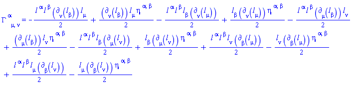

Physics:-Christoffel[`~alpha`, mu, nu] = -(1/2)*l[`~alpha`](X)*l[`~beta`](X)*Physics:-d_[nu](l[beta](X), [X])*l[mu](X)+(1/2)*Physics:-d_[nu](l[beta](X), [X])*l[mu](X)*eta[`~alpha`, `~beta`]-(1/2)*l[`~alpha`](X)*l[`~beta`](X)*l[beta](X)*Physics:-d_[nu](l[mu](X), [X])+(1/2)*l[beta](X)*Physics:-d_[nu](l[mu](X), [X])*eta[`~alpha`, `~beta`]-(1/2)*l[`~alpha`](X)*l[`~beta`](X)*Physics:-d_[mu](l[beta](X), [X])*l[nu](X)+(1/2)*Physics:-d_[mu](l[beta](X), [X])*l[nu](X)*eta[`~alpha`, `~beta`]-(1/2)*l[`~alpha`](X)*l[`~beta`](X)*l[beta](X)*Physics:-d_[mu](l[nu](X), [X])+(1/2)*l[beta](X)*Physics:-d_[mu](l[nu](X), [X])*eta[`~alpha`, `~beta`]+(1/2)*l[`~alpha`](X)*l[`~beta`](X)*l[nu](X)*Physics:-d_[beta](l[mu](X), [X])-(1/2)*l[nu](X)*Physics:-d_[beta](l[mu](X), [X])*eta[`~alpha`, `~beta`]+(1/2)*l[`~alpha`](X)*l[`~beta`](X)*l[mu](X)*Physics:-d_[beta](l[nu](X), [X])-(1/2)*l[mu](X)*Physics:-d_[beta](l[nu](X), [X])*eta[`~alpha`, `~beta`]
SubstituteTensor({Physics:-`*`(eta[`~mu`, `~nu`], d_[gamma](l[nu](X))) = d_[gamma](l[`~mu`](X)), Physics:-`*`(l[nu](X), eta[`~mu`, `~nu`]) = l[`~mu`](X), Physics:-`*`(l[`~mu`](X), l[mu](X)) = 0}, Physics:-Christoffel[`~alpha`, mu, nu] = -(1/2)*l[`~alpha`](X)*l[`~beta`](X)*Physics:-d_[nu](l[beta](X), [X])*l[mu](X)+(1/2)*Physics:-d_[nu](l[beta](X), [X])*l[mu](X)*eta[`~alpha`, `~beta`]-(1/2)*l[`~alpha`](X)*l[`~beta`](X)*l[beta](X)*Physics:-d_[nu](l[mu](X), [X])+(1/2)*l[beta](X)*Physics:-d_[nu](l[mu](X), [X])*eta[`~alpha`, `~beta`]-(1/2)*l[`~alpha`](X)*l[`~beta`](X)*Physics:-d_[mu](l[beta](X), [X])*l[nu](X)+(1/2)*Physics:-d_[mu](l[beta](X), [X])*l[nu](X)*eta[`~alpha`, `~beta`]-(1/2)*l[`~alpha`](X)*l[`~beta`](X)*l[beta](X)*Physics:-d_[mu](l[nu](X), [X])+(1/2)*l[beta](X)*Physics:-d_[mu](l[nu](X), [X])*eta[`~alpha`, `~beta`]+(1/2)*l[`~alpha`](X)*l[`~beta`](X)*l[nu](X)*Physics:-d_[beta](l[mu](X), [X])-(1/2)*l[nu](X)*Physics:-d_[beta](l[mu](X), [X])*eta[`~alpha`, `~beta`]+(1/2)*l[`~alpha`](X)*l[`~beta`](X)*l[mu](X)*Physics:-d_[beta](l[nu](X), [X])-(1/2)*l[mu](X)*Physics:-d_[beta](l[nu](X), [X])*eta[`~alpha`, `~beta`])

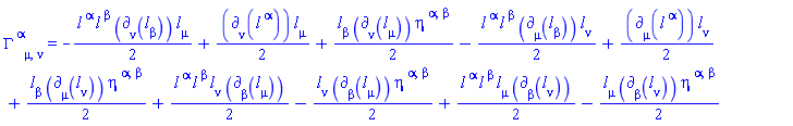

Physics:-Christoffel[`~alpha`, mu, nu] = -(1/2)*l[`~alpha`](X)*l[`~beta`](X)*Physics:-d_[nu](l[beta](X), [X])*l[mu](X)+(1/2)*Physics:-d_[nu](l[`~alpha`](X), [X])*l[mu](X)+(1/2)*l[beta](X)*Physics:-d_[nu](l[mu](X), [X])*eta[`~alpha`, `~beta`]-(1/2)*l[`~alpha`](X)*l[`~beta`](X)*Physics:-d_[mu](l[beta](X), [X])*l[nu](X)+(1/2)*Physics:-d_[mu](l[`~alpha`](X), [X])*l[nu](X)+(1/2)*l[beta](X)*Physics:-d_[mu](l[nu](X), [X])*eta[`~alpha`, `~beta`]+(1/2)*l[`~alpha`](X)*l[`~beta`](X)*l[nu](X)*Physics:-d_[beta](l[mu](X), [X])-(1/2)*l[nu](X)*Physics:-d_[beta](l[mu](X), [X])*eta[`~alpha`, `~beta`]+(1/2)*l[`~alpha`](X)*l[`~beta`](X)*l[mu](X)*Physics:-d_[beta](l[nu](X), [X])-(1/2)*l[mu](X)*Physics:-d_[beta](l[nu](X), [X])*eta[`~alpha`, `~beta`]

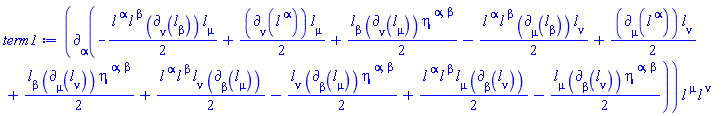

term1 := SubstituteTensor(Physics:-Christoffel[`~alpha`, mu, nu] = -(1/2)*l[`~alpha`](X)*l[`~beta`](X)*Physics:-d_[nu](l[beta](X), [X])*l[mu](X)+(1/2)*Physics:-d_[nu](l[`~alpha`](X), [X])*l[mu](X)+(1/2)*l[beta](X)*Physics:-d_[nu](l[mu](X), [X])*eta[`~alpha`, `~beta`]-(1/2)*l[`~alpha`](X)*l[`~beta`](X)*Physics:-d_[mu](l[beta](X), [X])*l[nu](X)+(1/2)*Physics:-d_[mu](l[`~alpha`](X), [X])*l[nu](X)+(1/2)*l[beta](X)*Physics:-d_[mu](l[nu](X), [X])*eta[`~alpha`, `~beta`]+(1/2)*l[`~alpha`](X)*l[`~beta`](X)*l[nu](X)*Physics:-d_[beta](l[mu](X), [X])-(1/2)*l[nu](X)*Physics:-d_[beta](l[mu](X), [X])*eta[`~alpha`, `~beta`]+(1/2)*l[`~alpha`](X)*l[`~beta`](X)*l[mu](X)*Physics:-d_[beta](l[nu](X), [X])-(1/2)*l[mu](X)*Physics:-d_[beta](l[nu](X), [X])*eta[`~alpha`, `~beta`], Physics:-`*`(Physics:-`*`(d_[alpha](Christoffel[`~alpha`, mu, nu]), l[`~mu`](X)), l[`~nu`](X)))
Physics:-d_[alpha](-(1/2)*l[`~alpha`](X)*l[`~beta`](X)*Physics:-d_[nu](l[beta](X), [X])*l[mu](X)+(1/2)*Physics:-d_[nu](l[`~alpha`](X), [X])*l[mu](X)+(1/2)*l[beta](X)*Physics:-d_[nu](l[mu](X), [X])*eta[`~alpha`, `~beta`]-(1/2)*l[`~alpha`](X)*l[`~beta`](X)*Physics:-d_[mu](l[beta](X), [X])*l[nu](X)+(1/2)*Physics:-d_[mu](l[`~alpha`](X), [X])*l[nu](X)+(1/2)*l[beta](X)*Physics:-d_[mu](l[nu](X), [X])*eta[`~alpha`, `~beta`]+(1/2)*l[`~alpha`](X)*l[`~beta`](X)*l[nu](X)*Physics:-d_[beta](l[mu](X), [X])-(1/2)*l[nu](X)*Physics:-d_[beta](l[mu](X), [X])*eta[`~alpha`, `~beta`]+(1/2)*l[`~alpha`](X)*l[`~beta`](X)*l[mu](X)*Physics:-d_[beta](l[nu](X), [X])-(1/2)*l[mu](X)*Physics:-d_[beta](l[nu](X), [X])*eta[`~alpha`, `~beta`], [X])*l[`~mu`](X)*l[`~nu`](X)

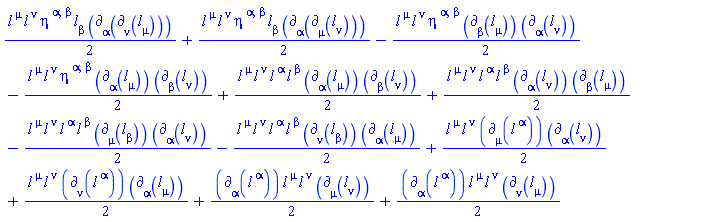

(1/2)*l[`~mu`](X)*l[`~nu`](X)*eta[`~alpha`, `~beta`]*Physics:-d_[alpha](l[beta](X), [X])*Physics:-d_[nu](l[mu](X), [X])+(1/2)*l[`~mu`](X)*l[`~nu`](X)*eta[`~alpha`, `~beta`]*l[beta](X)*Physics:-d_[alpha](Physics:-d_[nu](l[mu](X), [X]), [X])+(1/2)*l[`~mu`](X)*l[`~nu`](X)*eta[`~alpha`, `~beta`]*Physics:-d_[alpha](l[beta](X), [X])*Physics:-d_[mu](l[nu](X), [X])+(1/2)*l[`~mu`](X)*l[`~nu`](X)*eta[`~alpha`, `~beta`]*l[beta](X)*Physics:-d_[alpha](Physics:-d_[mu](l[nu](X), [X]), [X])-(1/2)*l[`~mu`](X)*l[`~nu`](X)*eta[`~alpha`, `~beta`]*Physics:-d_[alpha](Physics:-d_[beta](l[mu](X), [X]), [X])*l[nu](X)-(1/2)*l[`~mu`](X)*l[`~nu`](X)*eta[`~alpha`, `~beta`]*Physics:-d_[beta](l[mu](X), [X])*Physics:-d_[alpha](l[nu](X), [X])-(1/2)*l[`~mu`](X)*l[`~nu`](X)*eta[`~alpha`, `~beta`]*Physics:-d_[alpha](l[mu](X), [X])*Physics:-d_[beta](l[nu](X), [X])-(1/2)*l[`~mu`](X)*l[`~nu`](X)*eta[`~alpha`, `~beta`]*l[mu](X)*Physics:-d_[alpha](Physics:-d_[beta](l[nu](X), [X]), [X])+(1/2)*l[`~mu`](X)*l[`~nu`](X)*Physics:-d_[alpha](Physics:-d_[mu](l[`~alpha`](X), [X]), [X])*l[nu](X)+(1/2)*l[`~mu`](X)*l[`~nu`](X)*Physics:-d_[mu](l[`~alpha`](X), [X])*Physics:-d_[alpha](l[nu](X), [X])+(1/2)*l[`~mu`](X)*l[`~nu`](X)*Physics:-d_[alpha](Physics:-d_[nu](l[`~alpha`](X), [X]), [X])*l[mu](X)+(1/2)*l[`~mu`](X)*l[`~nu`](X)*Physics:-d_[nu](l[`~alpha`](X), [X])*Physics:-d_[alpha](l[mu](X), [X])-(1/2)*l[`~mu`](X)*l[`~nu`](X)*l[`~alpha`](X)*l[`~beta`](X)*Physics:-d_[alpha](Physics:-d_[nu](l[beta](X), [X]), [X])*l[mu](X)-(1/2)*l[`~mu`](X)*l[`~nu`](X)*l[`~alpha`](X)*l[`~beta`](X)*Physics:-d_[nu](l[beta](X), [X])*Physics:-d_[alpha](l[mu](X), [X])-(1/2)*l[`~mu`](X)*l[`~nu`](X)*Physics:-d_[alpha](l[`~alpha`](X), [X])*l[`~beta`](X)*Physics:-d_[nu](l[beta](X), [X])*l[mu](X)+(1/2)*l[`~mu`](X)*l[`~nu`](X)*Physics:-d_[alpha](l[`~alpha`](X), [X])*l[`~beta`](X)*l[mu](X)*Physics:-d_[beta](l[nu](X), [X])+(1/2)*l[`~mu`](X)*l[`~nu`](X)*l[`~alpha`](X)*Physics:-d_[alpha](l[`~beta`](X), [X])*l[mu](X)*Physics:-d_[beta](l[nu](X), [X])+(1/2)*l[`~mu`](X)*l[`~nu`](X)*l[`~alpha`](X)*l[`~beta`](X)*Physics:-d_[alpha](l[mu](X), [X])*Physics:-d_[beta](l[nu](X), [X])+(1/2)*l[`~mu`](X)*l[`~nu`](X)*l[`~alpha`](X)*l[`~beta`](X)*l[mu](X)*Physics:-d_[alpha](Physics:-d_[beta](l[nu](X), [X]), [X])+(1/2)*l[`~mu`](X)*l[`~nu`](X)*Physics:-d_[alpha](l[`~alpha`](X), [X])*l[`~beta`](X)*l[nu](X)*Physics:-d_[beta](l[mu](X), [X])+(1/2)*l[`~mu`](X)*l[`~nu`](X)*l[`~alpha`](X)*Physics:-d_[alpha](l[`~beta`](X), [X])*l[nu](X)*Physics:-d_[beta](l[mu](X), [X])+(1/2)*l[`~mu`](X)*l[`~nu`](X)*l[`~alpha`](X)*l[`~beta`](X)*Physics:-d_[alpha](l[nu](X), [X])*Physics:-d_[beta](l[mu](X), [X])+(1/2)*l[`~mu`](X)*l[`~nu`](X)*l[`~alpha`](X)*l[`~beta`](X)*l[nu](X)*Physics:-d_[alpha](Physics:-d_[beta](l[mu](X), [X]), [X])-(1/2)*l[`~mu`](X)*l[`~nu`](X)*Physics:-d_[alpha](l[`~alpha`](X), [X])*l[`~beta`](X)*Physics:-d_[mu](l[beta](X), [X])*l[nu](X)-(1/2)*l[`~mu`](X)*l[`~nu`](X)*l[`~alpha`](X)*Physics:-d_[alpha](l[`~beta`](X), [X])*Physics:-d_[mu](l[beta](X), [X])*l[nu](X)-(1/2)*l[`~mu`](X)*l[`~nu`](X)*l[`~alpha`](X)*l[`~beta`](X)*Physics:-d_[alpha](Physics:-d_[mu](l[beta](X), [X]), [X])*l[nu](X)-(1/2)*l[`~mu`](X)*l[`~nu`](X)*l[`~alpha`](X)*l[`~beta`](X)*Physics:-d_[mu](l[beta](X), [X])*Physics:-d_[alpha](l[nu](X), [X])-(1/2)*l[`~mu`](X)*l[`~nu`](X)*l[`~alpha`](X)*Physics:-d_[alpha](l[`~beta`](X), [X])*Physics:-d_[nu](l[beta](X), [X])*l[mu](X)
SubstituteTensor({Physics:-`*`(eta[`~mu`, `~nu`], d_[gamma](l[nu](X))) = d_[gamma](l[`~mu`](X)), Physics:-`*`(eta[`~mu`, `~nu`], l[nu](X)) = l[`~mu`](X), Physics:-`*`(l[`~mu`](X), l[mu](X)) = 0}, (1/2)*l[`~mu`](X)*l[`~nu`](X)*eta[`~alpha`, `~beta`]*Physics:-d_[alpha](l[beta](X), [X])*Physics:-d_[nu](l[mu](X), [X])+(1/2)*l[`~mu`](X)*l[`~nu`](X)*eta[`~alpha`, `~beta`]*l[beta](X)*Physics:-d_[alpha](Physics:-d_[nu](l[mu](X), [X]), [X])+(1/2)*l[`~mu`](X)*l[`~nu`](X)*eta[`~alpha`, `~beta`]*Physics:-d_[alpha](l[beta](X), [X])*Physics:-d_[mu](l[nu](X), [X])+(1/2)*l[`~mu`](X)*l[`~nu`](X)*eta[`~alpha`, `~beta`]*l[beta](X)*Physics:-d_[alpha](Physics:-d_[mu](l[nu](X), [X]), [X])-(1/2)*l[`~mu`](X)*l[`~nu`](X)*eta[`~alpha`, `~beta`]*Physics:-d_[alpha](Physics:-d_[beta](l[mu](X), [X]), [X])*l[nu](X)-(1/2)*l[`~mu`](X)*l[`~nu`](X)*eta[`~alpha`, `~beta`]*Physics:-d_[beta](l[mu](X), [X])*Physics:-d_[alpha](l[nu](X), [X])-(1/2)*l[`~mu`](X)*l[`~nu`](X)*eta[`~alpha`, `~beta`]*Physics:-d_[alpha](l[mu](X), [X])*Physics:-d_[beta](l[nu](X), [X])-(1/2)*l[`~mu`](X)*l[`~nu`](X)*eta[`~alpha`, `~beta`]*l[mu](X)*Physics:-d_[alpha](Physics:-d_[beta](l[nu](X), [X]), [X])+(1/2)*l[`~mu`](X)*l[`~nu`](X)*Physics:-d_[alpha](Physics:-d_[mu](l[`~alpha`](X), [X]), [X])*l[nu](X)+(1/2)*l[`~mu`](X)*l[`~nu`](X)*Physics:-d_[mu](l[`~alpha`](X), [X])*Physics:-d_[alpha](l[nu](X), [X])+(1/2)*l[`~mu`](X)*l[`~nu`](X)*Physics:-d_[alpha](Physics:-d_[nu](l[`~alpha`](X), [X]), [X])*l[mu](X)+(1/2)*l[`~mu`](X)*l[`~nu`](X)*Physics:-d_[nu](l[`~alpha`](X), [X])*Physics:-d_[alpha](l[mu](X), [X])-(1/2)*l[`~mu`](X)*l[`~nu`](X)*l[`~alpha`](X)*l[`~beta`](X)*Physics:-d_[alpha](Physics:-d_[nu](l[beta](X), [X]), [X])*l[mu](X)-(1/2)*l[`~mu`](X)*l[`~nu`](X)*l[`~alpha`](X)*l[`~beta`](X)*Physics:-d_[nu](l[beta](X), [X])*Physics:-d_[alpha](l[mu](X), [X])-(1/2)*l[`~mu`](X)*l[`~nu`](X)*Physics:-d_[alpha](l[`~alpha`](X), [X])*l[`~beta`](X)*Physics:-d_[nu](l[beta](X), [X])*l[mu](X)+(1/2)*l[`~mu`](X)*l[`~nu`](X)*Physics:-d_[alpha](l[`~alpha`](X), [X])*l[`~beta`](X)*l[mu](X)*Physics:-d_[beta](l[nu](X), [X])+(1/2)*l[`~mu`](X)*l[`~nu`](X)*l[`~alpha`](X)*Physics:-d_[alpha](l[`~beta`](X), [X])*l[mu](X)*Physics:-d_[beta](l[nu](X), [X])+(1/2)*l[`~mu`](X)*l[`~nu`](X)*l[`~alpha`](X)*l[`~beta`](X)*Physics:-d_[alpha](l[mu](X), [X])*Physics:-d_[beta](l[nu](X), [X])+(1/2)*l[`~mu`](X)*l[`~nu`](X)*l[`~alpha`](X)*l[`~beta`](X)*l[mu](X)*Physics:-d_[alpha](Physics:-d_[beta](l[nu](X), [X]), [X])+(1/2)*l[`~mu`](X)*l[`~nu`](X)*Physics:-d_[alpha](l[`~alpha`](X), [X])*l[`~beta`](X)*l[nu](X)*Physics:-d_[beta](l[mu](X), [X])+(1/2)*l[`~mu`](X)*l[`~nu`](X)*l[`~alpha`](X)*Physics:-d_[alpha](l[`~beta`](X), [X])*l[nu](X)*Physics:-d_[beta](l[mu](X), [X])+(1/2)*l[`~mu`](X)*l[`~nu`](X)*l[`~alpha`](X)*l[`~beta`](X)*Physics:-d_[alpha](l[nu](X), [X])*Physics:-d_[beta](l[mu](X), [X])+(1/2)*l[`~mu`](X)*l[`~nu`](X)*l[`~alpha`](X)*l[`~beta`](X)*l[nu](X)*Physics:-d_[alpha](Physics:-d_[beta](l[mu](X), [X]), [X])-(1/2)*l[`~mu`](X)*l[`~nu`](X)*Physics:-d_[alpha](l[`~alpha`](X), [X])*l[`~beta`](X)*Physics:-d_[mu](l[beta](X), [X])*l[nu](X)-(1/2)*l[`~mu`](X)*l[`~nu`](X)*l[`~alpha`](X)*Physics:-d_[alpha](l[`~beta`](X), [X])*Physics:-d_[mu](l[beta](X), [X])*l[nu](X)-(1/2)*l[`~mu`](X)*l[`~nu`](X)*l[`~alpha`](X)*l[`~beta`](X)*Physics:-d_[alpha](Physics:-d_[mu](l[beta](X), [X]), [X])*l[nu](X)-(1/2)*l[`~mu`](X)*l[`~nu`](X)*l[`~alpha`](X)*l[`~beta`](X)*Physics:-d_[mu](l[beta](X), [X])*Physics:-d_[alpha](l[nu](X), [X])-(1/2)*l[`~mu`](X)*l[`~nu`](X)*l[`~alpha`](X)*Physics:-d_[alpha](l[`~beta`](X), [X])*Physics:-d_[nu](l[beta](X), [X])*l[mu](X))
(1/2)*l[`~mu`](X)*l[`~nu`](X)*eta[`~alpha`, `~beta`]*l[beta](X)*Physics:-d_[alpha](Physics:-d_[nu](l[mu](X), [X]), [X])+(1/2)*l[`~mu`](X)*l[`~nu`](X)*eta[`~alpha`, `~beta`]*l[beta](X)*Physics:-d_[alpha](Physics:-d_[mu](l[nu](X), [X]), [X])-(1/2)*l[`~mu`](X)*l[`~nu`](X)*eta[`~alpha`, `~beta`]*Physics:-d_[beta](l[mu](X), [X])*Physics:-d_[alpha](l[nu](X), [X])-(1/2)*l[`~mu`](X)*l[`~nu`](X)*eta[`~alpha`, `~beta`]*Physics:-d_[alpha](l[mu](X), [X])*Physics:-d_[beta](l[nu](X), [X])+(1/2)*l[`~mu`](X)*l[`~nu`](X)*l[`~alpha`](X)*l[`~beta`](X)*Physics:-d_[alpha](l[mu](X), [X])*Physics:-d_[beta](l[nu](X), [X])+(1/2)*l[`~mu`](X)*l[`~nu`](X)*l[`~alpha`](X)*l[`~beta`](X)*Physics:-d_[alpha](l[nu](X), [X])*Physics:-d_[beta](l[mu](X), [X])-(1/2)*l[`~mu`](X)*l[`~nu`](X)*l[`~alpha`](X)*l[`~beta`](X)*Physics:-d_[mu](l[beta](X), [X])*Physics:-d_[alpha](l[nu](X), [X])-(1/2)*l[`~mu`](X)*l[`~nu`](X)*l[`~alpha`](X)*l[`~beta`](X)*Physics:-d_[nu](l[beta](X), [X])*Physics:-d_[alpha](l[mu](X), [X])+(1/2)*l[`~mu`](X)*l[`~nu`](X)*Physics:-d_[mu](l[`~alpha`](X), [X])*Physics:-d_[alpha](l[nu](X), [X])+(1/2)*l[`~mu`](X)*l[`~nu`](X)*Physics:-d_[nu](l[`~alpha`](X), [X])*Physics:-d_[alpha](l[mu](X), [X])+(1/2)*Physics:-d_[alpha](l[`~alpha`](X), [X])*l[`~mu`](X)*l[`~nu`](X)*Physics:-d_[mu](l[nu](X), [X])+(1/2)*Physics:-d_[alpha](l[`~alpha`](X), [X])*l[`~mu`](X)*l[`~nu`](X)*Physics:-d_[nu](l[mu](X), [X])
