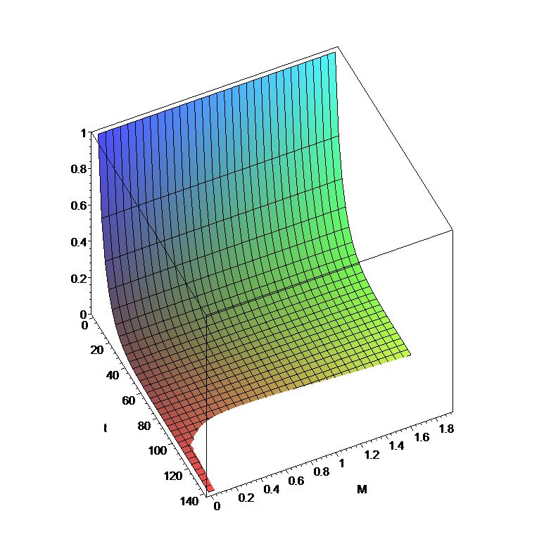

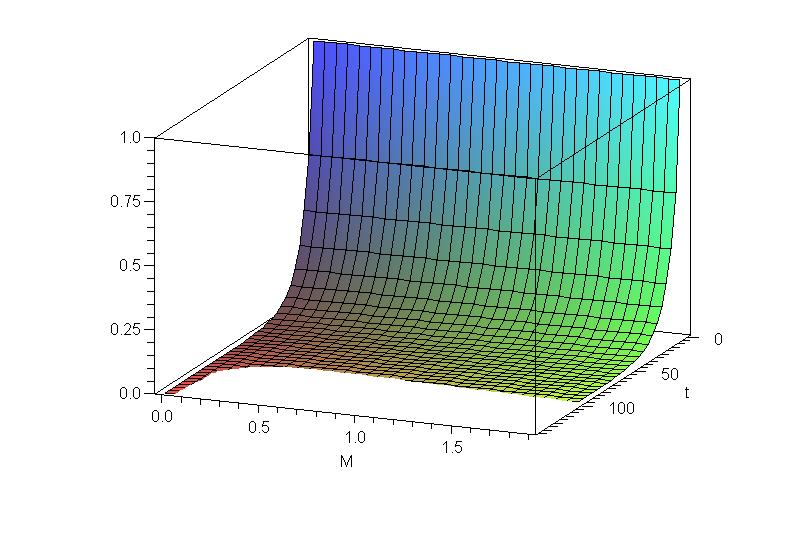

The first plot is the correct one with maple 12. The second is produced with maple 14. All good.

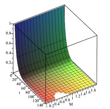

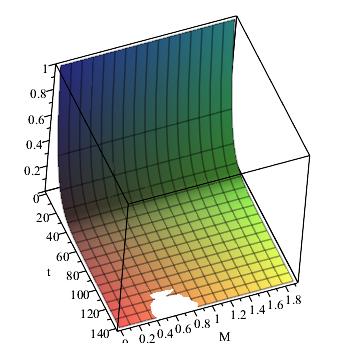

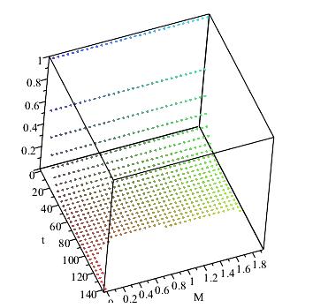

The third and the second are produced with different orientations of the same plot (Maple 17). Wrong display of data and change of image after rotation. The final one is again from Maple 17 but with style=points. It is in is in full agreement with the first two plots.
Conclusion: Style=surface and line doesnt produce the correct plot, while style=point does. As for hardware acceleration, i unticked it with no results.
