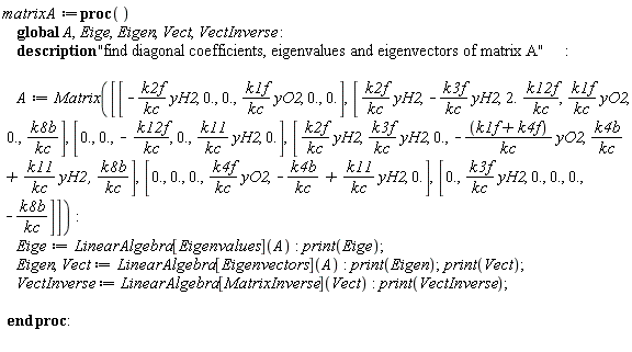

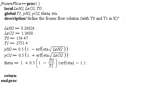

frozenFlow := proc () local LeH2, LeO2, T0; global T1, yH2, yO2, theta, eta; description "define the frozen flow solution (with T0 and T1 in K)"; LeH2 := .26826; LeO2 := 1.0688; T0 := 154.47; T1 := 2751.4; yH2 := .5*(1.-erf(eta*sqrt(LeH2))); yO2 := .5*(1.+erf(eta*sqrt(LeO2))); theta := 1.+.5*(1.-T0/T1)*(erf(eta)-1.); return  end proc:
rateCoefficients := proc () local R; global k1f, k2f, k3f, k4f, k4b, k6b, k8b, k11, k12f, kc; description "define rate coefficients (with R in kJ.K-1.mol-1 and E in kJ.mol-1)"; R := 0.8314e-2; k1f := 0.352e17*(T1*theta)^((-1)*.7)*exp((-1)*71.42/((R*T1*theta))); k2f := 0.506e5*(T1*theta)^2.67*exp((-1)*26.32/((R*T1*theta))); k3f := 0.117e10*(T1*theta)^1.3*exp((-1)*15.21/((R*T1*theta))); k4f := 0.575e20*(T1*theta)^((-1)*1.4)*exp((-1)*0./((R*T1*theta))); k4b := 0.465e13*(T1*theta)^.44*exp((-1)*0./((R*T1*theta))); k6b := 0.269e13*(T1*theta)^.36*exp((-1)*231.86/((R*T1*theta))); k8b := 0.103e24*(T1*theta)^((-1)*1.75)*exp((-1)*496.14/((R*T1*theta))); k11 := 0.162e12*(T1*theta)^.61*exp((-1)*100.14/((R*T1*theta))); k12f := 0.815e24*(T1*theta)^((-1)*1.9)*exp((-1)*207.62/((R*T1*theta))); kc := 0.4080e10*exp((-1)*0.1088e5/((T1*theta))); return  end proc:
matrixA := proc () global A, Eige, Eigen, Vect, VectInverse; description "find diagonal coefficients, eigenvalues and eigenvectors of matrix A"; A := Matrix([[-k2f*yH2/kc, 0., 0., k1f*yO2/kc, 0., 0.], [k2f*yH2/kc, -k3f*yH2/kc, 2.*(k12f/kc), k1f*yO2/kc, 0., k8b/kc], [0., 0., -k12f/kc, 0., k11*yH2/kc, 0.], [k2f*yH2/kc, k3f*yH2/kc, 0., -(k1f+k4f)*yO2/kc, k4b/kc+k11*yH2/kc, k8b/kc], [0., 0., 0., k4f*yO2/kc, -k4b/kc+k11*yH2/kc, 0.], [0., k3f*yH2/kc, 0., 0., 0., -k8b/kc]]); Eige := LinearAlgebra[Eigenvalues](A); print(Eige); Eigen, Vect := LinearAlgebra[Eigenvectors](A); print(Eigen); print(Vect); VectInverse := LinearAlgebra[MatrixInverse](Vect); print(VectInverse) end proc:
frozenFlow(); rateCoefficients(); matrixA()
Error, (in content/polynom) general case of floats not handled
