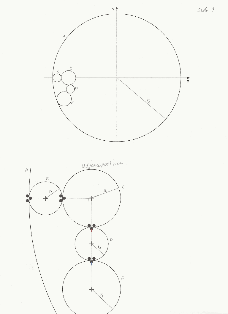

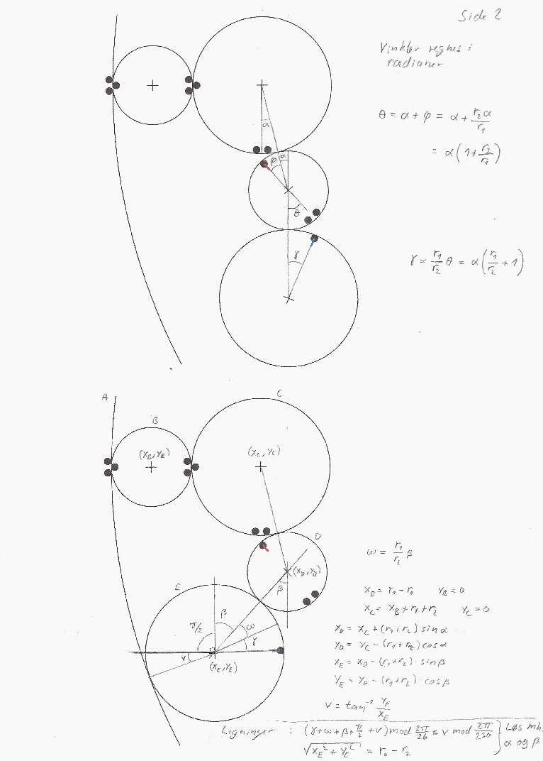

I am working on getting the right angles for my gears to fit together. My problem is that my fsolve (at the bottom of the page) does not seem to work. Can you help me by telling me what I am doing wrong.

`ϕ` := r__2*alpha/r__1; theta := simplify(alpha+`ϕ`); gamma := simplify(r__1*theta/r__2); omega := r__1*beta/r__2
alpha*(r__1+r__2)/r__1
alpha*(r__1+r__2)/r__2
r__1*beta/r__2
x__B := r__1-r__0; y__B := 0; x__C := x__B+r__1+r__2; y__C := 0
2*r__1-r__0+r__2
x__D := x__C+(r__1+r__2)*sin(alpha); y__D := y__C-(r__1+r__2)*cos(alpha)
2*r__1-r__0+r__2+(r__1+r__2)*sin(alpha)
x__E := x__D-(r__1+r__2)*sin(beta); y__E := y__D-(r__1+r__2)*cos(beta)
2*r__1-r__0+r__2+(r__1+r__2)*sin(alpha)-(r__1+r__2)*sin(beta)
-(r__1+r__2)*cos(alpha)-(r__1+r__2)*cos(beta)
v := arctan(y__E/x__E); w := gamma+omega+beta+(1/2)*Pi+v; d := sqrt(`#msub(mi("x"),mi("E"))`^2+`#msub(mi("y"),mi("E"))`^2)
arctan((-(r__1+r__2)*cos(alpha)-(r__1+r__2)*cos(beta))/(2*r__1-r__0+r__2+(r__1+r__2)*sin(alpha)-(r__1+r__2)*sin(beta)))
alpha*(r__1+r__2)/r__2+r__1*beta/r__2+beta+(1/2)*Pi+arctan((-(r__1+r__2)*cos(alpha)-(r__1+r__2)*cos(beta))/(2*r__1-r__0+r__2+(r__1+r__2)*sin(alpha)-(r__1+r__2)*sin(beta)))
(`#msub(mi("x"),mi("E"))`^2+`#msub(mi("y"),mi("E"))`^2)^(1/2)

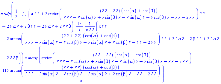

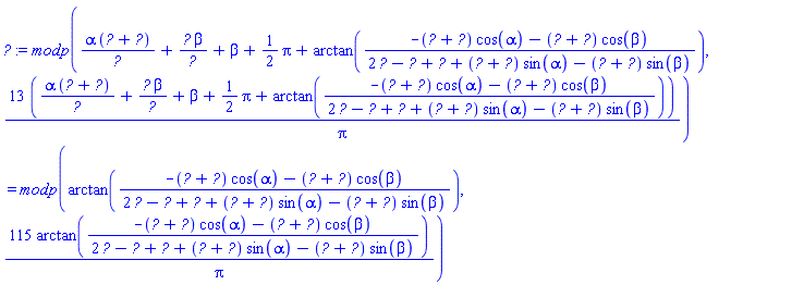

Ligning__1 := `mod`(w, w/(2*Pi*(1/26))) = `mod`(v, v/(2*Pi*(1/230))); Ligning__2 := d = r__0-r__2
modp(alpha*(r__1+r__2)/r__2+r__1*beta/r__2+beta+(1/2)*Pi+arctan((-(r__1+r__2)*cos(alpha)-(r__1+r__2)*cos(beta))/(2*r__1-r__0+r__2+(r__1+r__2)*sin(alpha)-(r__1+r__2)*sin(beta))), 13*(alpha*(r__1+r__2)/r__2+r__1*beta/r__2+beta+(1/2)*Pi+arctan((-(r__1+r__2)*cos(alpha)-(r__1+r__2)*cos(beta))/(2*r__1-r__0+r__2+(r__1+r__2)*sin(alpha)-(r__1+r__2)*sin(beta))))/Pi) = modp(arctan((-(r__1+r__2)*cos(alpha)-(r__1+r__2)*cos(beta))/(2*r__1-r__0+r__2+(r__1+r__2)*sin(alpha)-(r__1+r__2)*sin(beta))), 115*arctan((-(r__1+r__2)*cos(alpha)-(r__1+r__2)*cos(beta))/(2*r__1-r__0+r__2+(r__1+r__2)*sin(alpha)-(r__1+r__2)*sin(beta)))/Pi)
(`#msub(mi("x"),mi("E"))`^2+`#msub(mi("y"),mi("E"))`^2)^(1/2) = r__0-r__2
