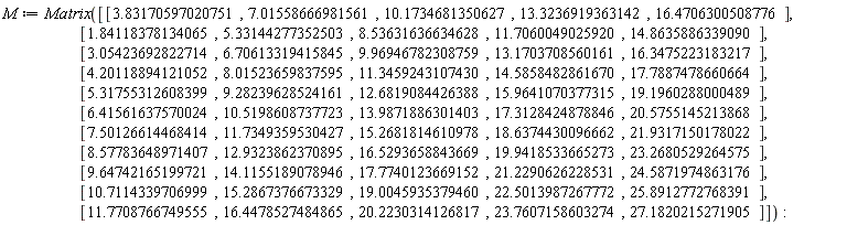

I have been trying to compute the analytical solution of two dimensional diffusion equation with zero neumann boundary conditions (no-flux) in polar coordinates using the solution in Andrei Polyanin's book. When I use 2d Gaussian function as initial condition, i cannot get the result. If I use some nicer function like f(r,phi)=1-r; there is no problem.
Any idea why this happens? or any suggestion to compute the analytical solution?

M := Matrix([[3.83170597020751, 7.01558666981561, 10.1734681350627, 13.3236919363142, 16.4706300508776], [1.84118378134065, 5.33144277352503, 8.53631636634628, 11.7060049025920, 14.8635886339090], [3.05423692822714, 6.70613319415845, 9.96946782308759, 13.1703708560161, 16.3475223183217], [4.20118894121052, 8.01523659837595, 11.3459243107430, 14.5858482861670, 17.7887478660664], [5.31755312608399, 9.28239628524161, 12.6819084426388, 15.9641070377315, 19.1960288000489], [6.41561637570024, 10.5198608737723, 13.9871886301403, 17.3128424878846, 20.5755145213868], [7.50126614468414, 11.7349359530427, 15.2681814610978, 18.6374430096662, 21.9317150178022], [8.57783648971407, 12.9323862370895, 16.5293658843669, 19.9418533665273, 23.2680529264575], [9.64742165199721, 14.1155189078946, 17.7740123669152, 21.2290626228531, 24.5871974863176], [10.7114339706999, 15.2867376673329, 19.0045935379460, 22.5013987267772, 25.8912772768391], [11.7708766749555, 16.4478527484865, 20.2230314126817, 23.7607158603274, 27.1820215271905]]):
c := 10:
A := 5:
w := proc (r, phi, t) options operator, arrow; int(int(f(xi, eta)*G(r, phi, xi, eta, t)*xi, xi = 0 .. 5), eta = 0 .. 2*Pi) end proc:
