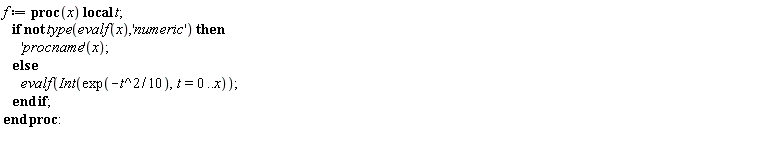

Which ODE in the worksheet, if any, provides the correct answer?
f := proc (x) local t; if not type(evalf(x), 'numeric') then ('procname')(x) else evalf(Int(exp(-(1/10)*t^2), t = 0 .. x)) end if end proc
