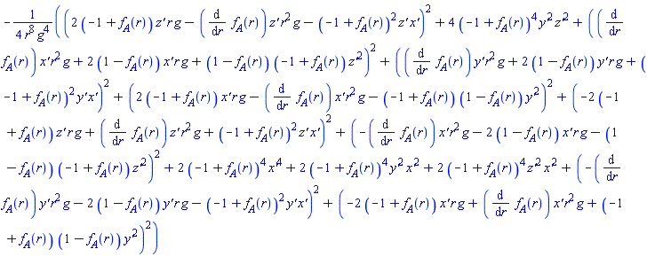

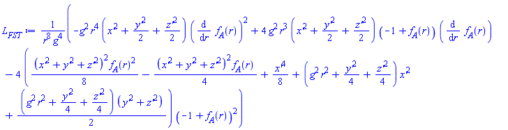

I would like to calculate the following quantity:
Where F is the SU(2) field strength tensor given by:
The gauge field V (in my code A) is defined as
where rj is the unit vector in spherical coordinates.
I tried to calculate it with maple, however, the result is not correct. I should get a scalar function, but my result still contains dependencies on x,y,z. And I really don't know why. I have defined the gauge field in (11) and the field strength tensor in (14). I could imagine that SumOverRepeatedIndices() in (16) does not work as I think (For each a = (1,2,3) I would like a summation over mu and nu). Greek letters are my spacetime indices and lowercase letters are my space indices. Do I perhaps have to use SU(2) indices instead of the space indices? But how exactly does a SU(2) index differ from a space index?

![simplify(F[])](/view.aspx?sf=238694_question/584187ed760aeb6262ae2903ca597e68.gif)
![F[mu, nu, a] = _rtable[36893489989585113204]](/view.aspx?sf=238694_question/1c8effcaf395ca691ad2f76af71d2e76.gif)
(15) |
!["-1/(4)Simplify(SumOverRepeatedIndices(F[mu,nu,a]*F[~mu,~nu,a])); "](/view.aspx?sf=238694_question/9ff9481b81f60970b168bde31e3b10b9.gif)
