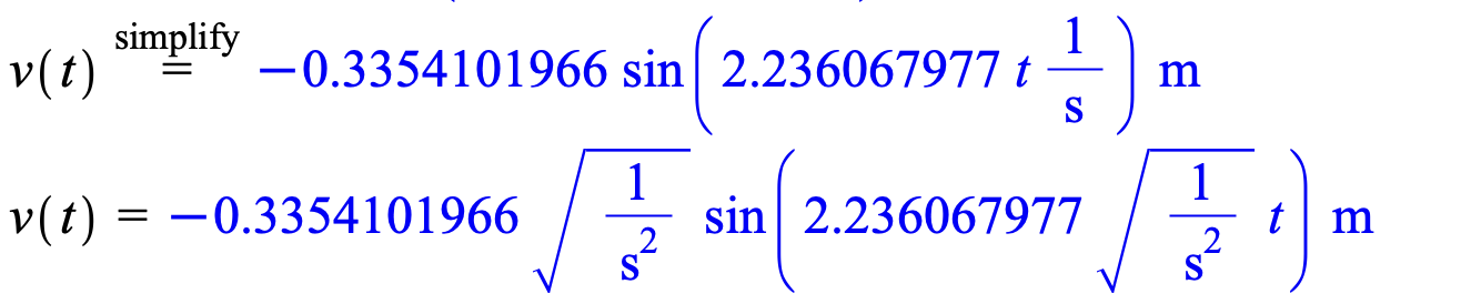

In Maple 2025 we are having problems with units.
In Maple 2024 we did not see same errors. Maple sheets working with Maple 2024 does not run in Maple 2025.
In Maple 2025, some units which are f.x. obviously 'J' is not recognices as 'J'.
In Maple 2025, part of units dissapears from expressions.
Just an example; the function v(t) below has correct units m/s, but when using simplify, the unit is changes to m
The Maple file: Error_with_units.mw
