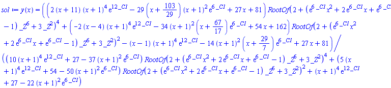

ode:=(4+2*x-y(x))*diff(y(x),x)+5+x-2*y(x) = 0;
(4+2*x-y(x))*(diff(y(x), x))+5+x-2*y(x) = 0
sol:=y(x) = ((2*(x+11)*(x+1)^4*exp(12*_C1)-29*(x+103/29)*(x+1)^2*exp(6*_C1)+27*x+81)
*RootOf(2+(exp(6*_C1)*x^2+2*exp(6*_C1)*x+exp(6*_C1)-1)*_Z^6+3*_Z^2)^4+(-2*(x-4)
*(x+1)^4*exp(12*_C1)-34*(x+1)^2*(x+67/17)*exp(6*_C1)+54*x+162)*RootOf(2+(exp(6*
_C1)*x^2+2*exp(6*_C1)*x+exp(6*_C1)-1)*_Z^6+3*_Z^2)^2-(x-1)*(x+1)^4*exp(12*_C1)-\
14*(x+1)^2*(x+29/7)*exp(6*_C1)+27*x+81)/((10*(x+1)^4*exp(12*_C1)+27-37*(x+1)^2*
exp(6*_C1))*RootOf(2+(exp(6*_C1)*x^2+2*exp(6*_C1)*x+exp(6*_C1)-1)*_Z^6+3*_Z^2)^
4+(5*(x+1)^4*exp(12*_C1)+54-50*(x+1)^2*exp(6*_C1))*RootOf(2+(exp(6*_C1)*x^2+2*
exp(6*_C1)*x+exp(6*_C1)-1)*_Z^6+3*_Z^2)^2+(x+1)^4*exp(12*_C1)+27-22*(x+1)^2*exp
(6*_C1));
y(x) = ((2*(x+11)*(x+1)^4*exp(12*_C1)-29*(x+103/29)*(x+1)^2*exp(6*_C1)+27*x+81)*RootOf(2+(exp(6*_C1)*x^2+2*exp(6*_C1)*x+exp(6*_C1)-1)*_Z^6+3*_Z^2)^4+(-2*(x-4)*(x+1)^4*exp(12*_C1)-34*(x+1)^2*(x+67/17)*exp(6*_C1)+54*x+162)*RootOf(2+(exp(6*_C1)*x^2+2*exp(6*_C1)*x+exp(6*_C1)-1)*_Z^6+3*_Z^2)^2-(x-1)*(x+1)^4*exp(12*_C1)-14*(x+1)^2*(x+29/7)*exp(6*_C1)+27*x+81)/((10*(x+1)^4*exp(12*_C1)+27-37*(x+1)^2*exp(6*_C1))*RootOf(2+(exp(6*_C1)*x^2+2*exp(6*_C1)*x+exp(6*_C1)-1)*_Z^6+3*_Z^2)^4+(5*(x+1)^4*exp(12*_C1)+54-50*(x+1)^2*exp(6*_C1))*RootOf(2+(exp(6*_C1)*x^2+2*exp(6*_C1)*x+exp(6*_C1)-1)*_Z^6+3*_Z^2)^2+(x+1)^4*exp(12*_C1)+27-22*(x+1)^2*exp(6*_C1))
