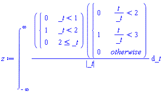

I have two random variables:  x and y.  I want to multiply them and get the resulting Probability Density Function, z.  If you look below, Example 1 works as expected.  When I try Example 2, however, I get disappointing results.
Clearly, Example 2 involves nonzero lower boundaries, which is messing me up.  Does anyone have any suggestions for Example 2?

Example 2
x := RandomVariable(Uniform(1, 2))
_R1
y := RandomVariable(Uniform(2, 3))
_R2
z := PDF(x*y, t)
int(piecewise(_t < 1, 0, _t < 2, 1, 2 <= _t, 0)*piecewise(t/_t < 2, 0, t/_t < 3, 1, 0)/abs(_t), _t = -infinity .. infinity)
