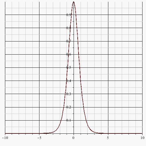

D(tanh);
plot(%)
-tanh^2+1

Let's try integrating the identical expression sech^2
tanh(x)
is((sech^2=1-tanh^2)(x));# check identity
true
int(sech(x)^2,x);# what I expected
tanh(x)
