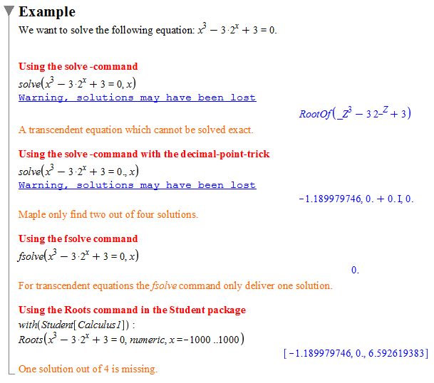

To start the discussion I have tried solving a transcendental equation using four different methods and none of them succeed in delivering all four solutions in one step.
Method 1: Using the solve command
Method 2: Using the solve command with the decimal-point-trick (One of numbers in the equation is written with a decimal point to force Maple to "think" in numeric terms)
Method 3: Using the fsolve command
Method 4: Using the Roots command in a student package.
