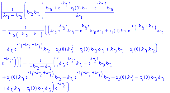

ErTime := abs(KLst*(x1+x2)-k[2]*x2)
abs(k[2]*k[1]*((k[0]+exp(-k[1]*t)*x[1](0)*k[1]-exp(-k[1]*t)*k[0])/k[1]-(k[2]*exp(k[2]*t)*k[0]-exp(k[2]*t)*k[0]*k[1]+x[1](0)*k[1]*exp(-t*(-k[2]+k[1]))*k[2]-k[0]*exp(-t*(-k[2]+k[1]))*k[2]+x[2](0)*k[2]^2-x[2](0)*k[2]*k[1]+k[0]*k[1]-x[1](0)*k[1]*k[2])*exp(-k[2]*t)/(k[2]*(-k[2]+k[1])))/(k[1]+k[2])+(k[2]*exp(k[2]*t)*k[0]-exp(k[2]*t)*k[0]*k[1]+x[1](0)*k[1]*exp(-t*(-k[2]+k[1]))*k[2]-k[0]*exp(-t*(-k[2]+k[1]))*k[2]+x[2](0)*k[2]^2-x[2](0)*k[2]*k[1]+k[0]*k[1]-x[1](0)*k[1]*k[2])*exp(-k[2]*t)/(-k[2]+k[1]))

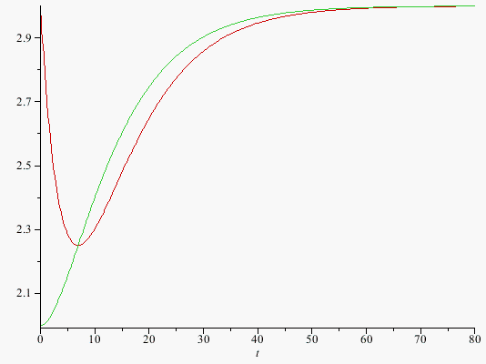

The plot of the two curves (exact and symbolic) we are determining the error of:
plot([subs([k[0] = 3, k[1] = .2, k[2] = .1, x[1](0) = 0, x[2](0) = 30], k[2]*x2), subs([k[0] = 3, k[1] = .2, k[2] = .1, x[1](0) = 0, x[2](0) = 30], KLst*(x1+x2))], t = 0 .. 80)

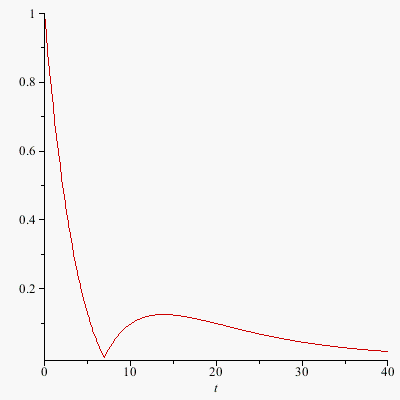

The plot of the absolute value of the time dependent error:
  plot(subs([k[0] = 3, k[1] = .2, k[2] = .1, x[1](0) = 0, x[2](0) = 30], ErTime), t = 0 .. 40)

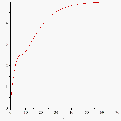

The plot of the area under the curve of the previous plot:
plot(int(subs([k[0] = 3, k[1] = .2, k[2] = .1, x[1](0) = 0, x[2](0) = 30], ErTime), t), t = 0 .. 70)
