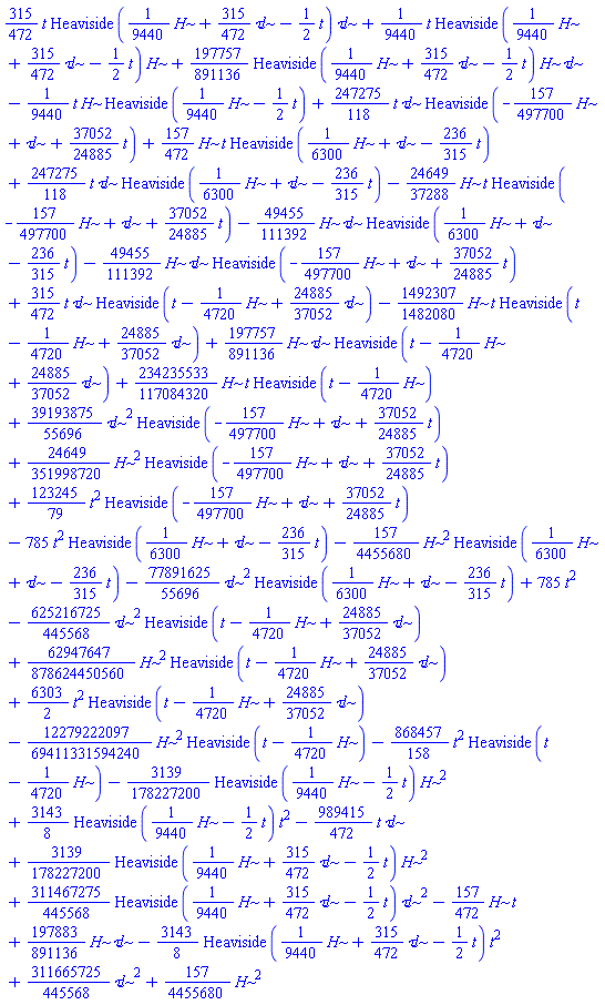

combine(u1test-u2test)
(315/472)*t*Heaviside((1/9440)*H+(315/472)*`&tau;l`-(1/2)*t)*`&tau;l`+(1/9440)*t*Heaviside((1/9440)*H+(315/472)*`&tau;l`-(1/2)*t)*H+(197757/891136)*Heaviside((1/9440)*H+(315/472)*`&tau;l`-(1/2)*t)*H*`&tau;l`-(1/9440)*t*H*Heaviside((1/9440)*H-(1/2)*t)+(247275/118)*t*`&tau;l`*Heaviside(-(157/497700)*H+`&tau;l`+(37052/24885)*t)+(157/472)*H*t*Heaviside((1/6300)*H+`&tau;l`-(236/315)*t)+(247275/118)*t*`&tau;l`*Heaviside((1/6300)*H+`&tau;l`-(236/315)*t)-(24649/37288)*H*t*Heaviside(-(157/497700)*H+`&tau;l`+(37052/24885)*t)-(49455/111392)*H*`&tau;l`*Heaviside((1/6300)*H+`&tau;l`-(236/315)*t)-(49455/111392)*H*`&tau;l`*Heaviside(-(157/497700)*H+`&tau;l`+(37052/24885)*t)+(315/472)*t*`&tau;l`*Heaviside(t-(1/4720)*H+(24885/37052)*`&tau;l`)-(1492307/1482080)*H*t*Heaviside(t-(1/4720)*H+(24885/37052)*`&tau;l`)+(197757/891136)*H*`&tau;l`*Heaviside(t-(1/4720)*H+(24885/37052)*`&tau;l`)+(234235533/117084320)*H*t*Heaviside(t-(1/4720)*H)+(39193875/55696)*`&tau;l`^2*Heaviside(-(157/497700)*H+`&tau;l`+(37052/24885)*t)+(24649/351998720)*H^2*Heaviside(-(157/497700)*H+`&tau;l`+(37052/24885)*t)+(123245/79)*t^2*Heaviside(-(157/497700)*H+`&tau;l`+(37052/24885)*t)-785*t^2*Heaviside((1/6300)*H+`&tau;l`-(236/315)*t)-(157/4455680)*H^2*Heaviside((1/6300)*H+`&tau;l`-(236/315)*t)-(77891625/55696)*`&tau;l`^2*Heaviside((1/6300)*H+`&tau;l`-(236/315)*t)+785*t^2-(625216725/445568)*`&tau;l`^2*Heaviside(t-(1/4720)*H+(24885/37052)*`&tau;l`)+(62947647/878624450560)*H^2*Heaviside(t-(1/4720)*H+(24885/37052)*`&tau;l`)+(6303/2)*t^2*Heaviside(t-(1/4720)*H+(24885/37052)*`&tau;l`)-(12279222097/69411331594240)*H^2*Heaviside(t-(1/4720)*H)-(868457/158)*t^2*Heaviside(t-(1/4720)*H)-(3139/178227200)*Heaviside((1/9440)*H-(1/2)*t)*H^2+(3143/8)*Heaviside((1/9440)*H-(1/2)*t)*t^2-(989415/472)*t*`&tau;l`+(3139/178227200)*Heaviside((1/9440)*H+(315/472)*`&tau;l`-(1/2)*t)*H^2+(311467275/445568)*Heaviside((1/9440)*H+(315/472)*`&tau;l`-(1/2)*t)*`&tau;l`^2-(157/472)*H*t+(197883/891136)*H*`&tau;l`-(3143/8)*Heaviside((1/9440)*H+(315/472)*`&tau;l`-(1/2)*t)*t^2+(311665725/445568)*`&tau;l`^2+(157/4455680)*H^2

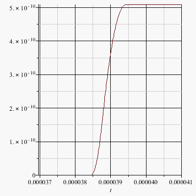

uplot1 := subs([H = .183, `&tau;l` = 0.492e-6, `&tau;t` = 0.2e-5, omega = 2*Pi*0.715e7], u1test):

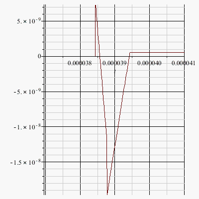

uplot2 := subs([H = .183, `&tau;l` = 0.492e-6, `&tau;t` = 0.2e-5, omega = 2*Pi*0.715e7], u2test):
plot(uplot1, t = 0.37e-4 .. 0.41e-4)
plot(uplot2, t = 0.37e-4 .. 0.41e-4)
