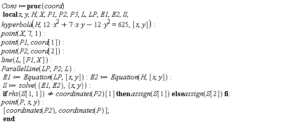

restart; with(geometry)
Cons := proc (coord) local x, y, H, X, P1, P2, P3, L, LP, E1, E2, S; hyperbola(H, 12*x^2+7*x*y-12*y^2 = 625, [x, y]); point(X, 7, 1); point(P1, coord[1]); point(P2, coord[2]); line(L, [P1, X]); ParallelLine(LP, P2, L); E1 := Equation(LP, [x, y]); E2 := Equation(H, [x, y]); S := solve({E1, E2}, {x, y}); if rhs(S[1, 1]) <> coordinates(P2)[1] then assign(S[1]) else assign(S[2]) end if; point(P, x, y); [coordinates(P2), coordinates(P)] end proc:
Coord := [[13, 61/4], [-43/6, -4]];
Cons(Coord);
[[-43/6, -4], [-19/2, -229/24]]

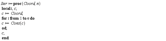

Iter := proc (Coord, n) local i, c; c := Coord; for i to n do c := Cons(c) end do; c end proc:
st := time():
183.347
st := time():
.546
