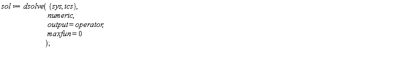

in this code count.mw  i can get the value of solution only by typing sol(t), how to get the value of q(t) directly?

sol := dsolve({ics, sys}, numeric, output = operator, maxfun = 0)

sol(0)
[t = HFloat(0.0), p(0) = HFloat(2.0), q(0) = HFloat(1.0)]
"how to get q(0) directly"?""
