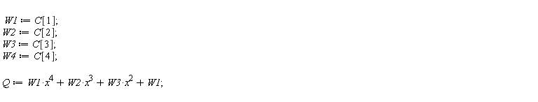

Please see attached code. (Of course simplified, not my actual code.)
It starts with a random matrix and a solution vector for the equation system.
The system is solved and its coefficients transfered to an equation.
However every time I hit "Enter" on the LinearSolve command, the name of the _t4[1] variable changes.
Is there a way to keep getting the same variable name? How do you work with this?
