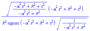

Since R and alpha are implicitly assumed real by R>0 and alpha>0, x must be real as well. However simplify does not deduce this form the assumptions:
((-alpha^2*x^2+R^2+x^2)/(-alpha^2*x^2+R^2))^(1/2)*(-alpha^2*x^2+R^2+x^2)/(R^2*signum(-alpha^2*x^2+R^2+x^2)*(1/(-alpha^2*x^2+R^2))^(1/2))
