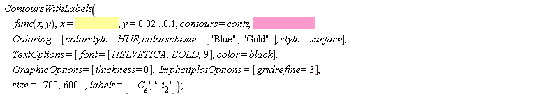

ContoursWithLabels:= proc(
ContoursWithLabels(func(x, y), x = 0.3e-1 .. .15, y = 0.2e-1 .. .1, contours = conts, decplaces = 4, Coloring = [colorstyle = HUE, colorscheme = ["Blue", "Gold"], style = surface], TextOptions = [font = [HELVETICA, BOLD, 9], color = black], GraphicOptions = [thickness = 0], ImplicitplotOptions = [gridrefine = 3], size = [700, 600], labels = [':-C__e', ':-i__2'])
