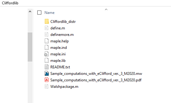

This is a screen shot of what in in the library folder. It is a older type .lib package
This is what is in the .ini file
#savelibname:="C:\\Maple2020/Cliffordlib":
#libname:=savelibname,libname:
savelibname:="C:\\Users\Ronan\Maple\toolbox\Cliffordlib":
filepathname:=cat(savelibname,"/","define.m"):
read filepathname:
filepathname:=cat(savelibname,"/","definemore.m"):
read filepathname:
read(cat(savelibname,"/","Walshpackage.m"));
