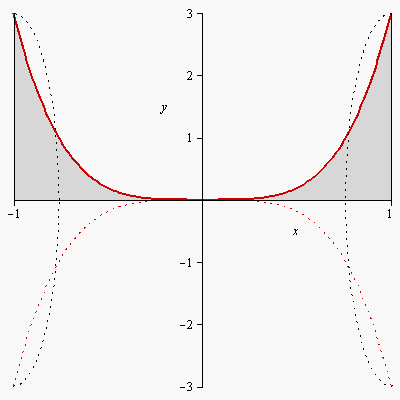

Find the volume of the solid generated by revolving the region bounded by the x-axis, the curve y=3, and the lines x=1 and x=-1 about (a) the x-axis; (b) the y-axis; (c) the line x=1; (d) the line y=3.
(a) 2π (b)π (c)12π/5 (d)26π/5
(a) Disc Method

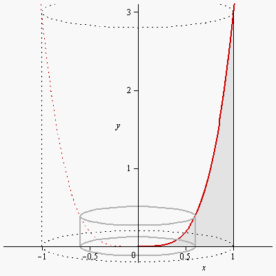

(b) Shell Method

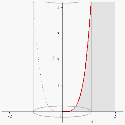

(c) Shell Method
(d) Washer method
outer radius x=3 inner radius x=3-3x^4
Have a clue how to do part d as horizontal disks I assume using the plots above?
