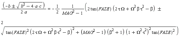

See attached.  I have stared at this long enough to the point I need some FRESH eyes on this.  Why does MAPLE return FALSE on the last 2 statements
a := MAG^2-1; 1; b := 2*tan(FAZE)*(2*tau*Omega+Omega^2*beta*tau^2-beta); 1; c := -(beta^2+1)*(1+Omega^2*tau^2)^2*tan(FAZE)^2

-`&+-`(b, sqrt(b^2-4*a*c))/(2*a) = (-2*tan(FAZE)*`&+-`(2*tau*Omega+Omega^2*beta*tau^2-beta, sqrt(4*tan(FAZE)^2*(MAG^2*(beta^2+1)*(1+Omega^2*tau^2)^2-(Omega^2*tau^2-2*beta*Omega*tau-1)^2))))*(1/(2*(MAG^2-1)))
(->)false(->)false(->)false
(->)false

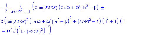

-(1/2)*`&+-`(2*tan(FAZE)*(2*tau*Omega+Omega^2*beta*tau^2-beta), 2*(tan(FAZE)^2*(2*tau*Omega+Omega^2*beta*tau^2-beta)^2+(MAG^2-1)*(beta^2+1)*(1+Omega^2*tau^2)^2*tan(FAZE)^2)^(1/2))/(MAG^2-1)
-`&+-`(b, sqrt(b^2-4*a*c))/(2*a) = -1/2*(2*tan(FAZE)*`&+-`(2*tau*Omega+Omega^2*beta*tau^2-beta, 2)*sqrt(tan(FAZE)^2*(2*tau*Omega+Omega^2*beta*tau^2-beta)^2+(MAG^2-1)*(beta^2+1)*(1+Omega^2*tau^2)^2*tan(FAZE)^2)/(MAG^2-1))
(->)false``
