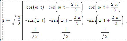

Question: How to simplify the following complex matrix product?
T := Typesetting[delayDotProduct](sqrt(2/3), Matrix(3, 3, {(1, 1) = cos(omega*t), (1, 2) = cos(omega*t-(2/3)*Pi), (1, 3) = cos(omega*t+(2/3)*Pi), (2, 1) = -sin(omega*t), (2, 2) = -sin(omega*t-(2/3)*Pi), (2, 3) = -sin(omega*t+(2/3)*Pi), (3, 1) = 1/sqrt(2), (3, 2) = 1/sqrt(2), (3, 3) = 1/sqrt(2)}), true)
To show it clearly,T is shown as left fig.
q:=T*d(transpose(T))/dt
I know the simplified result of "q" is shown as right fig.
but I don't know how to get this result in minimum number of steps in Maple?
