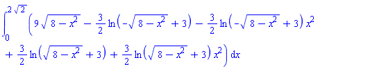

int(9*(8-x^2)^(1/2)-(3/2)*ln(-(8-x^2)^(1/2)+3)-(3/2)*ln(-(8-x^2)^(1/2)+3)*x^2+(3/2)*ln((8-x^2)^(1/2)+3)+(3/2)*ln((8-x^2)^(1/2)+3)*x^2, x = 0 .. 2*2^(1/2))
int(sqrt(VectorCalculus:-`+`(VectorCalculus:-`+`(1, x^2), y^2)), [x, y, z] = Region(0 .. VectorCalculus:-`*`(2, sqrt(2)), VectorCalculus:-`-`(sqrt(VectorCalculus:-`+`(8, VectorCalculus:-`-`(x^2)))) .. sqrt(VectorCalculus:-`+`(8, VectorCalculus:-`-`(x^2))), -1 .. 2))
