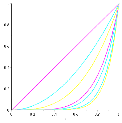

N := 10: # number of plots to draw
# Attempt at Recoloring:
p := [ seq( plot(x^i, x=0..1), i = 1..N ) ] :
plots:-display(p) ;
plots:-display( recolor~( p, colorlist[1..N]) ) ;

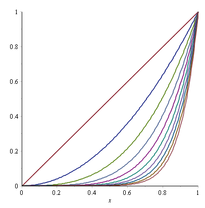

# Expected Output
p := [ seq( plot(x^i, x=0..1, 'color' = colorlist[i]), i = 1..N ) ] :
plots:-display(p) ;
