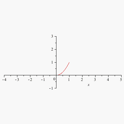

I wrote a toy file that plots a simple curve. I'll upload it and provide a link to it. If you execute the code and click on the image, you'll see that it is a square with a lot of empty space.
Nov122013.mw
p1:=plot(x^2,x=0..1,scaling=constrained,view=[-4..5,-1..3]):
