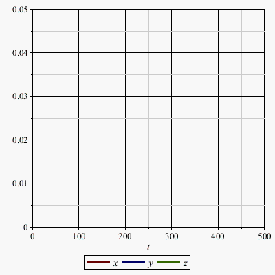

Question: How do i solve this laplace problem???
What´s the error here??????

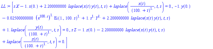

LL := subs({laplace(x(t), t, s) = X, laplace(y(t), t, s) = Y, laplace(z(t), t, s) = Z}, [La[1], La[2], La[3]]);
[s*X-1.*x(0.)+2.200000000*laplace(x(t)*y(t), t, s)+laplace(x(t)/(100.+t)^1., t, s) = 0., -1.*y(0.)-0.2500000000e-1*(exp(100.*s))^1.*Ei(1., 100.*s)^1.+1.*s^1.*Y^1.+2.200000000*laplace(x(t)*y(t), t, s)+1.*laplace(y(t)/(100.+t)^1., t, s) = 0., s*Z-1.*z(0.)-2.200000000*laplace(x(t)*y(t), t, s)+laplace(z(t)/(100.+t)^1., t, s) = 0.]

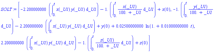

SOLT := map(invlaplace, [X, Y, Z], s, t);
[-2.200000000*(int(x(_U1)*y(_U1), _U1 = 0. .. t))-1.*(int(x(_U1)/(100.+_U1), _U1 = 0. .. t))+x(0), -1.*(int(y(_U1)/(100.+_U1), _U1 = 0. .. t))-2.200000000*(int(x(_U1)*y(_U1), _U1 = 0. .. t))+y(0)+0.2500000000e-1*ln(1.+0.1000000000e-1*t), 2.200000000*(int(x(_U1)*y(_U1), _U1 = 0. .. t))-1.*(int(z(_U1)/(100.+_U1), _U1 = 0. .. t))+z(0)]

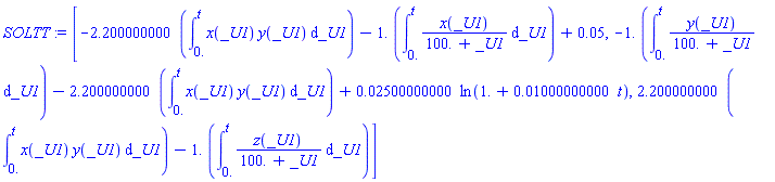

SOLTT := evalf(subs({x(0) = 0.5e-1, y(0) = 0, z(0) = 0}, SOLT));
[-2.200000000*(int(x(_U1)*y(_U1), _U1 = 0. .. t))-1.*(int(x(_U1)/(100.+_U1), _U1 = 0. .. t))+0.5e-1, -1.*(int(y(_U1)/(100.+_U1), _U1 = 0. .. t))-2.200000000*(int(x(_U1)*y(_U1), _U1 = 0. .. t))+0.2500000000e-1*ln(1.+0.1000000000e-1*t), 2.200000000*(int(x(_U1)*y(_U1), _U1 = 0. .. t))-1.*(int(z(_U1)/(100.+_U1), _U1 = 0. .. t))]

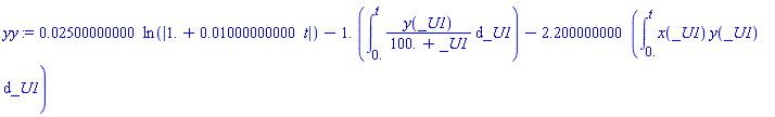

yy := evalc(Re(SOLTT[2]));
0.2500000000e-1*ln(abs(1.+0.1000000000e-1*t))-1.*(int(y(_U1)/(100.+_U1), _U1 = 0. .. t))-2.200000000*(int(x(_U1)*y(_U1), _U1 = 0. .. t))

plot([xx, yy, zz], t = 0 .. 500, legend = [x, y, z]);
Warning, expecting only range variable t in expression -2.200000000*int(x(_U1)*y(_U1),_U1 = 0. .. t)-1.*int(x(_U1)/(100.+_U1),_U1 = 0. .. t)+.5e-1 to be plotted but found names [_U1, x, y]
