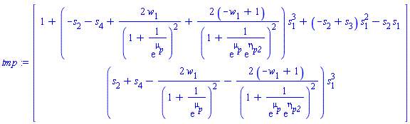

tmp:=Vector(
1+(-s[2]-s[4]+2*w[1]/(1+1/exp(mu[p]))^2+(2*(-w[1]+1))/(1+1/(exp(mu[p])*exp(eta[p2])))^2)*s[1]^3+(-s[2]+s[3])*s[1]^2-s[2]*s[1],
(s[2]+s[4]-2*w[1]/(1+1/exp(mu[p]))^2-(2*(-w[1]+1))/(1+1/(exp(mu[p])*exp(eta[p2])))^2)*s[1]^3
tmp := Vector(2, {(1) = 1+(-s[2]-s[4]+2*w[1]/(1+1/exp(mu[p]))^2+(-2*w[1]+2)/(1+1/(exp(mu[p])*exp(eta[p2])))^2)*s[1]^3+(-s[2]+s[3])*s[1]^2-s[2]*s[1], (2) = (s[2]+s[4]-2*w[1]/(1+1/exp(mu[p]))^2-(-2*w[1]+2)/(1+1/(exp(mu[p])*exp(eta[p2])))^2)*s[1]^3})
rule3:=w[1]/(1+1/exp(mu[p]))^2+(-w[1]+1)/(1+1/(exp(mu[p])*exp(eta[p2])))^2 = s[3];
applyrule(rule3,tmp[1]);
1+(-s[2]-s[4]+2*w[1]/(1+1/exp(mu[p]))^2+2*(-w[1]+1)/(1+1/(exp(mu[p])*exp(eta[p2])))^2)*s[1]^3+(-s[2]+s[3])*s[1]^2-s[2]*s[1]

This is part of a large simplifcation where lots of terms are being substituted. In two of those terms, it did not simplify as we would expect.
I think the main thing is trying to find a way to factor out the "2".
I could do this
>rule3:=2*rule3;
> rule3ne:=-(w[1]/(1+1/exp(mu[p]))^2+(-w[1]+1)/(1+1/(exp(mu[p])*exp(eta[p2])))^2) = -s[3];
> rule3ne:=2*rule3ne;
> applyrule(rule3ne,tmp[2]);
For this example, this works.
But I hope for a more generic approach.
