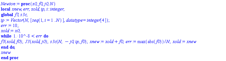

Newton:=proc(x0,f0,j0,N)
global f3,s3c;
local xnew,err,xold,ip,i::integer;
ip:=Vector(N,[seq(1,i=1..N)],datatype=integer[4]);
err:=10;
xold:=x0;
while err>1e-8 do
f3(xold,f0);
J3(xold,j0);
s3c(N,-j0,ip,f0);
xnew:=xold+f0;
err:=max(abs(f0))/N;
xold:=xnew;
end:
xnew;
end proc;
Newton := proc (x0, f0, j0, N) local xnew, err, xold, ip, i::integer; global f3, s3c; ip := Vector(N, [seq(1, i = 1 .. N)], datatype = integer[4]); err := 10; xold := x0; while 0.1e-7 < err do f3(xold, f0); J3(xold, j0); s3c(N, -j0, ip, f0); xnew := xold+f0; err := max(abs(f0))/N; xold := xnew end do; xnew end proc
Compiler:-Compile(Newton);
Error, (in CodeGeneration:-IssueError) cannot analyze non-integer range boundary args[4]
