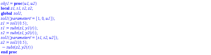

sol1 := dsolve({sys, y1(0) = alpha, y2(0) = beta}, type = numeric, 'parameters' = [alpha, beta, u],maxfun=0,range=0..0.5):
obj1:=proc(u1,u2)
local z1,s1,s2,z2;
global sol1;
sol1('parameters'=[1,0,u1]);
z1 := sol1(.5);
s1:=subs(z1,y1(t));
s2:=subs(z1,y2(t));
sol1('parameters'=[s1,s2,u2]):
z2:=sol1(0.5);
-subs(z2,y2(t));
end proc;
obj1 := proc (u1, u2) local z1, s1, s2, z2; global sol1; sol1('parameters' = [1, 0, u1]); z1 := sol1(.5); s1 := subs(z1, y1(t)); s2 := subs(z1, y2(t)); sol1('parameters' = [s1, s2, u2]); z2 := sol1(.5); -subs(z2, y2(t)) end proc
u0:=[0.8,1.8];
u0 := [.8, 1.8]
obj1(op(u0));
-.552540796143903
Hess1:=Matrix(2,2):for i from 1 to 2 do for j from 1 to 2 do Hess1[i,j]:=fdiff(obj1,[i,j],u0,workprec=1.0);od;od;Hess1;
Matrix(2, 2, {(1, 1) = 115.470000000000, (1, 2) = -1.11000000000000, (2, 1) = -1.11000000000000, (2, 2) = 2.22000000000000})
 Hessian is wrong. It should be noted that when dsolve is called twice inside the objective function there is no error in Hessian calculation with fdiff. The parametric dsolve is efficient, how to get correct answers with that? Another question is how to use fdiff with vector form instead u1,u2 etc to make it generic for any number of variables?

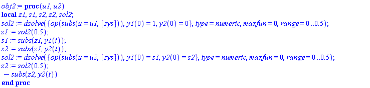

obj2:=proc(u1,u2)
local z1,s1,s2,z2,sol2;
sol2:=dsolve({op(subs(u=u1,[sys])), y1(0) = 1, y2(0) = 0}, type = numeric,maxfun=0,range=0..0.5);
z1 := sol2(.5);
s1:=subs(z1,y1(t));
s2:=subs(z1,y2(t));
sol2:=dsolve({op(subs(u=u2,[sys])), y1(0) = s1, y2(0) = s2}, type = numeric,maxfun=0,range=0..0.5):
z2:=sol2(0.5);
-subs(z2,y2(t));
end proc;
obj2 := proc (u1, u2) local z1, s1, s2, z2, sol2; sol2 := dsolve({op(subs(u = u1, [sys])), y1(0) = 1, y2(0) = 0}, type = numeric, maxfun = 0, range = 0 .. .5); z1 := sol2(.5); s1 := subs(z1, y1(t)); s2 := subs(z1, y2(t)); sol2 := dsolve({op(subs(u = u2, [sys])), y1(0) = s1, y2(0) = s2}, type = numeric, maxfun = 0, range = 0 .. .5); z2 := sol2(.5); -subs(z2, y2(t)) end proc
obj2(op(u0));
-.552540796143903
Hess2:=Matrix(2,2):for i from 1 to 2 do for j from 1 to 2 do Hess2[i,j]:=fdiff(obj2,[i,j],u0,workprec=1.0);od;od;Hess2;
Matrix(2, 2, {(1, 1) = .234295697631809, (1, 2) = 0.101868715004724e-1, (2, 1) = 0.101868715004724e-1, (2, 2) = 0.853480932660994e-1})
 Doing dsolve twice gives correct answer compared to one parametric dsolve even though objective returns the same number (even gradient returns the expected answers).
