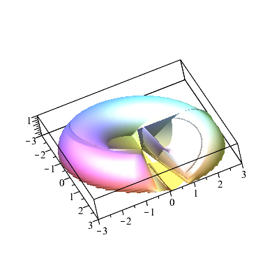

Try this command.
display(semitorus([0, 0, 0], 0 .. Pi, 1, 2), lightmodel = light4, orientation = [-140, 60], scaling = constrained, style = patchnogrid)
I get this mess. The picture on the help page doesn't look any better.Setting the range 0..2 Pi looks fine though. So I think it is a bug.
What I was trying to do is plot 3/4 of a torus i.e circle disk swept in 3/4 of a carcle with capped ends. What is a good way?
