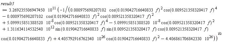

very simply expression,result3,changing with the parameter f,

result3 := 3.269235506947450*10^11*sqrt(-1/(0.975698207102e-3*cos(0.19042716640833e-1*f)^2*cos(0.9521358320417e-2*f)^4-0.975698207102e-3*cos(0.19042716640833e-1*f)^2*cos(0.9521358320417e-2*f)^2+5.099915851388520*10^(-8)*cos(0.9521358320417e-2*f)^4-5.099915851388520*10^(-8)*cos(0.9521358320417e-2*f)^2+1.311634114532540*10^12*sin(0.19042716640833e-1*f)*sin(0.9521358320417e-2*f)*cos(0.9521358320417e-2*f)*cos(0.19042716640833e-1*f)+4.405792916762340*10^26*cos(0.19042716640833e-1*f)^2-4.406861706842330*10^26))

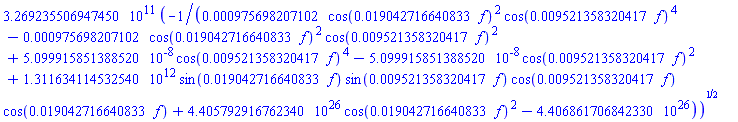

326923550694.745*(-1/(0.975698207102e-3*cos(0.19042716640833e-1*f)^2*cos(0.9521358320417e-2*f)^4-0.975698207102e-3*cos(0.19042716640833e-1*f)^2*cos(0.9521358320417e-2*f)^2+0.509991585138852e-7*cos(0.9521358320417e-2*f)^4-0.509991585138852e-7*cos(0.9521358320417e-2*f)^2+1311634114532.54*sin(0.19042716640833e-1*f)*sin(0.9521358320417e-2*f)*cos(0.9521358320417e-2*f)*cos(0.19042716640833e-1*f)+0.440579291676234e27*cos(0.19042716640833e-1*f)^2-0.440686170684233e27))^(1/2)
