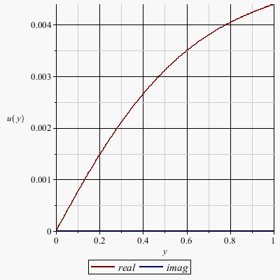

Solve as IVP:
Digits:= 15:
sol:= dsolve({diff(u(y),y) = ODE(A3,y), u(0)=0}, numeric, range=0..1,  output=listprocedure):
plots:-odeplot(
   sol, [[y, Re(u(y))], [y, Im(u(y))]], y= 0..1,
   legend= [real, imag], labels= [y, u(y)]

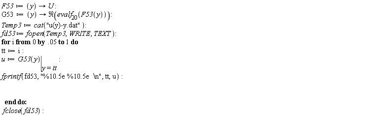

F53 := proc (y) options operator, arrow; U end proc; G53 := proc (y) options operator, arrow; Re(evalf[20](F53(y))) end proc; Temp3 := cat("u(y)-y.dat"); fd53 := fopen(Temp3, WRITE, TEXT); for i from 0 by 0.5e-1 to 1 do tt := i; u := eval(G53(y), y = tt); fprintf(fd53, "%10.5e %10.5e  \n", tt, u) end do; fclose(fd53)
Error, (in fprintf) number expected for floating point format
