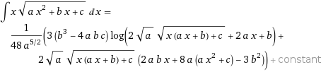

Find the integral of : [x*sqrt(a*x^2+b*x+c) dx]
Maple test:
Wolfram Mathematica test:

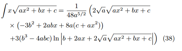

Textbook result:
As you can see the results are much simplified and in reduced form compared to what Maple gives. This has been tested for all integrals with roots and integrals with trigonometry functions. Is there any workaround in Maple that I would use to get it like the textbook result.
