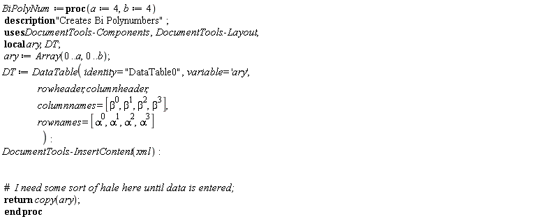

Question: Can a Data Table be used as an input in a procedure?
I am trying to input data via a data table. Have several problems here.
I used an array because I want the row and column numbers to start at 0.
1st When the table appers after that the document runs hediously slow as in a second or two to enter a digit or letters appear after typing.  Like something is absorbing the computer resources. But I have a fast machine.
2nd Any data I  enter to the table vanishes but does get stored.
3rd I tried to turn it all into a procedure but cant get that to work.

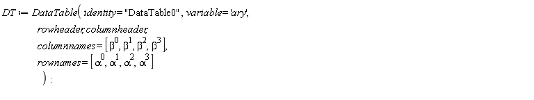

ary := Array(0 .. 3, 0 .. 3)
Array(%id = 18446746457454449478)
DT := DataTable(identity = "DataTable0", variable = 'ary', rowheader, columnheader, columnnames = [beta^0, beta, beta^2, beta^3], rownames = [alpha^0, alpha, alpha^2, alpha^3])
xml := Worksheet(Group(Input(Textfield(DT))))
DocumentTools:-InsertContent(xml)

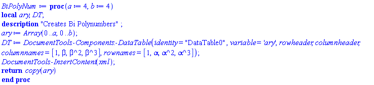

BiPolyNum := proc (a := 4, b := 4) local ary, DT; description "Creates Bi Polynumbers"; ary := Array(0 .. a, 0 .. b); DT := DataTable(identity = "DataTable0", variable = 'ary', rowheader, columnheader, columnnames = [1, beta, beta^2, beta^3], rownames = [1, alpha, alpha^2, alpha^3]); DocumentTools:-InsertContent(xml); return copy(ary) end proc
proc (a := 4, b := 4) local ary, DT; description "Creates Bi Polynumbers"; ary := Array(0 .. a, 0 .. b); DT := DocumentTools:-Components:-DataTable(identity = "DataTable0", variable = 'ary', rowheader, columnheader, columnnames = [1, beta, beta^2, beta^3], rownames = [1, alpha, alpha^2, alpha^3]); DocumentTools:-InsertContent(xml); return copy(ary) end proc
f := BiPolyNum()
