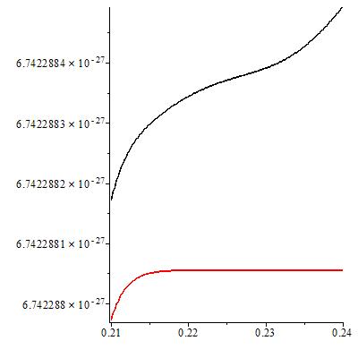

I get "a seemingly correct" result (that means that f increases as xmax intreases), when I try to plot f(xmax) for the following "guessed" options
Digits:=15
integrationmethod:=_d01akc
plot(f,0.21..0.24,color=black)
What is puzzling me is that I get a different "seemingly correct" result, when I modify the integral f by,
at fist, multiplying G by a constant (for example Const:=1e20; G:=Const*exp(c1+c2*x+c3*x7) )
and, second, plotting the f divided by this constant:
plot(f/Const,0.21..0.24,color=red)
The following Figure presents the values of f plotted versus xmax with (red curve) and without (black curve) using of the constant Const:
Dear Primes, could you, please, comment on this difference? Because the only indicator that I have (from the analysis of G, F and K) is that f must be a monotonically (and stricktly) increasing function of xmax.
