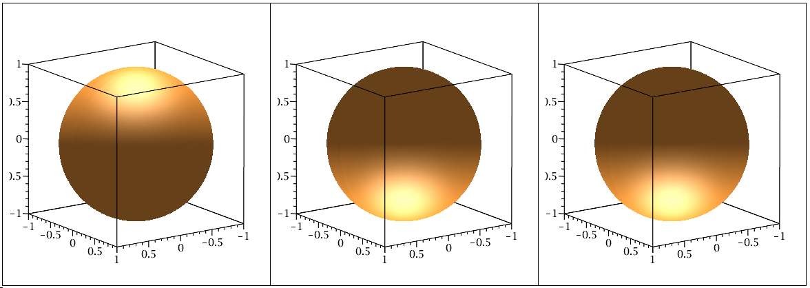

where we render a ball three times by illuminating it
(a) from the north, (b) from the south, and (c) from
both the north and south.  In (c) Maple accounts for only
the south light.
with(plots): with(plottools):
ball := sphere(1, style=surface, color=gold):
display(<
    display(ball,light=[0,0,1,1,1])   |
    display(ball,light=[180,0,1,1,1]) |
    display(ball,light=[0,0,1,1,1], light=[180,0,1,1,1])
