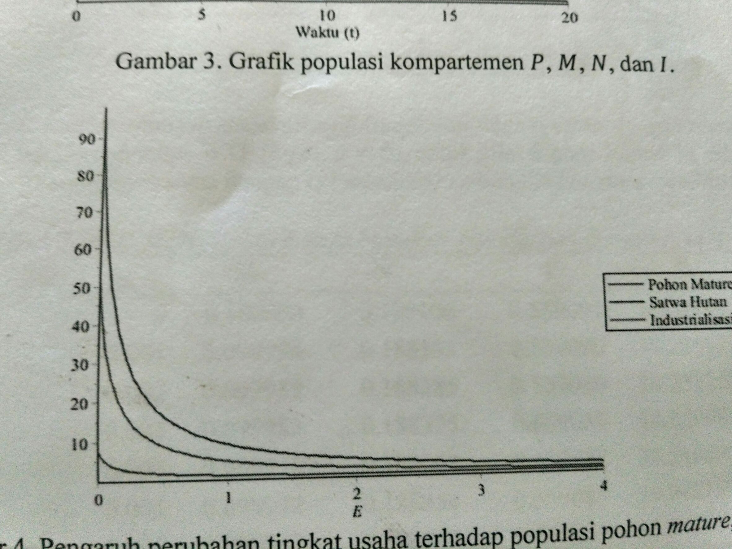

Hi, i want to plot an ode plot with respect to a parameter (E) in range [0,4] instead of time.
I start with unassign variable E and tried to change 't' for 'E' directly, but its give me error
did I use the incorrect syntax/ step?

its work fine if i plot with respect to time (t), but when i tried to change it for a parameter like E its doesnt work
unassign('E');
odeplot(Q, [[E, P(t), color = blue]], E = 0 .. 4, numpoints = 100000, thickness = 2)
Error, (in plots/odeplot) curve is not fully specified in terms of the ODE solution, found additional unknowns {E}
following the output that I expected
