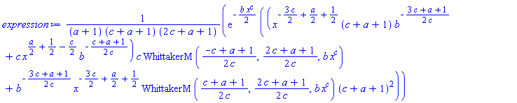

expression:=exp(-b*x^c/2)*((x^(-(3*c)/2 + a/2 + 1/2)*(c + a + 1)*b^(-(3*c + a + 1)/(2*c)) + c*x^(a/2 + 1/2 - c/2)*b^(-(c + a + 1)/(2*c)))*c*WhittakerM((-c + a + 1)/(2*c), (2*c + a + 1)/(2*c), b*x^c) + b^(-(3*c + a + 1)/(2*c))*x^(-(3*c)/2 + a/2 + 1/2)*WhittakerM((c + a + 1)/(2*c), (2*c + a + 1)/(2*c), b*x^c)*(c + a + 1)^2)/((a + 1)*(c + a + 1)*(2*c + a + 1));
exp(-(1/2)*b*x^c)*((x^(-(3/2)*c+(1/2)*a+1/2)*(c+a+1)*b^(-(1/2)*(3*c+a+1)/c)+c*x^((1/2)*a+1/2-(1/2)*c)*b^(-(1/2)*(c+a+1)/c))*c*WhittakerM((1/2)*(-c+a+1)/c, (1/2)*(2*c+a+1)/c, b*x^c)+b^(-(1/2)*(3*c+a+1)/c)*x^(-(3/2)*c+(1/2)*a+1/2)*WhittakerM((1/2)*(c+a+1)/c, (1/2)*(2*c+a+1)/c, b*x^c)*(c+a+1)^2)/((a+1)*(c+a+1)*(2*c+a+1))

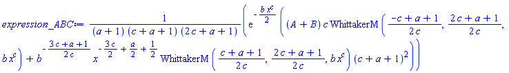

expression_ABC:=eval(expression,[x^(-(3*c)/2 + a/2 + 1/2)*(c + a + 1)*b^(-(3*c + a + 1)/(2*c))=A,c*x^(a/2 + 1/2 - c/2)*b^(-(c + a + 1)/(2*c))=B,((a + 1)*(c + a + 1)*(2*c + a + 1))=C]);
exp(-(1/2)*b*x^c)*((A+B)*c*WhittakerM((1/2)*(-c+a+1)/c, (1/2)*(2*c+a+1)/c, b*x^c)+b^(-(1/2)*(3*c+a+1)/c)*x^(-(3/2)*c+(1/2)*a+1/2)*WhittakerM((1/2)*(c+a+1)/c, (1/2)*(2*c+a+1)/c, b*x^c)*(c+a+1)^2)/((a+1)*(c+a+1)*(2*c+a+1))
