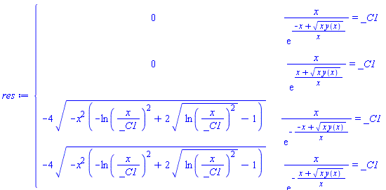

But there are cases when odetest returns odetest/PIECEWISE` where some cases are zero and some are not.  Example is below.
For this, I still want to consider my solution as valid if one of the cases in piecwise is zero. But I am not sure what is a robust way to do this in code. Currently, I do the following

In the above, the check  type(res,'function')  is meant to catch PIECEWISE  return, since when I did type(res) Maple told me the type is function.
But I am not sure if this is a robust way to check for this, as it might be possible maple will return non zero, and also a function, but it will not be what I think it is (i.e. PIECEWISE) and then I would flag my solution as valid when it is not.

`odetest/PIECEWISE`([0, x/exp((-x+(x*y(x))^(1/2))/x) = _C1], [0, x/exp((x+(x*y(x))^(1/2))/x) = _C1], [-4*(-x^2*(-ln(x/_C1)^2+2*(ln(x/_C1)^2)^(1/2)-1))^(1/2), x/exp(-(-x+(x*y(x))^(1/2))/x) = _C1], [-4*(-x^2*(-ln(x/_C1)^2+2*(ln(x/_C1)^2)^(1/2)-1))^(1/2), x/exp(-(x+(x*y(x))^(1/2))/x) = _C1])
"verified"
