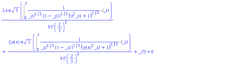

convert(hand_solution,Int); #Why this did not give same result as ABOVE?
x*hypergeom([1/3, 2/3], [4/3], -x^3)+y(x)*hypergeom([1/3, 2/3], [4/3], -y(x)^3)+_C1 = 0
(2/9)*x*Pi*3^(1/2)*(Int(1/(_t1^(1/3)*(1-_t1)^(1/3)*(x^3*_t1+1)^(1/3)), _t1 = 0 .. 1))/GAMMA(2/3)^3+(2/9)*y(x)*Pi*3^(1/2)*(Int(1/(_t1^(1/3)*(1-_t1)^(1/3)*(y(x)^3*_t1+1)^(1/3)), _t1 = 0 .. 1))/GAMMA(2/3)^3+_C1 = 0

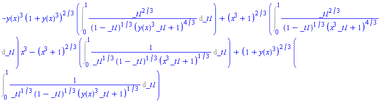

odetest(%,ode); #does not give zero
-y(x)^3*(1+y(x)^3)^(2/3)*(Int(_t1^(2/3)/((1-_t1)^(1/3)*(y(x)^3*_t1+1)^(4/3)), _t1 = 0 .. 1))+(x^3+1)^(2/3)*(Int(_t1^(2/3)/((1-_t1)^(1/3)*(x^3*_t1+1)^(4/3)), _t1 = 0 .. 1))*x^3-(x^3+1)^(2/3)*(Int(1/(_t1^(1/3)*(1-_t1)^(1/3)*(x^3*_t1+1)^(1/3)), _t1 = 0 .. 1))+(1+y(x)^3)^(2/3)*(Int(1/(_t1^(1/3)*(1-_t1)^(1/3)*(y(x)^3*_t1+1)^(1/3)), _t1 = 0 .. 1))
