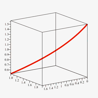

We plot the boundary data on the domain's outer arc:
p1 := plots:-spacecurve([b*cos(t), b*sin(t), t], t=c..d, color=red, thickness=5);

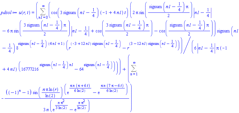

Solve the PDE:
pdsol := pdsolve({pde, bc});
u(r, t) = Sum((1/6)*cos(3*signum(n1-1/4)*(-1+4*n1)*t)*(2*Pi*sin((1/2)*signum(n1-1/4)*Pi)*abs(n1-1/4)-6*Pi*sin((3/2)*signum(n1-1/4)*Pi)*abs(n1-1/4)+cos((3/2)*signum(n1-1/4)*Pi)-cos((1/2)*signum(n1-1/4)*Pi))*signum(n1-1/4)*8^(signum(n1-1/4)*(4*n1+1))*(r^((-3+12*n1)*signum(n1-1/4))-r^((3-12*n1)*signum(n1-1/4)))/(abs(n1-1/4)*Pi*(-1+4*n1)*(16777216^(signum(n1-1/4)*n1)-64^signum(n1-1/4))), n1 = 0 .. infinity)+Sum(-(1/3)*((-1)^n-1)*sin(n*Pi*ln(r)/ln(2))*(exp((1/6)*Pi*n*(Pi+6*t)/ln(2))-exp((1/6)*Pi*n*(7*Pi-6*t)/ln(2)))/(n*(exp((1/3)*n*Pi^2/ln(2))-exp(n*Pi^2/ln(2)))), n = 1 .. infinity)

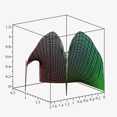

Truncate the infinite sum at 20 terms, and plot the result:
eval(rhs(pdsol), infinity=20):
value(%):
p2 := plot3d([r*cos(t), r*sin(t), %], r=a..b, t=c..d);

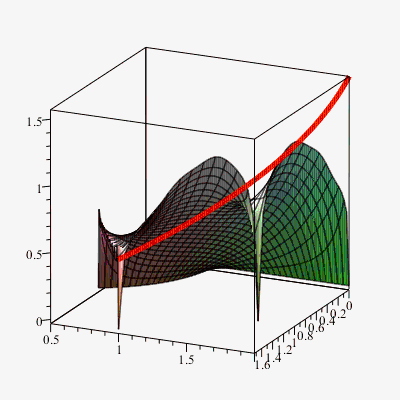

Here is the combined plot of the solution and the boundary condition.
We see that the proposed solution completely misses the boundary condition.
plots:-display([p1,p2], orientation=[25,72,0]);
