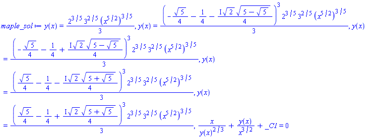

But in its original form, Maple dsolve gives 6 complicated looking solutions with complex numbers in some of them. Even though all 6 solutions are valid.
Any one knows why Maple did that and not give the one simple solution instead?

maple_sol:=dsolve(ode);
y(x) = (1/3)*2^(3/5)*3^(2/5)*(x^(5/2))^(3/5), y(x) = (1/3)*(-(1/4)*5^(1/2)-1/4-((1/4)*I)*2^(1/2)*(5-5^(1/2))^(1/2))^3*2^(3/5)*3^(2/5)*(x^(5/2))^(3/5), y(x) = (1/3)*(-(1/4)*5^(1/2)-1/4+((1/4)*I)*2^(1/2)*(5-5^(1/2))^(1/2))^3*2^(3/5)*3^(2/5)*(x^(5/2))^(3/5), y(x) = (1/3)*((1/4)*5^(1/2)-1/4-((1/4)*I)*2^(1/2)*(5+5^(1/2))^(1/2))^3*2^(3/5)*3^(2/5)*(x^(5/2))^(3/5), y(x) = (1/3)*((1/4)*5^(1/2)-1/4+((1/4)*I)*2^(1/2)*(5+5^(1/2))^(1/2))^3*2^(3/5)*3^(2/5)*(x^(5/2))^(3/5), x/y(x)^(2/3)+y(x)/x^(3/2)+_C1 = 0
map(x->odetest(x,ode),[maple_sol])
[0, 0, 0, 0, 0, 0]
